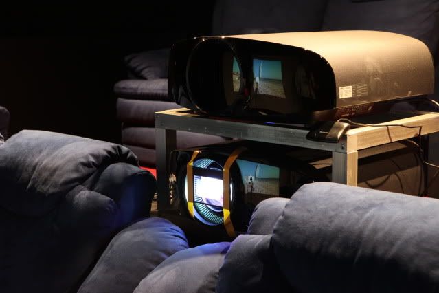

robert i dont know now the exact price for a lamp for the sony vw 1000 but i am almost sure it will be by far less expensive than a sony qualia or a
christie hd 6k lamp replacement.
so if you change the lamp very early after 30-35% drop and not wait till the lamp is dead you can keep the light out very high.
lets guess the lamp price is in the 650 euro range and lets guess in
high lampe mode it can run 700 hours till the drop was 35% than your lamp cost is less one euro per hour.
your lamp inside your pr. the cost per hour is more i guess.

A-lens use could be problematic as the air intake is around the lense?

Originally Posted by W.Mayer View Post
to bad the lens cover from the pr. makes it not possible to let the lens all the time at this place as I need to go very close to the projector lens ...
I wonder if there is a reasonable way to disable the lens cover (even if Sony doesn't specifically support it).

2 things.
first it is depends on the diameter the lens have and scound it it depends
on how much you shift it inside to the sony vw 1000 lens.
in my picture its i think enough space so the sony can take his air.
please note that the isco3 is a very big lens and there are other smaller versions out.
