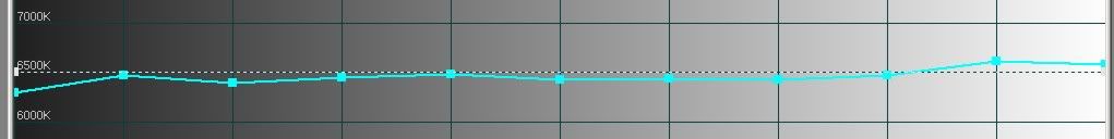

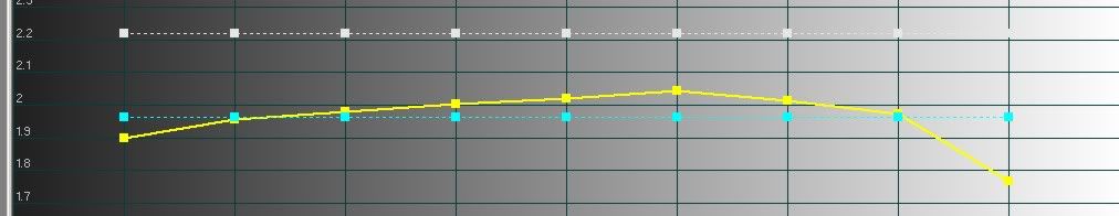

Waiting for a new red filter to maximize the pro8200 black levels, so here's a bright calibration for tv watching.
You should adjust the brightness, contrast, saturation and gamma to suit your taste and room conditions. It looks pretty good on my screen. Use eco to reduce luminance.

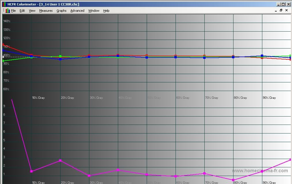

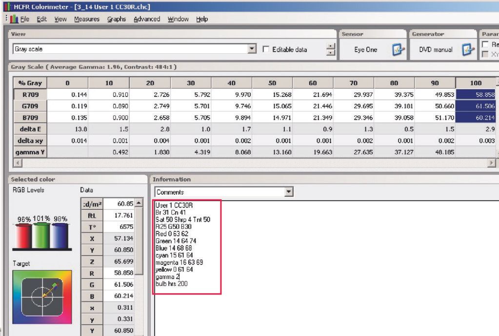

OK, here are some settings for using a CC30R filter.
The object of this is to reduce the amount of light reaching the screen with an added benefit of improving black level.
This is not a good idea to use if you're using the projector in a situation with ambient light. In my case, the room is completely light controlled, and the walls and ceilings at the screen are painted near black.
To improve the black levels before using this filter, I would:
1. control ambient light
2. paint the walls and ceilings a dark neutral color
3. control the light leakage from the projector's louvered openings (I hung black cloth near those openings to absorb the light.
The CC filter (or a ND filter) is reducing the light leakage from the lens reaching the screen by reducing the total amount of light. In the case of the CC filter, it is reducing the green and blue light while passing red, while a ND filter reduces the light equally.
Anyway, I'm no expert on this, but I do like the results and it seems like the blacks are closer to black. I would try and take some pictures of the results, but taking a photograph of black is an exercise in futility.
The colors are very vivid, but then the projector throws a nice bright image as it is. These settings are using User 1 mode. I'll post the dark room settings later.
[IMG][/IMG]
[IMG][/IMG]
[IMG]
[/IMG]
The gamma isn't exactly smooth. You might try the gamma 3 setting.
[IMG][/IMG]
The color temperature is pretty smooth across IRE levels. It's a little on the warm side, and you could tweak that by increasing blue one or decreasing green 1.
[IMG][/IMG]
If anyone tries this, please let me know what you think, including if you think it doesn't help. Some of this gets pretty subjective.
