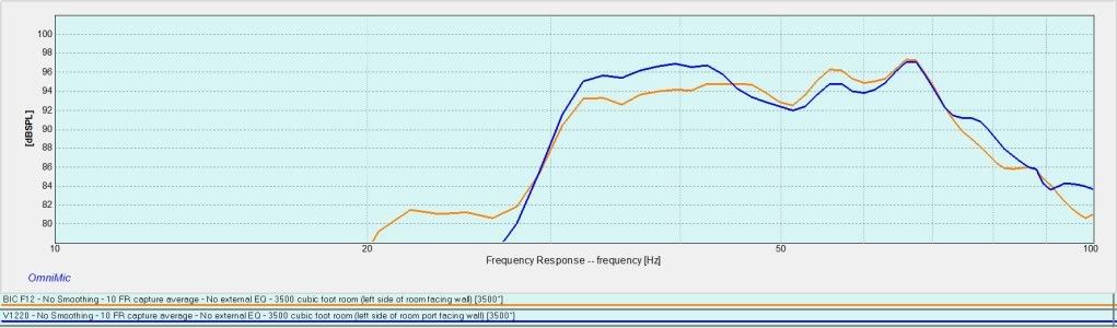

A friend of mine purchased 3 BIC subwoofers, a F12 about a year ago, and a pair of V1220's recently in the crazy low priced $97 each walmart.com deal. The subs were picked up tonight from the local wal-mart and we set them up in my room and proceeded to take some frequency response graphs.
This is kind of a sister project to the recent thread where I measured a pair of Klipsch RW-12D
http://www.avsforum.com/avs-vb/showthread.php?t=1390563
For this set of measurements - everything was setup the exact same in the as for the Klipsch tests. I turned off all external EQ in my Onkyo TX-NR 1007 receiver (no Audyssey, no Dynamic EQ, mains crossover set to 100hz, sub LFE set to 120hz) and just measured:
1) the BIC F12 by itself
2) a single BIC V1220 by itself
3) a pair of BIC V1220 subs
4) a F12 and a V1220 together
5) and finally all three subs together.
These frequency response graphs were captured in my 3500 cubic foot room using Omnimic. Distance calibrations in the receiver were accurately set. The frequency response graphs were all taken with no smoothing but averaged over 10 captures each from my main listening position. Here are some pictures of my room to get an idea of the setup.
http://s1191.photobucket.com/albums/...20Room%202011/
The sub placement for these measurements is as follows:
1) F12 - Left side of projector screen with driver facing outside wall
2) V1220 - Left side of projector screen with driver facing down (standard config) and port facing outside wall
3) Dual V1220 - Both on outside of projector screen with ports facing outside walls
4) F12 on left side as in configuration 1 and V1220 on right side as in config 3
5) Dual V1220 as in config 3 sharing y split single sub1 output and F12 near center for room with driver facing forward on sub 2 output.
The placement chosen is the best/flattest position I've found in my room for duals.
Note: SPL interval is 2dB on every chart except the last one. (5dB intervals on Y axis is more common and makes the frequency response look flatter, but is harder to determine actual differences with precision)
BIC F12
BIC V1220
single BIC F12 vs. single BIC V1220 - Frequency responses compared
BIC V1220 pair
single BIC F12 and single BIC V1220
BIC F12 and BIC V1220 pair
BIC V1220 pair vs. Klipsch RW-12D pair
BIC V1220 pair vs. Klipsch RW-12D pair with more common 5dB y axis spacing

After having them for one night, I'm not totally sold that I like the v1220s more than the single F12. There are definately some sound quality differences, atleast in my room. The two v1220s are most definately louder, as in my couch was shaking with it at -35 db on the onkyo (where as I usually watch movies at -10 or -5 depending on the quality of the sound)...that being said, i was just playing around and the final set up will have the subs turned WAY down from that.
Archaea and I will eventually do similar graphs from my room as well as in the room of the owner of the Klipsch for comparisons.

Shows clearly why my system (Polk MonitorII 60s L&R/CS20 Center/F12 sub) set at 80hz crossover sounds better than when I tested at 100hz crossover.

Archaea and I did some more playing with the omni mic and positioning. Here are the results. These graphs are all taken at the same volume with no smoothing and the sub placements are not ideal. The F12 is placed in front of the couch between seating positions 1 and 2. Position one is the center of the couch, position 2 is to the left of the couch and next to the wall, Position 3 is to the right side of the couch and away from the wall. As you can see in the graph, the blue lines are the V1220s and the F12 while the red is just the v1220s. We found what we thought to be the best placement for the v1220s and then I moved the F12 around to see if it would help, and as you see in the graphs, I think it did help a little in flattening out the line.
After listening to some movie clips and some music, it sounds drastically different. I'm hearing notes I didn't really hear before. There was a large lag at about 60 hz prior to moving stuff around and some songs sound a lot different with out that lull. Also, I am almost sure that I hear some sounds I didn't hear prior when watching the movie clips on the demo disc. I do believe I can specifically point out some sounds in the book of eli gun fight at the house. Also the THX clip sounds a lot smoother. So far I'm happy with the sound of this set up, but maybe not the positioning. I might play with re-arranging furniture, but I have a 3 piece sectional couch that is very very very large and if I turn it the other direction I'd only have about 6 inches between the wall and the couch thus making it difficult to get in to the area without climbing.
