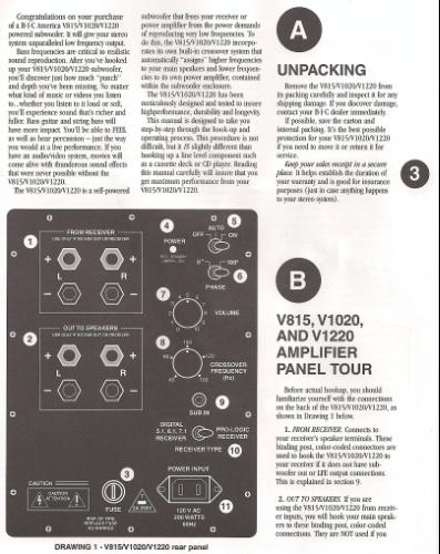

Took a look at the bic and that seems to be almost exactly what I'm looking for, but before I get too far, I'm using a 2 channel t-amp to power my speakers, and i know the sub has its own power but where would the input come from since I'm using both channels on the amp and there is no rca pre amp output. Sorry if there is an obvious answer and I'm being stupid
Edit: thinking it passes through the sub first then goes to the speakers?
post #17 of 18
Speaker wire would go from the T-amp to the Subwoofer Plate Amps "From Receiver" speaker level inputs. Then you would run speaker wire from plate amp "To Speakers" speaker output to the speakers.
Thats is why I recommended that subwoofer as it will work with your T-amp easily
post #18 of 18
Thanks a lot very good suggestion . So at this point I'm thinking I'm pretty much sold on that bic sub as it fits my price range perfectly, appears to be very good quality for the price and will work seamlessly with my current set up
