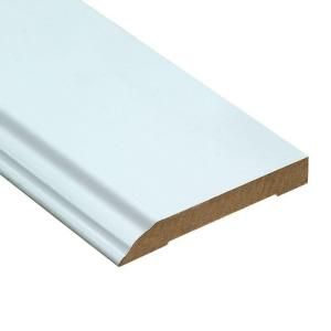

post #18 of 63
thanks MM.
what do you typically use for trim pieces? 1x3 poplar? which is actually 0.75"x2.5"
post #19 of 63
I think the thin MDF moulding is the preferred trim. Cheap, thin and easy to work with.

do you have the exact type/size of this MDF moulding? perhaps a link?
i can't seem to find the right one when i was at Homedepot.
Here is a closely similar picture of the Trim:
.......but if you'll look closely at the examples in this Thread:
http://www.avsforum.com/avs-vb/showt...=865218&page=2
in my tutorial (3.25") does not have a double outside curve that the 3.75" Trim seen in the 1st image.
I would think that if you simply ask someone in Lumber to help you locate the "3.25" x 5/8" MDF Base Board Trim", you'd get steered to it pretty quickly.
Edit: OK, I found the exact info you need:
MDF "Base" Trim. (3.25" wide x 5/8"" thin)
Home Depo Store SKU # 526895

post #25 of 63
thanks MM. i'll ask someone in lumber for that specific MDF next time i go to HD.
though i think 3.25" might be a bit too wide for my screen (48x82).
hopefully they'll have something similar in the 2"-2.5" range.
