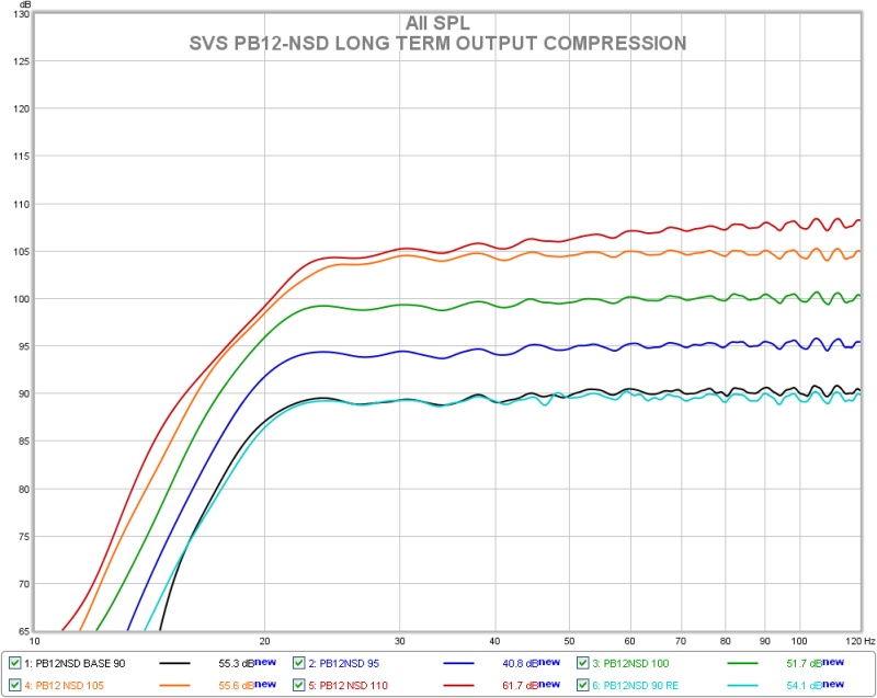

I am late to the party, but here is the comparison for everyone to see:

Looking at the basic CEA2010 results, from 20Hz to 125Hz, the PB12 averages 107dB of output and 6.4% THD+N. With 2 ports open, the EX manages averages of 110.9dB and 13.13% THD+N. With 1 port open, the EX manages 109.9dB and 14.3% THD+N.
Looking at the maximum drive sine sweeps vs distortion, you see a similar pattern: in its maximum sweep (110dB level), the PB12 sees a maximum distortion level of a tad over 10% from 20Hz to 125Hz right around 25Hz. The EX with 1 port open peaks over 20% around the same spot in its 110dB sweep; with both ports open, distortion goes off the chart as the EX approaches 20Hz on the 113dB sweep, and exceeds 25% at 20Hz on the 110dB sweep.
Of course, if you look at the lower drive levels, ie the 105dB and 100dB marks, the PB12 performs quite well versus the EX. In the 105dB drive test, the PB12 stays under 5%THD from 20Hz to 125Hz. The EX cannot manage that little feat under either mode (1 port or 2 ports open) on the 100dB sweep!
Are those numbers valid for the new PB12-NSD? They look different from anything I've seen recently.
post #44 of 163
They are valid for that given environment. Remember that room/environment as well as equipment used plays a huge role. You could take that very sub and run a test again in another room with different equipment and get all new numbers.
post #45 of 163
Actually, those are CEA-2010 standard measurements which represent a ground plane/anechoic measurement. So if you factor in room gain they'll perform better than that. CEA-2010 is the "new" standardized measurement system that Ilkka, Audioholics and Josh Ricci have been using. It's a true apples to apples comparison. And yes, the numbers are extremely valid; some of the only valid ones around IMO.
You can see more measurements on the data-bass website as well as Audioholics (the latter has performed an in-depth review on many of those subwoofers including the SVS PB12-NSD).

Originally Posted by cel4145 View Post
You can read and study those graphs, the ones for the PB12-NSD and the EX, and still be no better off at making a decision. It's very close.
I will say this about the VTF-3.4. I think the sealed sub mode is mostly gimmick, in that if someone wants a sealed sub, then buy one that was specifically designed to be a sealed sub. For most people it will be an unused option. And I suspect that the Q tuning it not super useful unless one is taking sophisticated measurements with a mic and REW or maybe through using the SMS-1 sub EQ. Otherwise, it will be mostly guess as to how to tune it that finely.
If I had to pick between the VTF-3.4 and the PB12-NSD, I'd probably go with the PB12-NSD for the lower distortion below 30hz.
Actually the numbers you posted are for the sine sweep. The tab to the left is marked "CEA2010 Output Results".

Originally Posted by oztech View Post
Is their a link showing the distortion curious because in room if its there can't really tell.
PB12-NSD CEA 2010 Output vs Distortion, 2m RMS
http://www.audioholics.com/reviews/s...iew_fullscreen
PB12-NSD Sine Sweep
PB12-NSD THD vs output from sine sweep
EX 1 port open, CEA 2010 Output vs Distortion, 2m RMS
http://www.data-bass.com/images/meas...ART%20PASS.png
EX 1 port open Sine Sweep
http://www.data-bass.com/images/meas...ompression.jpg
EX 1 port open THD vs output from sine sweep
http://www.data-bass.com/images/meas...HD%20GRAPH.png
EX 2 port open , CEA 2010 Output vs Distortion, 2m RMS
EX 2 port open Sine Sweep
EX 2 port open THD vs output from sine sweep
