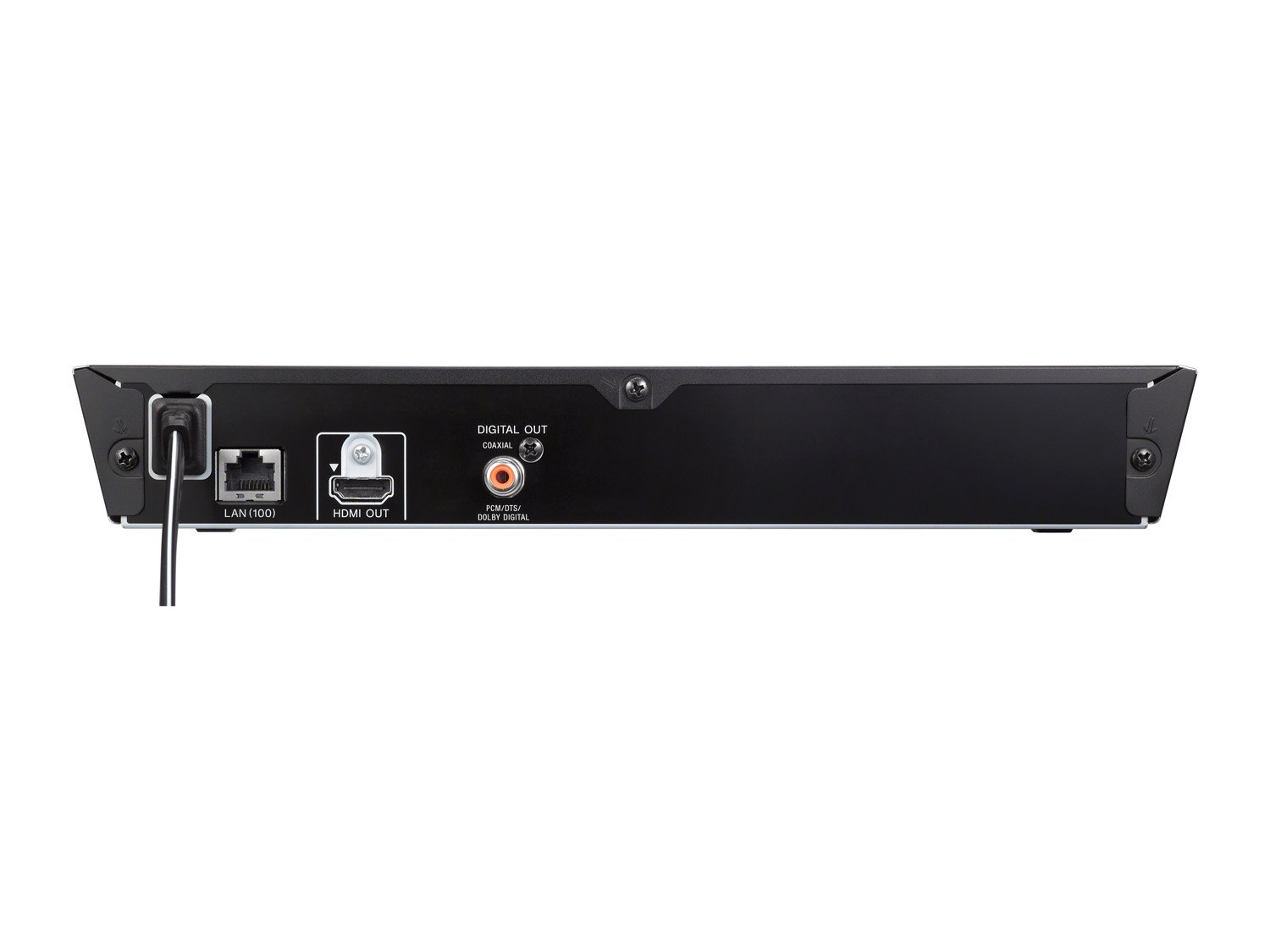

Originally Posted by michaeltscott View Post
Here's a picture of it:
Removing all analog outs really cleans up the back panel biggrin.gif! I can't find a picture of the back of the 2013 Panasonics--it's like they think that the lack of analog connections will scare people rolleyes.gif.
The phasing out of the analog outputs concerns me for the reason that that is what I use to output audio to some of my devices such as my cordless headphones and my bluetooth hearing aid streamer. These devices will only accept analog and I cannot patch in a digital audio signal to my avr and then output analog to the wireless headphones.
post #3048 of 3554
There are plenty of coax/optical to analog converter out there. The elimination of analog outputs is one thing you have to live with. I only wish all those new AVRs don't come with any analog inputs on them either. That could save a lot of space on the back panel and costs as well because I never use them.
