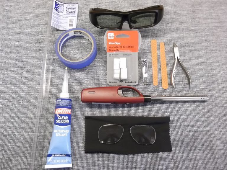

What I used: Miller Nail On Corner Guard and Gardner Bender GWC-1510 Wire Clips (stick-on), both from Ace hardware; clear silicone sealant; blue masking tape; manicure tools to cut and trim the corner guard; a lighter to heat the corner guard for bending; Epson 3D glasses; two prescription lenses.
Since this was just an experiment, I used some lenses from an old pair of glasses. Otherwise I would have used the ones from Eyeglass Direct (more about this at the end) that I used when I made my permanent prescription 3D glasses.

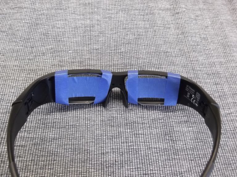

The lenses should fit inside the slightly depressed area on the back of the 3D glasses. File the top and bottom of the lenses until they fit properly. Cover the lens with tape leaving about 3/16 exposed at the top. Tape the lenses to the frame.

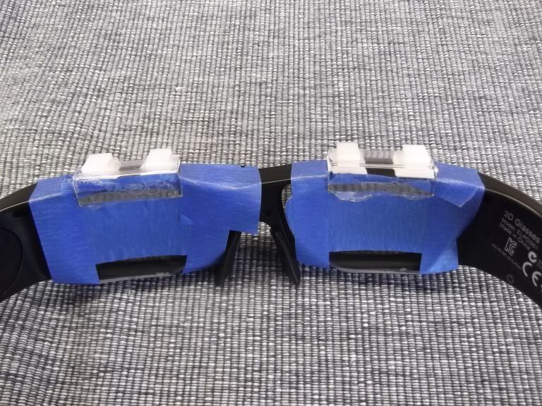

Stick the wire clips to the frame with the opening to the rear. Cut small pieces of the corner guard and trim to fit into the wire clips and at the same time to cover the bare portions of the lenses. You might have to heat and bend the corner guard to get a good fit.
Cover everything that you don't want to get silicone on with tape. Apply silicone sealant to the bare portion of the lenses. Slide the corner guard pieces into the clips and press into the silicone coated portion of the lenses squeezing out most of the silicone.

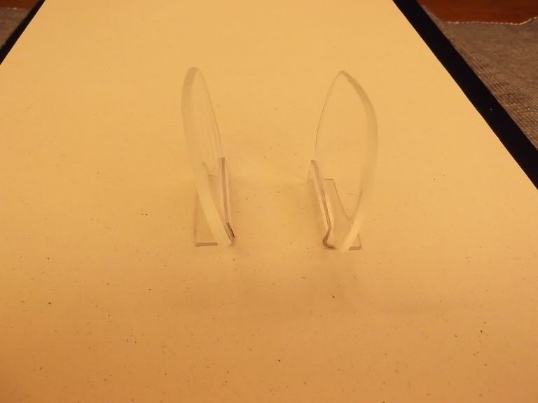

Remove all of the tape while removing the lenses from the clips and you should have two lenses ready to clean up.

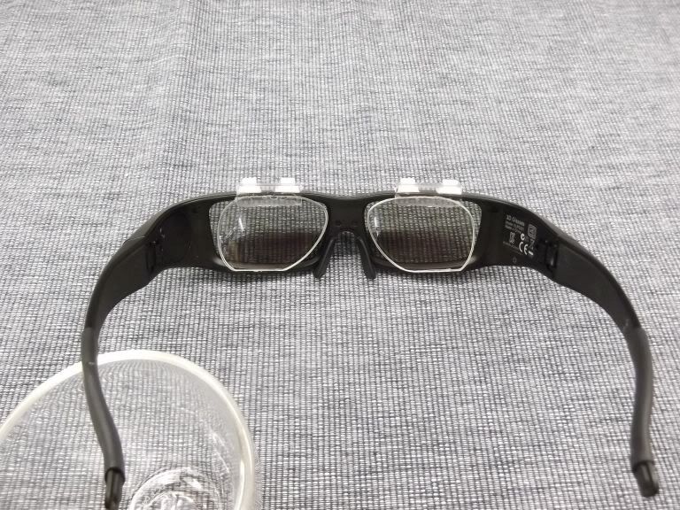

Slide them back into the clips and you have instant prescription 3D glasses with removable/exchangeable lenses.
Since, as I sad before, this was just an experiment (I'm not going to use these), I didn't take a lot of care when I did this. With more care, they would probably look a lot better. For instance, if the wire clips were glued to the 3D glasses rather than using the applied double stick foam tape, they would be less obtrusive.
