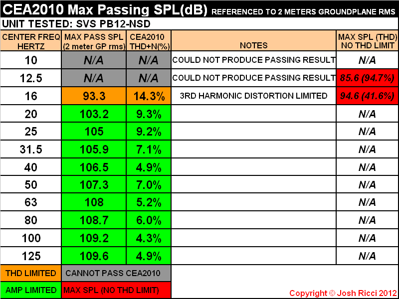

I have a PB12-NSD.
I am considering my choice for a future upgrade and I am looking at the PB12 Plus and PB13 Ultra.
I read the reviews on all 3 on the Audioholic website but have a question about their graphs.
PB12-NSD :
PB12-Plus Scroll down to the CEA readings
http://www.audioholics.com/reviews/s...2-measurements
PB13-Ultra
http://www.audioholics.com/reviews/s...iew_fullscreen
What I gather from this is that the Ultra is obviously louder than the PB12-NSD and only a slight amount louder than the PB12-Plus (probably not even really noticeably louder, I may be wrong). Am I correct with this assumption?
If that's it, I just can't fathom why the PB12-Plus is about $600,- more and the PB13 around $1200,-. The Plus has a driver the same size as the NSD.
I for example want a bigger sub soon because I want to feel the bass more and the rumble. How is it even remotely viable to spend nearly double the money on a Subwoofer that is marginally louder and has the same size driver (PB12-Plus) or 1 inch larger (Ultra).
How is it even possible to produce power POWERFUL base and not just louder base.
What I am trying to find out is if A) I understand the graphs correctly and B) If I am correct with my assumption that a same size driver can't possibly make that much of a difference in output.

If you dont think 3db is noticeably louder then you may be deaf
Whats your current sub... get two PB12NSD and then put them in different corners of the room. Dont just buy one big sub and expect it to sound great no matter where you sit (it wont)

Ok, fine. 3 db is noticeably louder, but at what volume level? Is that at 0 Decibels (reference level)?
I understand that everyone priorities are different and certain amounts of money matter differently to different people, but all these things aside, if $600,- buys you 3 db more, that would be quiet funny.
Ray
EDIT: Omega, just saw you edited your post a bit. My concern is that I would want a sub that pumps more air and hits harder. I can't imagine that a PB12-Plus or even a PB13 Ultra can be worth that much money more for just being louder alone. The drivers are all about the same size with the 13 being an inch bigger. At the end of the day, a driver can only pump as much as its physically capable, no?
On the other hand, I used to have BIC F12 which also has a 12 inch driver and my PB12-NSD is destroying the BIC in terms of output. I don't see what can possibly make such a difference in driver quality. They both have their physical limitations of being 12 inch subs.

Doubling cone area and keeping power levels the same gets you 3db
doubling power and doubling cone area gets you 6db
You can read this forum and gather a lot of info, or maybe the DIY forum
My advice is not to buy SVS at all, buy two rythmik FV15HP and you will probably never need to buy a sub again

Don't forget, the PB12-nsd and ultra were tested by Josh Ricci and the PB12-plus was tested by Paul Apollino. They tested with different equipment at different locations so their results could be different by a couple of db. I would probably just assume the PB12-plus is between the results of the nsd and ultra, measured by Ricci. Whether or not the performance difference is worth it is a personal decision. Remember, while a 3db increase may not seem like a lot, it is not easy to accomplish. Doubling amp power results in a max increase of 3db and an increase of 3db requires twice the cone excursion.
Just because two drivers are the same diameter, does not mean their performance will be anywhere near the same. Just look at the pictures and description on the SVS site of the nsd and plus drivers. The plus driver has a larger motor, voice coil, dual spiders and more excursion. All of that can result in large difference in performance. The ultra driver is not only larger in diameter, but also has a more linear motor, better voice coil and probably more excursion.

The Plus and Ultra also use more advanced amplifier electronics than the NSD, and they have variable tuning modes that allow them to descend comfortably to much deeper extension (per AH measurements, in 15Hz mode, the PB13-Ultra can push almost 90dB at 12.5Hz, outdoors). Their drivers are also simply *better* than the NSD, so their sound quality is likely notably better (they produce less harmonic distortion and exhibit substantially less group delay, two easily measured values that directly relate to the quality of a subwoofer's sound). In other words, output isn't everything. If I had money to burn, I'd definitely trade my PC12-NSD up to the PC12-Plus to get the deeper extension, output control features and better driver; I wouldn't be inclined to run it any louder, though.
Moreover, in the links you added to the original post, the PB13-Ultra's numbers in 15Hz mode are being compared to the PB12-Plus' 20Hz mode. The proper comparison between the two subs is when they are in matching modes, 15Hz vs 15Hz, and 20Hz vs 20Hz. Audioholics' PB12-Plus review didn't include any mode other than 20Hz mode, so here's the fairer comparison:
PB12-Plus in 20Hz mode (you want to see the "RMS @ 2 meter" column)
PB13-Ultra in 20Hz mode
In the challenging places of the spectrum (everywhere under 40Hz) the Ultra is at least 3dB louder. Yes, that's a highly audible and tangible difference at these output levels.
It's also worth noting, as others have, that the enclosure itself and larger driver assembly add significantly to the costs of both manufacture and shipment. Personally, I prefer the cylinder versions of all the SVSound subs--comparing price to performance, in my opinion they offer a better value, and I can move them without having to radio for backup.

Something to keep in mind is that the dB scale is logarithmic in nature, not linear. If you purchase a second PB12-NSD and stack it on top of your first, theoretically you'll yield an additional 6dB of output. If you purchase an additional two more PB12-NSDs on top of that, you'll yield another 6dB of output.
Consequently, if you purchase a PB13U, in 20Hz tune you'll get ~8dB more output on average from 20Hz to 125Hz than you would with your NSD. That is about 1dB less than if you had a stack of 3 PB12-NSDs.
If you consider things from that perspective, the pricing starts to make a lot of sense. The PB13U is a bit shy of triple the price of three PB12NSDs, and a bit shy of triple the output as well. As an added bonus, you get a few added features (tuning options, more advanced amplifier) and a nicer cabinet. Not a bad deal all things considered.

Loud = the amount of Bass? Sorry that this may sound stupid but I never thought that was the case. My old BIC F12 would get VERY loud too, to the point where Audyssey kept throttling it down but in no way shape or form would it shake the room like the PB12-NSD is doing right now. I don't think loudness = pressure power/rumble/ or w/e you'd call this.
There's output (volume) and there's extension (depth/rumble). Your PB12-NSD is no slouch in either department, but the PB13U offers more of both. Of course keep in mind, while the PB13U digs deeper than a PB12-NSD, not all source material calls for extension down to 15Hz, especially when it comes to music.

Woah, thanks for the input.
My SUb will soon be placed into the Basement. The Basement is about 4000 - 4500 cf. So rather large. Has doors that lead into smaller rooms that have our boilers etc in it. The room is tiled and no room treatment at all except the little corner I'll be using for my home theater. That part has a thing carpet laying there.
So yea, 1 PB12-NSD will have a hard time giving me the wow factor. Question is whether I get more rumble and thunder from 1 PB12-Plus or Ultra or 2x PB12-NSD's.
Ray
I agree with ack_bk: Call SVS and discuss your situation with them. A second NSD will certainly give you more headroom and rumble (more envelopment too), but the PB12-PLUS or PB13-ULTRA will most definitely give you that extra punch and shaking that you're looking for. The Rythmik FV15HP is also something you should consider.
