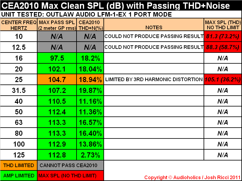

Looking at the 100dB long term sine curve, the PB12 is +0.5dB/-4.0dB from 20Hz all the way up to 125Hz. It maintains this level of performance with under 3% THD across the aforementioned bandwidth. And make no mistake, 100dB at 2 meters ground plane is loud by most standards. In my listening environment (corner loaded, listening position 9 feet away), that's 109.2dB at the listening position, comparable to a peak of -5.8dB from reference on the LFE channel (115dB) or -14dB if all channels are summed to the subwoofer (123.2dB).
Conversely the Outlaw in one port mode:
http://www.data-bass.com/images/meas...ompression.jpg
http://www.data-bass.com/images/meas...HD%20GRAPH.png
The curve is comparably flat at +2dB/-2.5dB from 20Hz to 125Hz, but distortion is pushing 10% at one point, and THD is generally higher across the bandwidth.
With two ports open, the Outlaw's performance changes a bit obviously:
Distortion improves, largely staying under 5%, but 20Hz performance is compromised, being about 7.5dB down at that point.
Suffice it to say, the PB12 is cleaner dB for dB than the Outlaw, regardless of mode. However, since the Outlaw isn't as heavily limited as the SVS, it can achieve higher output levels.

If the distortion that a subwoofer produced was only in the 20Hz-80Hz range, I would agree, however, that isn't the case. For example:
At 40 Hz, listeners accepted 100% distortion before they complained.
Axiom isn't saying that if your subwoofer produces a 40Hz tone with 50% THD+N, that the distortion won't potentially be be audible. They're saying that when they added a 40Hz tone to the music, it wasn't audible to their panel of listeners until that distortion reached 100%. The case of a 40Hz tone being reproduced with 50% THD+N can be very problematic depending on the makeup of the distortion & noise, both for reasons that you can hear the distortion and because it could lead to being able to localize the sub

There's one big difference. Ricci only noted "a hint" of port noise with the SVS since the limiter kicks in to prevent such things. On the other hand, he plainly noted that the Outlaw with one port open was suffering from chuffing and air turbulence noise. I'd be curious to see Ricci get his hands on a VTF3, but I doubt that'll happen any time soon. Personally, I've never gotten my PC12 to act badly in spite of getting the fancy red LED on the back to light up.
Under typical usage, no. Then again, the differences between these subs realistically speaking aren't huge to begin with. The biggest difference I see is that SVS limits output so the PB12 doesn't make any offensive noises, and the Outlaw pushes things a bit further.
