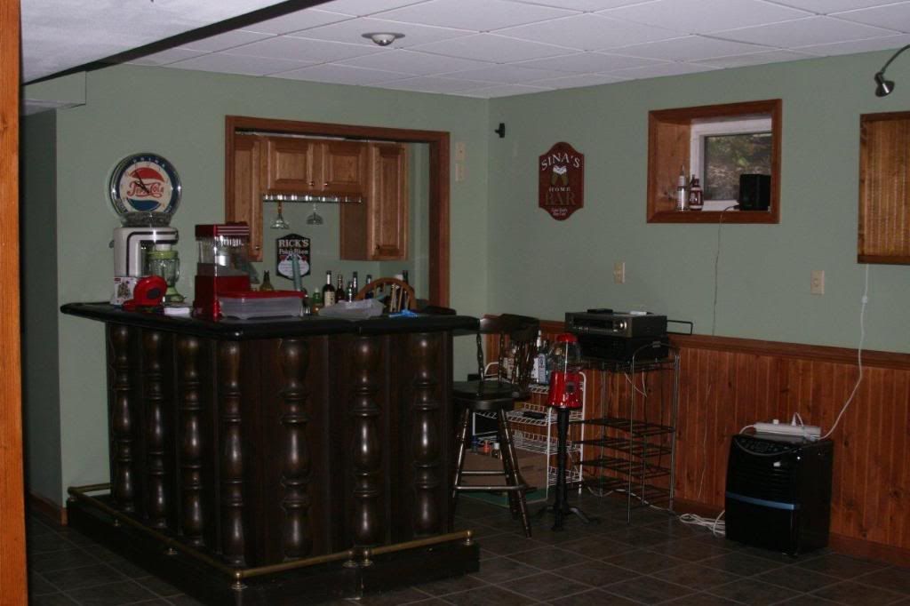

We are just starting the remodel of the basement at our log cabin at the lake. Our kids our older now so we are taking out the air hockey, expanding the bar and trying to fit in a nice large TV/sitting area. I want the bar to include a sink and ice machine so I may be limited to keeping the bar in the general area it currently sits but I am open to new ideas if they are buildable.
As you can see in the pictures, we have just finished the drop ceiling rip out and had an HVAC company come in to redo the duct work which will give us a lot more options compared to the big soffet that ran through the middle of the room previously (new ductwork goes in next week).
I'm looking for any ideas you may have around bar layout (my plan at the moment is to have an L shaped bar built where the existing bar sits today, back cabinets along the wall that wrap around toward the HVAC unit ending at a full size fridge next to the HVAC unit (the fridge could be rolled out of the way for HVAC service if/when service is required). The small window will be covered by the back cabinets and a bar size 32" TV will be built into the design. Right now the tan cabinets look like they are in a closet but it should be fairly easy to tear out the framing for the closet so it will flow with the rest of the area. The only dsign issue is the fuse box - I think I will just have to be creative with the cabinet maker to make an access door to match the cabinets.
Here are pictures of the current basement layout floorplan, a few pictures of the basement as it existed prior to the ceiling tear out, some general pictures of the cabin including the new walkout doorway we just installed in the basement, and then pictures of the new deck and stonework the new doorway leads out to toward the lake.
Doorway at bottom of stairs will be closed off to provide more privacy for the bedroom and there will be a door installed as you go down the hallway behind the stairs to allow access to the bedroom.
The ductwork shown here is coming out next week and will replaced with wider ductwork but saving 6" in headroom. I am still trying to determine the ceiling design we will use for the entire basement but raising this ductwork provides a much nicer finished area no matter what we do with soffets and ceiling design. my current thought is drywall ceiling with exposed beams (maybe logs to keep the log cabin feel) and a coiffered ceiling above the bar with wood that matches the bar.

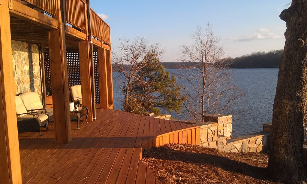

Looks like a great space, and yeah, view is acceptable... (what's the location)

This is at Lake Gaston on the NC/VA border.
Hockeypuck - the boat will splash this weekend for St. Patty's day. Kids don't usually get the jetskis out until end of April. Our rule when they were younger was no jetskis until I see you in the water swimming . . . .

So regarding the bar layout - it is hard to make suggestions without some more info. How many people do you want to be able to 'serve' at one time? Do you want just a large bar, or a smaller bar and a matching seating area? What else are you going to do in that space? You mentioned a large TV/sitting area, so I assume you don't want a projector/screen and theater seating, right?

I had some time the last couple days to play with Sketchup and look through some online pictures from this site on others I could find on line. One picture had a similar layout to mine with theater seats and then a sitting bar behind the theater seats with some high bar stools. I think that would work real well in our space. My thoughts are to cover the walls in a knotty pine tongue and groove wood and then use log covers to hide the support beams. I'm not sure if you can open the attached sketchup drawing, but here is my basic rendition of what I am planning for our layout. Suggestions and criticism welcomed.
post #10 of 28
Refined the model a little further and began actually laying it out at the lake yesterday. People on the couch will be about 9 feet from the TV and the people at the bar behind the coach would be about 12 feet.
My wife still does not love the idea of having the fridge in the 'closet' but when we remove the wall that makes it a closet, I think it will work out fine. We will just need to have work in a custom cover for the fuse box to make everything look like it is part of the cabinetry.
Any comments on this layout?

Looking good! And I'm with you, once it no longer looks like a closet, the "built-in" look of the fridge will be fine. And she'll like having the extra capacity at "peak" party times.
One thought - I can't see how wide the 'hallway' space is between the bar and the posts, but assume it's a standard hallway. Make sure that with the barstools there you can still comfortably walk behind them. You might consider pulling the front bar in 6-12", such that a pushed-in stool would be essentially flush with the hallway. Might set off the bar area a little more, too, and looks like you have plenty of interior space in the bar to work with.
