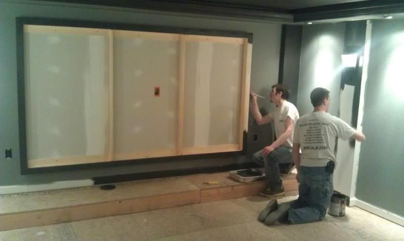

Built a frame on the wall to install lighting behind screen and have sconces installed with recessed lights as well:
Painting the room, the frame, etc:
Forgive my crack... LOL
The frame will have a 110" Elite Sable Screen installed on front with blue lighting behind it. I have all this completed, but will post pics later when all is installed.

Looks very nice - Especially considering what you started with. Did you put rope lighting behind the crown molding around the soffit? I'm not seeing any speaker wiring on the stage or front wall - where are the speakers going?
post #3 of 22
I built an 8" bulkhead with 6" high crown molding to create the tray and had blue rope lights cut for the room and around the perimeter of the screen.
I will have 2 towers, 2 12" subs, and a center on the stage for now. I built the room to have a 14" wide space behind the walls all around that I can run the wiring and do any plumbing or electrical work at any time. I will also have 2 mid and 2 rear satellite speakers as well mounted accordingly in the room. The rear satellite wiring is already run because they are within the non-accessable wall.
Have the rear wiring hanging through holes in the back and will mount the speakers on the ceiling centered around the bar window.
I will have all my components in a cabinet in the back corner to the left in the picture.
The room is pretty small, only about 15'x15', so I have it so there can be other people in the other room at the bar that can see whats going on on the screen too.
