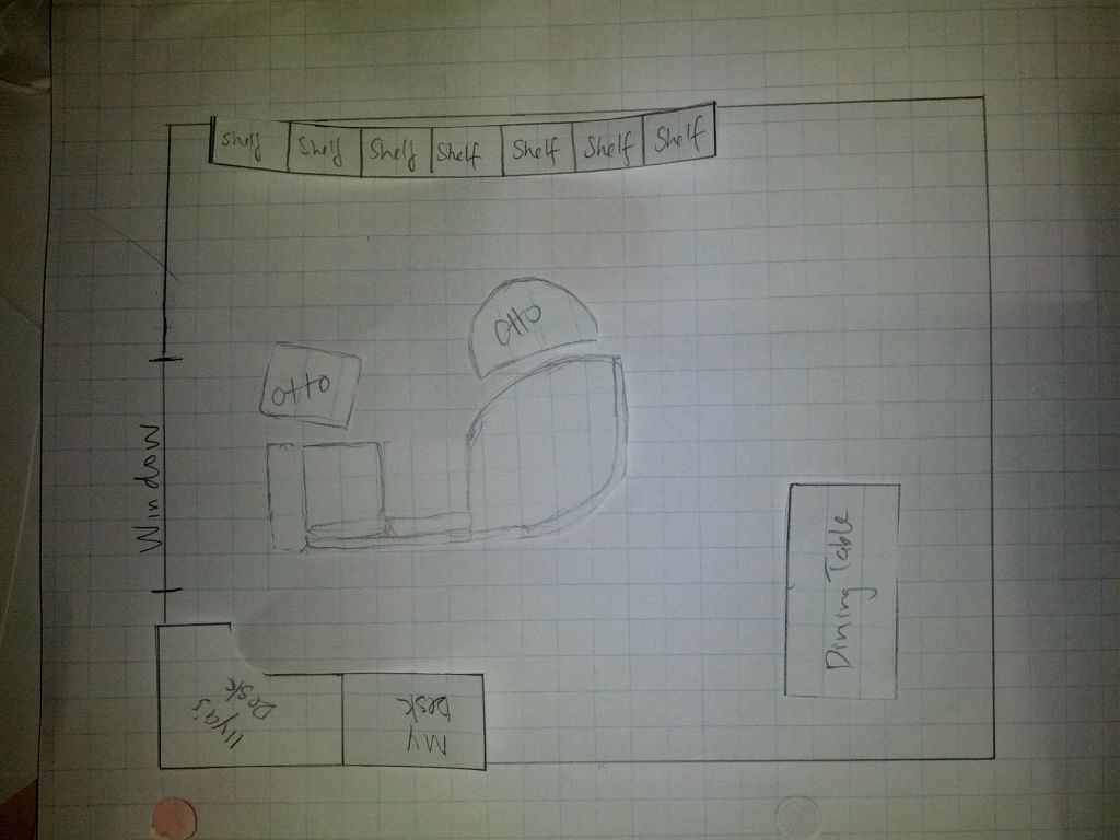

Hi guys! So, nothing too much more specific to mention here. Overall, there's a general standard when it comes to low frequency generators which makes it a lot easier to say that one subwoofer is better over another (how well the sound travels in whatever sized room, the frequency response, positioning of the port relative to the sitting position, etc...). What I can provide is a fairly accurate schematic of the room in which the subwoofer would likely be placed in the front left corner. That'll simply depend on where there'd be the most standing waves after I test it from the couch position. Any information and specific details from experience or otherwise would be helpful. Thank you!
PS- I'd like to mention that the $600 limit isn't including any potential deals based on past occurrences or whatever, so if you are aware of there even being the slightest chance of this, feel free to mention currently higher priced units. Thanks
EDIT: I currently have my sights set on the SVS PB12-NSD, the HSU VTF-3 MK4, and the Outlaw Audio LFM-1 EX. With hopefully a deal, maybe I could get any of these down to $600! I really did push my budget to its maximum here XD

A sealed 12" might be a bit taxed in a 4500 cubic ft room, especially seeing how your seated in the middle of the room. I would look at the ported 12"s in your budget, the Outlaw LFM-1 Plus, Epik Legend, Hsu VTF2 mk4, and Rythmik FV12, and also try to place them as close to your listening position as you can.
