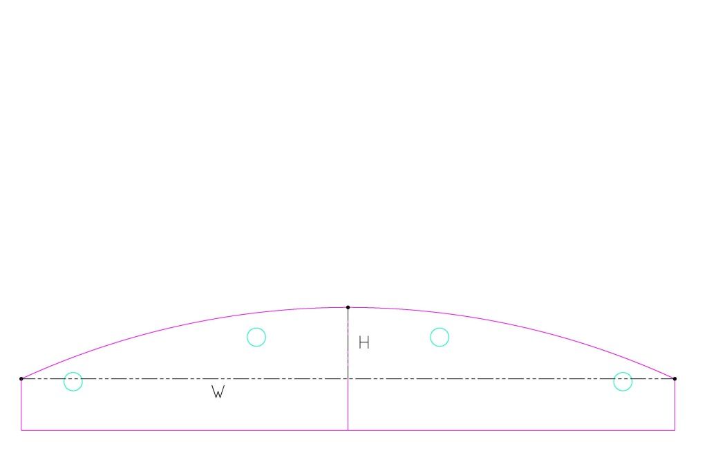

I am a little uncertain of the curved part and not too sure how ot accomplish that part. As far as the holes, I will have to look at the Bacon Race thread for the size to make again.

I have CAD so I can sketch out everything beforehand giving me the radius that I would need to make my arc. I plan to lay out the two pieces of MDF that will make up the curve in the driveway (already cut to width to fit) and, using string and a pencil, mark my arc then cut with the jigsaw. The radius on my soffit is about 128 1/16" so I will need a good open laydown space.
You can use this formula to figure out your radius.
radius = H/2 + W^2/8*H
H is the height (or depth in this case) of your arc at the midpoint from the W line
W is the overall width of the arc
Here is a picture.
W should already be set since you have the bottom portions of the light tray figured out. H is basically how far you want the arc to extend out into the room. You will need to offset this dimension some because you will need a straight mounting surface under your ladder structure.
I'm not sure about the rope lights. You'll probably have to ask Damelon about that. I think his actually went above the blocking though. I plan to use LED so I will be running mine above the blocking.
Hopefully that helps you out.

Just curious Vanice, but where did you get that formula from for the radius? I'm having trouble figuring out how you derived it.
EDIT: Nevermind, I found it. It's been too long since I've taken a geometry class. Intersecting chord theorem......
Anyone that's curious can read about it here:
http://www.mathopenref.com/arcradiusderive.html
