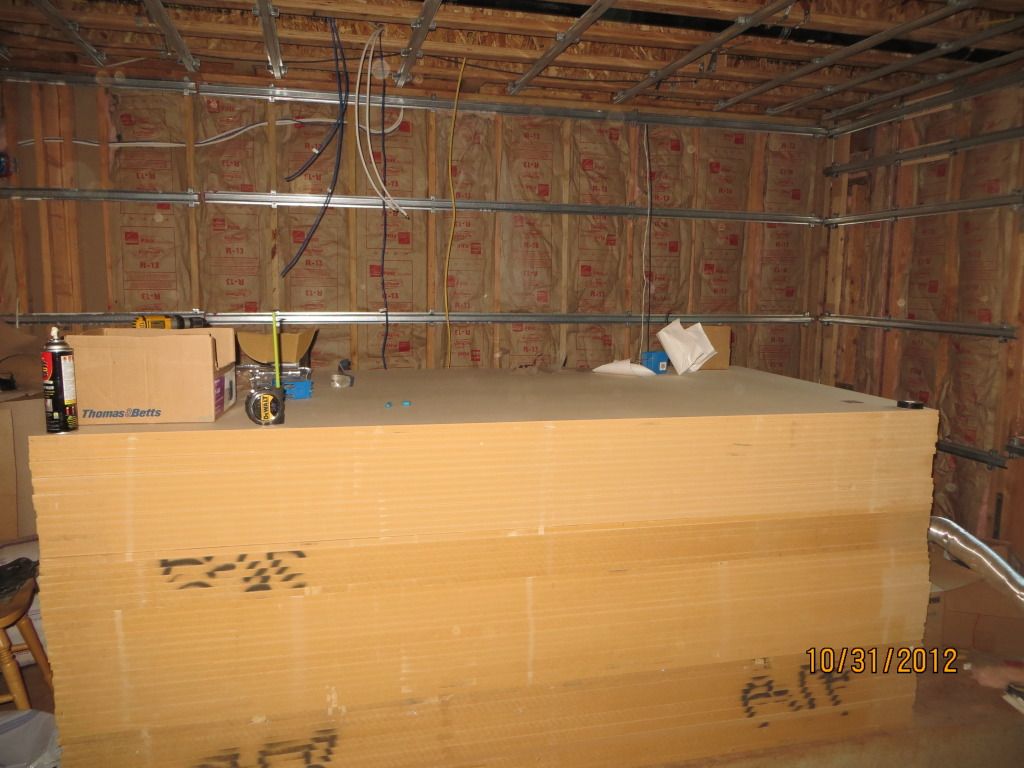

Finally, here is the stack of MDF that will be going on to all the walls and ceiling. It will provide easy attachment points everywhere for speakers, soffit, projector, etc. The stuff is heavy.... real heavy. It was a great back and arm workout moving that stack of monster wood.
The plan is to fill in the ceiling with insulation and begin putting on the MDF this weekend. I'm going to be very tired I suspect......

n00b questions.
are you using the MDF instead of drywall or am I missing something? If that is the case, what's the benefit?
post #145 of 336
I'm using both. The lower layer will be MDF and the top surface will be regular drywall. Each one will be offset to ensure seams are covered up and the most sound possible is trapped. Ordinarily Kinetics suggests using two layers of drywall. In my situation I need lots of points of contact in the room for a large wall mounted tv behind the projection screen, hard points for the projector, speakers on walls, a star ceiling, soffit around the edge of the room, etc. Having a hard board underneath the drywall allows for an infinite number of attachment points and also reduces large holes into the lower studs that would leak sound. This wasn't my idea. I read a recent article in Home Theater just a month or so ago and it made great sense to me and I went with it. The article actually suggested plywood and I ran that part of the idea by the folks at Kinetics Noise Control. They suggested using MDF instead due to better resonance profile of MDF when compared to plywood. One problem is that MDF weighs a LOT! It's a little under 100 lbs per sheet which is a lot more than plywood. This might be a problem with ceilings that can't take the extra weight. It should be less of a problem on walls as the weight of the MDF and Drywall sits on a special insulation strip that then sits directly on the floor when it is then attached to the wall. In effect, much less of the weight should actually be on the wall. The ceiling is a different story. There is no way around that one, all the weight will be pulling straight down.
Oh, I almost forgot.... one last benefit; it will add mass to the wall. When everything is done the walls will be VERY thick and heavy. That, coupled with detached walls and ceiling, should really reduce the sound. I don't know how much more STC rating it will add but my original plans via Kinetics Noise Control come out to 61 STC. So maybe I get one or more points....maybe 62+ STC, who knows.

thank you for the thorough answer. That really cleared up my question and makes perfect sense. I am used to seeing the DD and have read quite a bit on it, but in my limited AVS exposure had yet to see this method. Now my curiosity has been piqued, and will now do what all real AVS'ers would do... go spend obsessive amounts of time try to find and read more about the potential advantages/disadvantages of this method, lol.
Can't wait to continue to watch this build!

That is one expensive stack of supplies. eek.gif What made you go with MDF instead of cheaper OSB?

Here is some progress. I thought I was going to be fatigued but I am totally exhausted! Lifting and moving 3/4" MDF by myself has not been enjoyable. I still have a lot more to do frown.gif
post #150 of 336
Good god that's a lot of MDF. I thought moving a couple sheets to build some speakers was bad. Why did you go with MDF instead of some form of sound insulating drywall, such as the stuff green glue offers? I'll be building a theater in my parents' new home next year and I'm trying to figure out how to best soundproof it.
