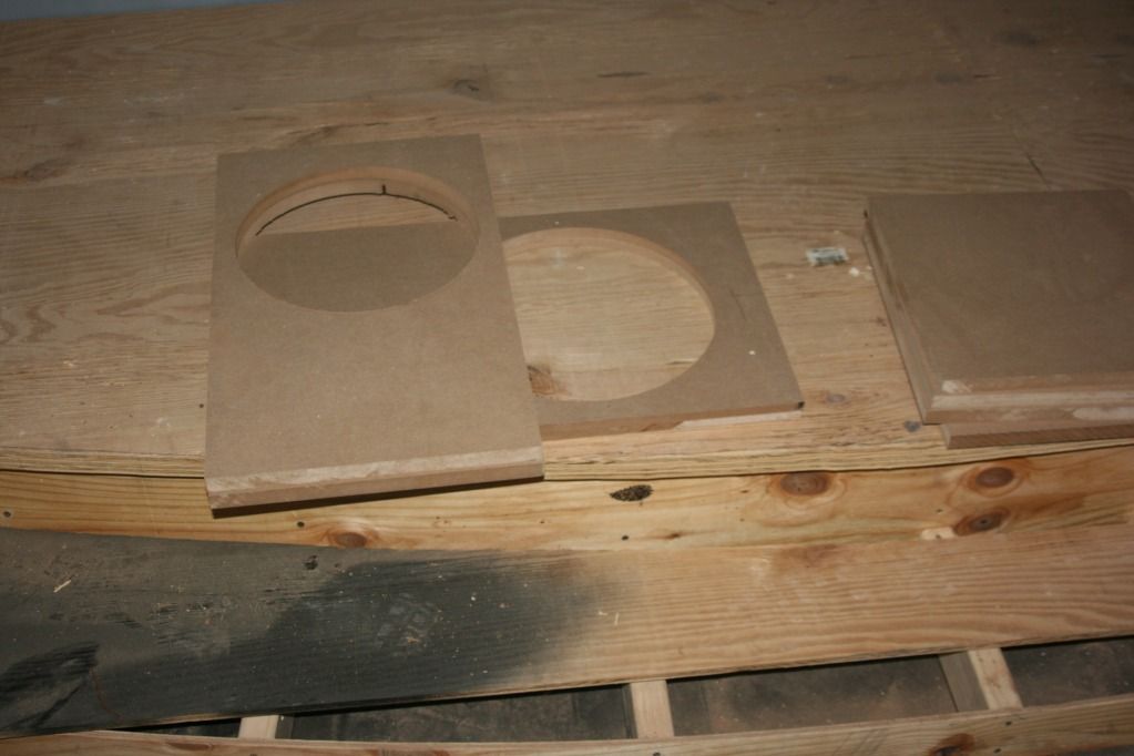

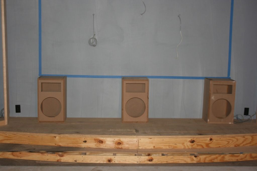

well seeing i was unable to get any sand for the stage ... i decided to start on the econowave speakers

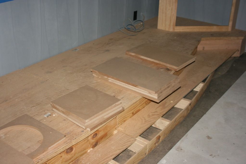

first i cut on the all the pieces

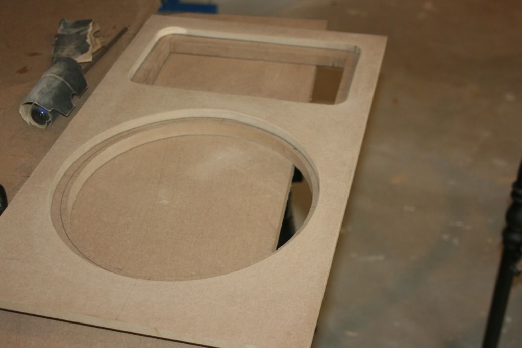

they are made from 3/4 MDF and 1/2 mdf and 3/4 for the fronts to give the woofer and horn a recessed look
i used a jasper circle jig and plunge router to cut the circles

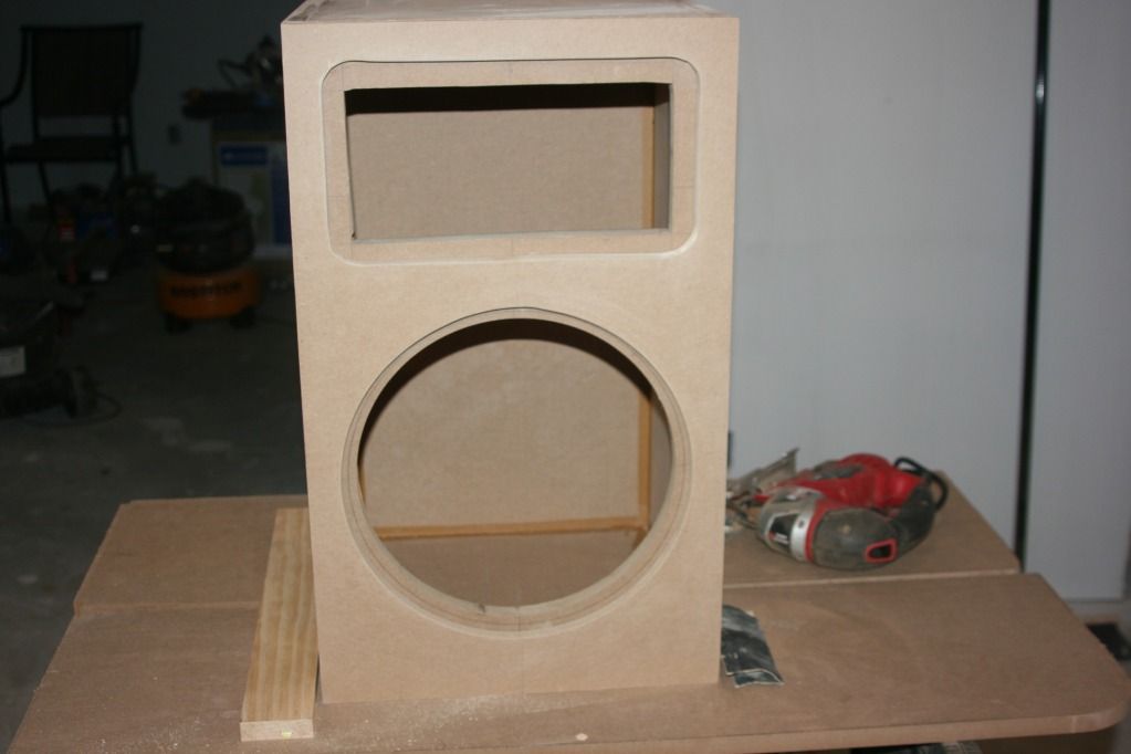

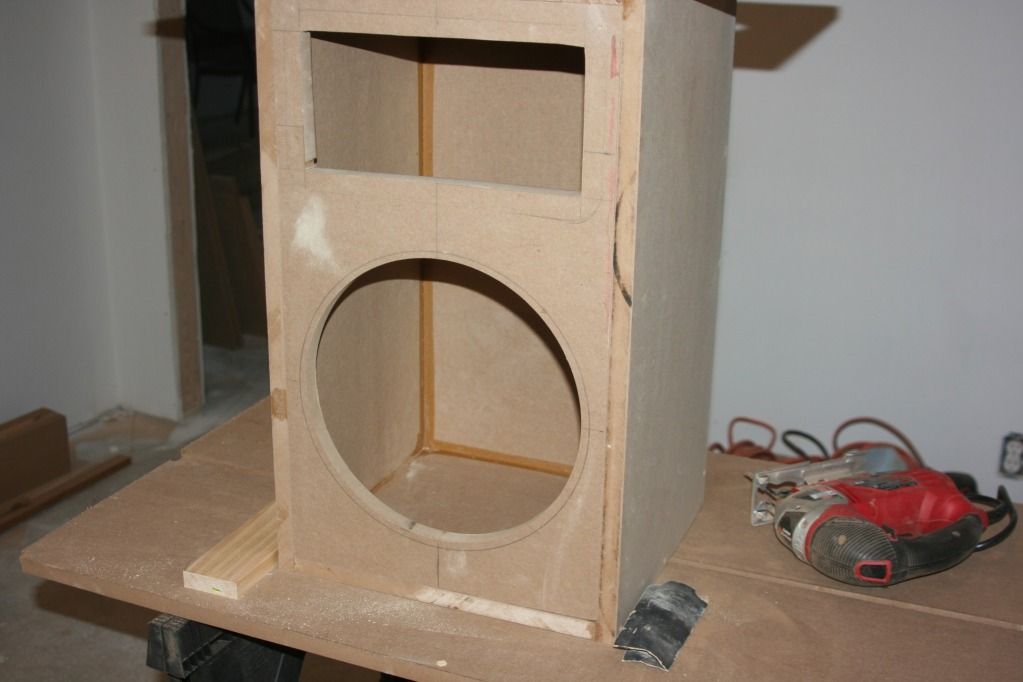

next it was time to put together the all the pieces , everything was glued and screwed
test fit the fronts but they will be secured at later date after i install the bracing and crossovers
just need to bondo and sand them then prime and paint

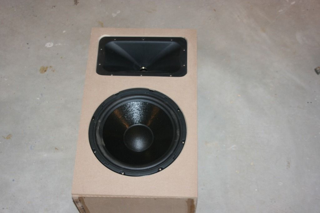

but i was able to test fit them to see how they looked, i am pretty happy with how they are turning out this the first pair speakers i ever built
and the completed boxes

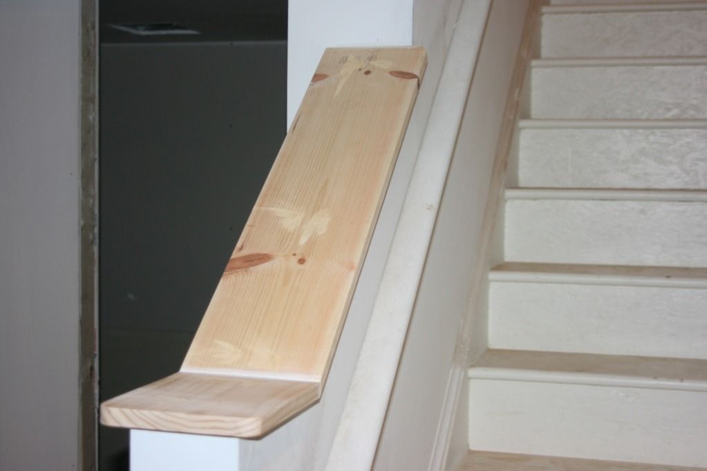

and finally something for the wife ...... she bumped into the corner of the stairs the other day so i decided it was time to finish that part off smile.gif
just need to finish the trip that goes under it
