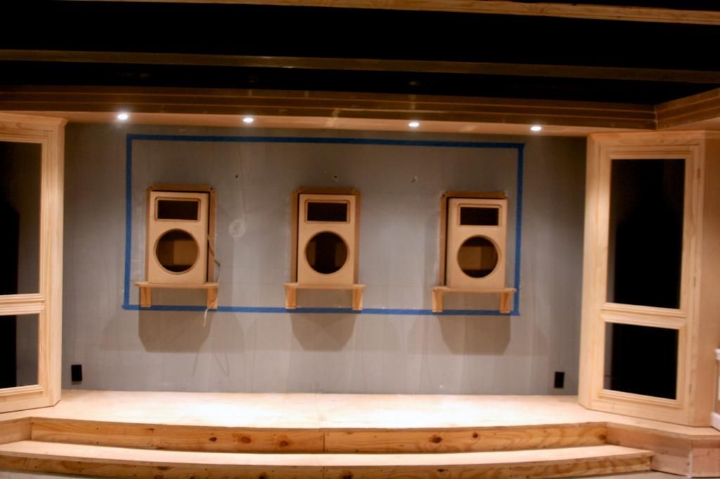

How close will your screen be to your speakers? Mine are only 1-2" from the screen and when I turn the lights on behind the screen it just casts a lot of shadows. If you could put lights right under the speakers you might have better luck, because I am just using some track lighting from above. Just thought I would mention it now while you can make changes.
they are set to be 9" from the screen but i still have some wiggle room if need be.

got almost all the trim work done ... just have to finish the shadow boxes on the other side of the theater

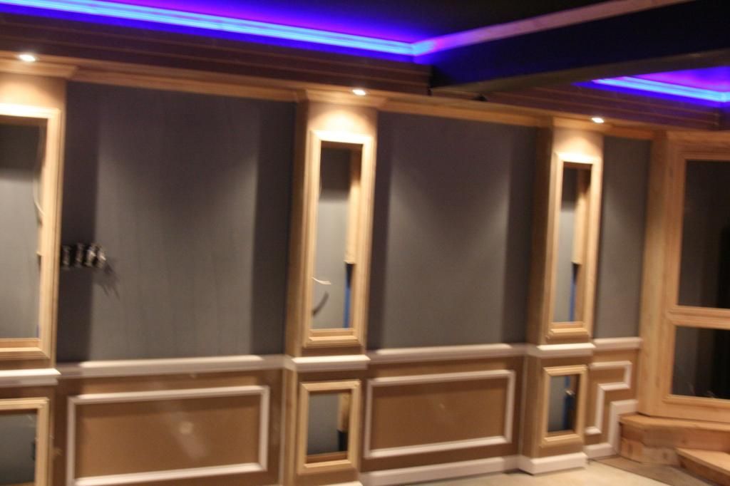

also finished up all the recessed lights
the only thing that i am little disappointed in is between the columns there is shadow at the top that i am a little concerned there won't be enough light to show off the baltic blue gom panels
what do you guys think? imo i think the space is to small to ad more lights .... i dunno maybe i am just being a little picky
Personally, I think that the panels will look fine with the light. I really like the "light arc" on the wall that having lights in the soffit produces. It looks like you've still got a pretty large well-lit area to show off the blue.

thanks i think our right .... i asked a friend also and he said he would have never noticed unless i told him what i was seeing ..... i think when your working on your own space you start to see every little thing

I think additional lights between the columns would be too much. The shadow lines look fine to me. Different bulbs cast different shadow lines, not just the beam spread but the crispness along the shadow. You could experiment with a few different bulbs if you aren't happy with the current look.
The woodwork looks fantastic. I can tell you spent a lot of time making everything right.

ya i didn't think about different bulbs that will be something i will experiment with once the panels are in place... Thanks for the compliment, this is the part i have i really enjoyed like Mario said earlier at this stage you see how the trim makes such a huge difference in how everything looks.. before i prime everything i will probably spend a few days just going over every inch of all the work work to make sure everything is smooth and that all seams are filled ... one thing i have been happy about is i think i have only used a small amount of caulk thus far .... i have only used a little over half a tube and that includes trim work in the rest of basement so not even a full tube for the entire basement eek.gif
