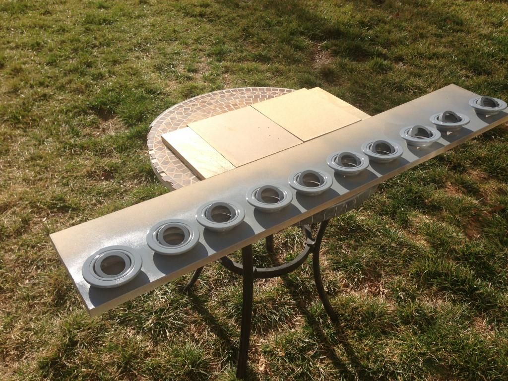

was off yesterday but didn't get much done ... did get all the covers for the lights painted thou

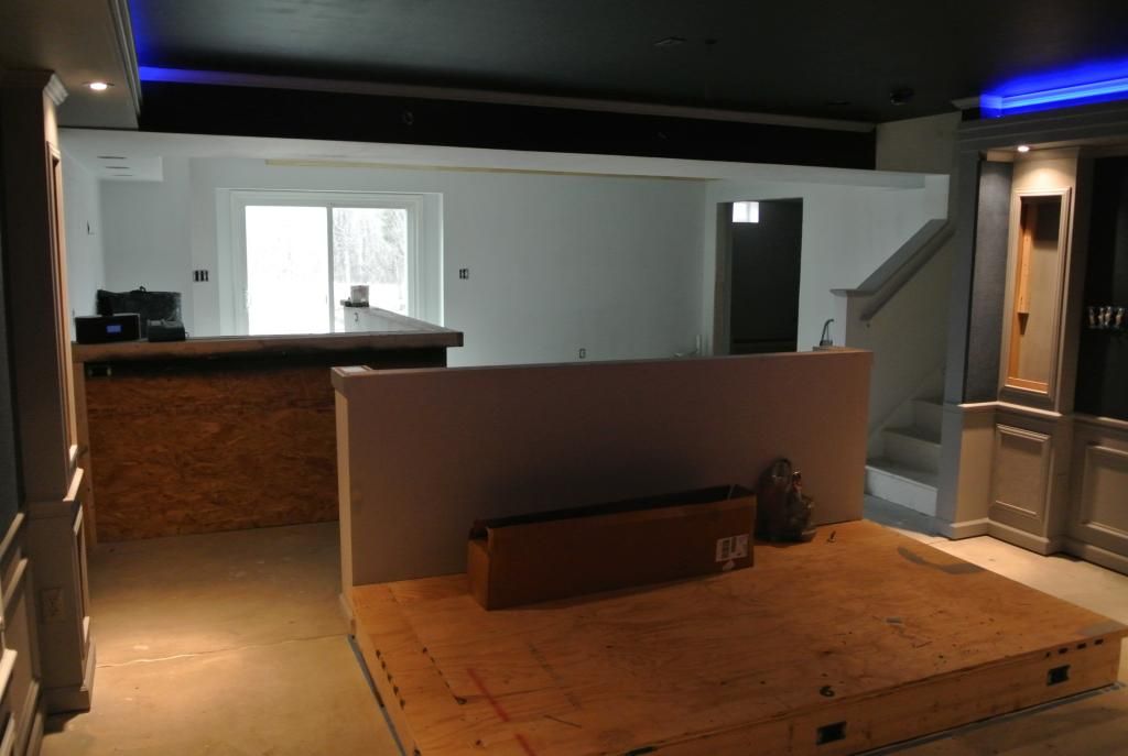

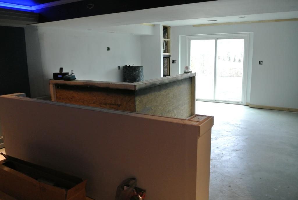

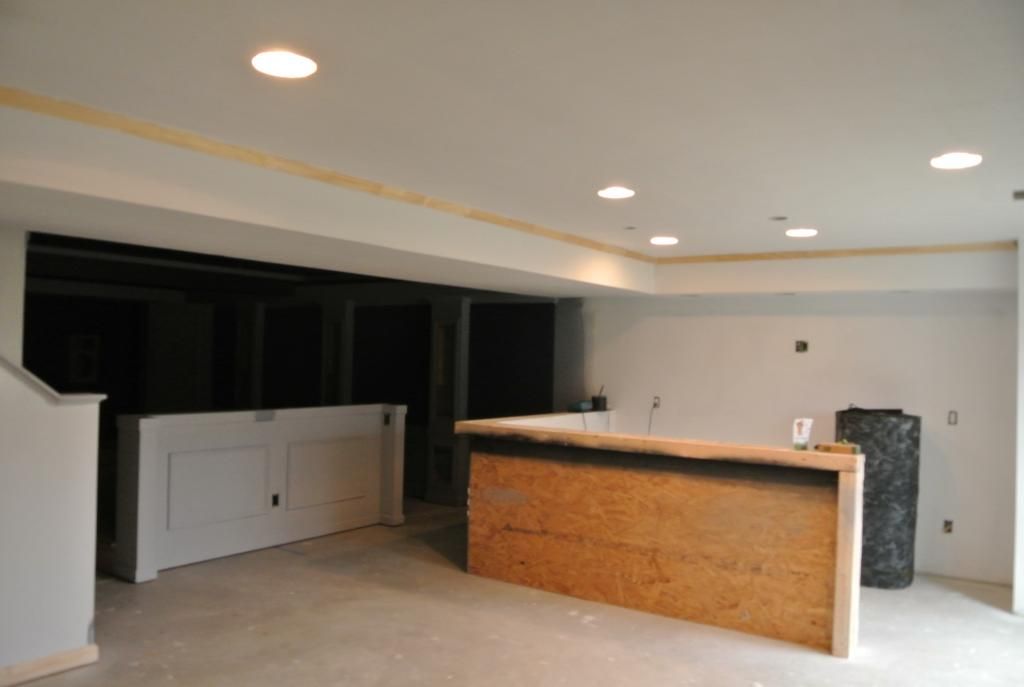

got 99% of the theater area painted the color we choose was Benjamin Moore "sweatshirt grey"
here is the sample ....
took me a little over two days to do two coats .. second coat i added Flotrol that way it gave me more time to work with the paint and with that along with a nice fine brush the virtually no brush lines at all very happy with the end result .
i still need to paint the crown molding above the stage ....... note to self next time PAINT THE CROWN BEFORE NAILING IT UP........ live and learn frown.gif also need to paint the back of the riser .
once everything was dry my shipment of fabric came in so i was anxious to see how the well color matched so i started with the cabinets on the stage ..
and the finished product

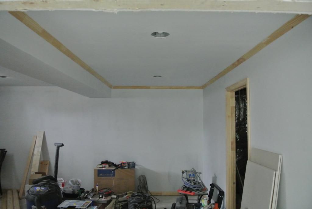

here is pic of it during framing ...... the other drop down you see in the front top of the pic is where the main hvac ducs run
the beam that drops down in the theater area is 9 inches.... i used mdf and boxed it in very tight to the beam

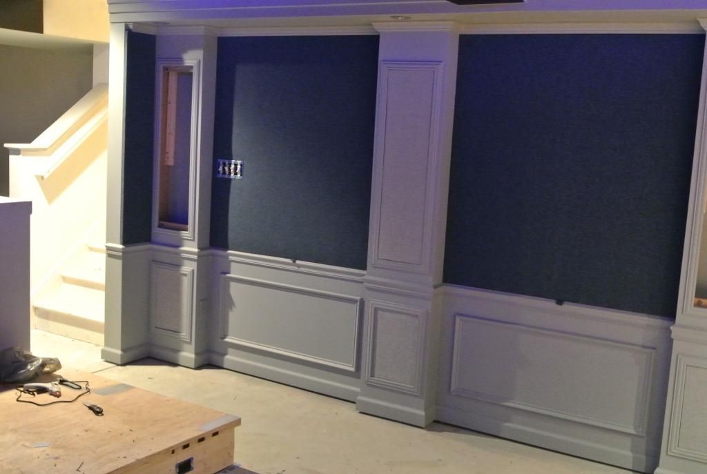

got the fabric panels in the lower part of the columns ... these where built just like i built the fabrick panels for the rest of the room just 1x2's put together with the kregg jig.
the the fabric color i choose for front cabinets and the columns is Bleu Papier i am so happy with how well it matches the sweatshirt grey BM paint and it really makes the baltic blue fabric panels pop

no clips or anything on the soffit ..the soffits where constructed by using 2x2's on the ceiling and the wall ... the deigned is borrowed from the "bacon Race" build and they did a much better job with documenting the build steps ...
that is the one thing i wish i did a little better was to have the camera by my side at all times and just take pics as i went along..... will try to better job from now on thou.

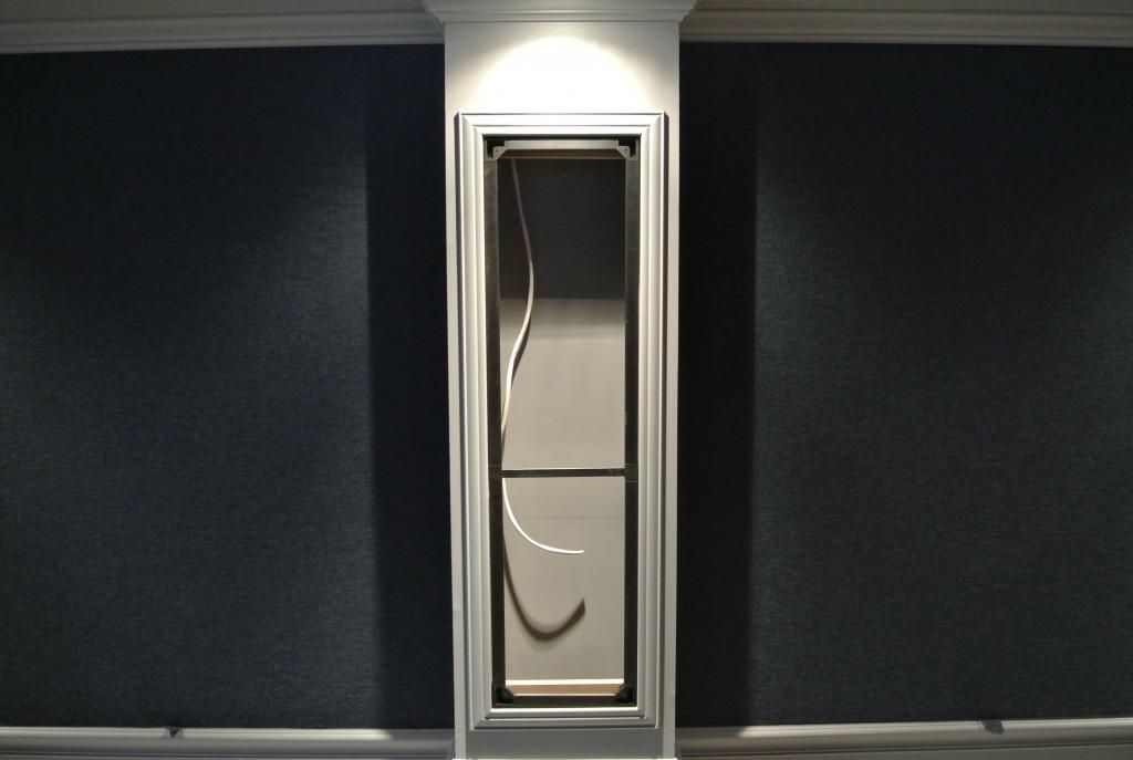

started on the fabric speaker panels in the columns
i ordered 6 replacement kits from parts express
these are friction fit and i also used small magnets in all four corners
then i used hot glue to attach the fabric to the panel and test fitted

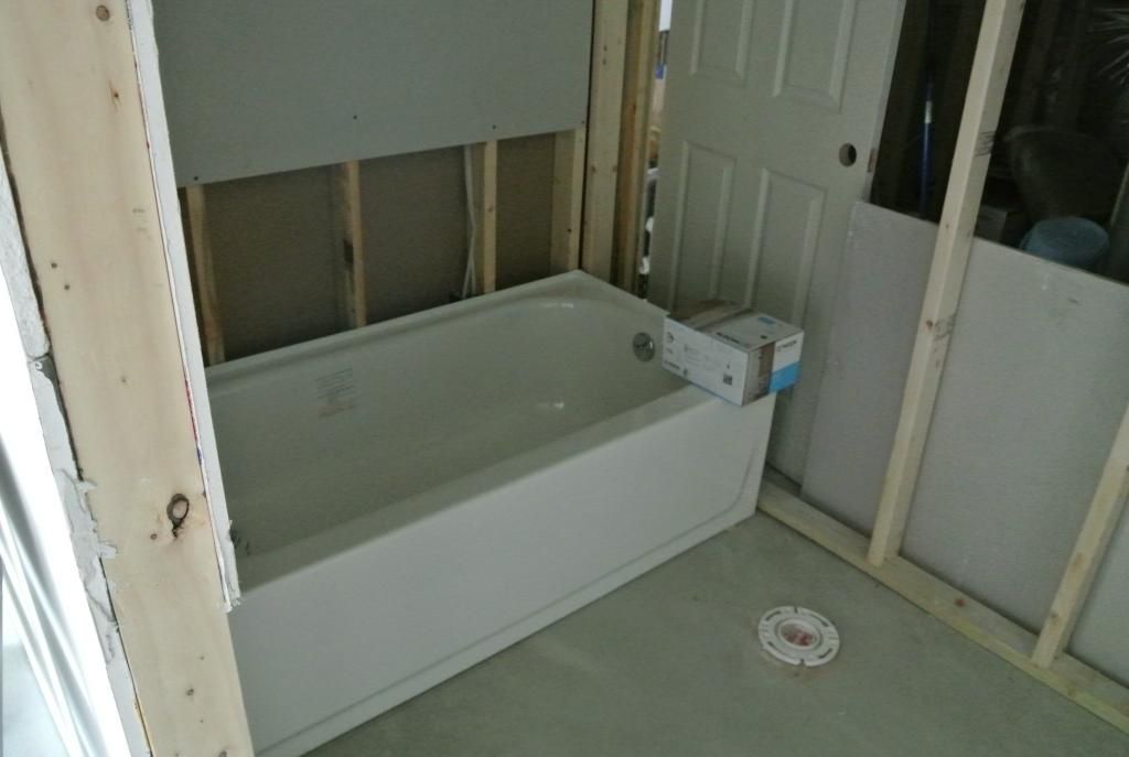

oh yeah got some work done in the bathroom also
i was going to user the kerdi shower pan kit but ended not fitting correctly it would have ended up being way to close to the toilet
so returned it and bought a tub instead and now the toilet is the correct distance from the tub
will be removing the drywall around the tub and replacing with concrete backer board

I'd keep the drywall and use kerdi over it. I used it in all of my bathrooms, the stuff is fantastic. I used concrete board only on the wall where the shower body was.. in case the plumbing sprang a leak.
Tim
post #300 of 412
Tim
good point..... thank you
