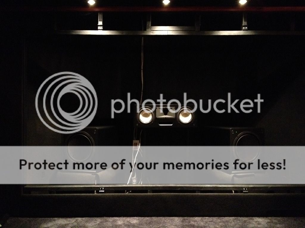

A great deal on the sub and glad it made a noticable difference in your system. My two 12's are actually spaced similar to yours and I am quite happy with the bass at my typical seating location but it varies hugely from seat to seat. (The small squarish room certainly isn't helping.)

I have a question. You are using acoustic transparent screen yet you put your front and center speakers outside the screen. Isn't the purpose of having the transparent screen is to be able to put the speakers behind the screen?
Well, I did put everything back there when I was doing my initial set up and testing, but I found that it made the sound stage way too narrow. I needed to widen out my fronts. I ended up moving my center behind the screen along with my two subs. This is my current set up, with my fronts out to the side of my screen.
