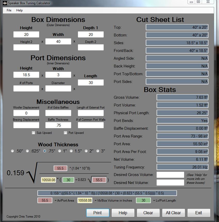

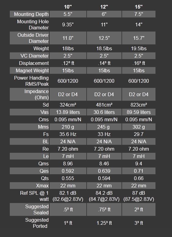

I am planning on building a box for a dc level 2 12" on 250w RMS with the following t/s:
This is what I have so far... I want to know if having a port area that low will be that big of a problem? Also is it possible to have too much net volume? The recommended by manufacturer is 1.25cubic feet and as you can see my box would be way bigger than that... Sorry I have very little experience with theater setups.
post #2 of 10
you are good to go on port area. 3" x 18.5" is actually pretty large for a 12" driver.
however, it looks like your enclosure will be tuned for about 26hz. is that about what you are shooting for?
post #3 of 10
this is what you have designed. ignore the frequency response above about 60hz. that driver has an inductance a 7mh, so it is going to rolloff pretty fast

here is an alternative that might work a little better for you.
4 cubic feet net volume enclosure, instead of 6.11.
port that is 2" x 18.5" x 44" long.
that gives a tuning frequency of around 22hz, but more importantly it get rid of that big peak.
edit: the port velocity is also good in this one with 500 watts.

I appreciate all the help! This actually is for a home application and I think I am going to use your 1st design LTD. Thanks!
