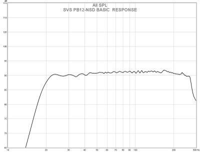

If you can swing an additional $38, IMO you should consider dual SVS PB12-NSD subwoofers.
Tremendous performance...x2!

MAX ACOUSTIC OUTPUT: 121dB @ 30Hz 1/8 space, 1m. I dunno if that's peak or rms, but I'll assume it's rms.
The PB12-NSD's audioholics/data-bass testing shows 105.9dB 2m GP rms. +6dB from 2m to 1m gets you 111.9db. Adding another 12dB for going from 1/2 space to 1/8 space gets you 123.9dB. If the klipsch numbers are peak instead of rms you could add another 3dB for peak values and that would get you 126.9dB for peak dB @ 1m 1/8th space for the PB12-NSD.
I could be wrong on those numbers of course, but hopefully I'm right
Measuring methods make a difference here, we can see that from Paul Apollonio's different measurements for the Rythmik FV15HP to Josh Ricci's. I don't think you can compare whatever Klipsch did to what Josh does, so I wouldn't regard that comparison as valid. Just looking from the SW-115 designs, I would guess its tuned higher then the PB12. However, with a similar amount of power, a larger driver, a slightly larger enclosure, and Klipsch's propensity to use higher sensitivity drivers, I would have to guess that the Klipsch would have more output overall. I could be wrong though. Klipsch has been fairly willing to send their stuff in for third reviews, and from what I understand they have a good relationship with Audioholics, maybe if we get lucky we can see Josh review the SW-115.
