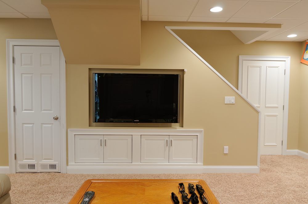

Here's a pic of the basement area directly outside the theater:
The door on the left is the AV closet which contains my equipment rack and also the Lutron Grafik Eye QS controller.
There are vent openings on the bottom of the door since the closet contains a thermostat controlled bathroom exhaust fan to pull out the warm air.
The door all the way to the right is the entrance to the theater.
The Samsung LCD is hooked up to the Zone 4 HDMI output on my Denon AVR-4520CI so it can watch any of the same sources that feed the projector in the theater. You can watch a different source, or have it mirror what's being shown in the theater for overflow seating (or so you don't have to miss anything when you go to the kitchen or the bathroom- which are also in the basement).
Here's a pic with all the doors open:
The Oppo Blu-Ray player is housed in the lower cabinet on the left under the LCD so my kids don't have to open the AV closet just to pop in a disc.
The lower cabinet on the right under the LCD is for movie storage. We only really need to keep the 3D Blu-Rays there since all other movies are just loaded onto my NAS for playback on the Dune Smart media player.

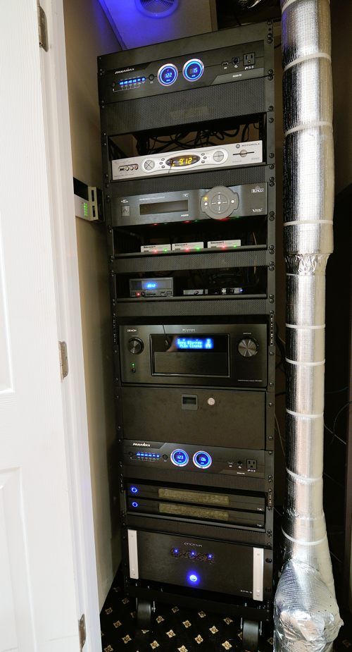

Here's a closer pic of the equipment rack:
To the left of the rack you can see the Grafik Eye, and just behind that is the thermostat control for the exhaust fan.
From top to bottom the rack contains:
  • TRENDnet 450 Mbps Wireless N Access Point TEW-690AP (mounted on top of rack)
  • Panamax 5300 voltage regulator and AC line conditioner
  • TRENDnet 16-Port Gigabit Web Smart Switch (hidden - mounted facing back of rack)
  • Motorola DCT-6412 III cable box DVR
  • DC-300 Dimension Digital Controller for Runco LS-12D projector
  • 3x Stewart Cinemasonic Processors to compensate for AT screen in front of Triad LCRs
  • URC MRF-350 base station for MX-850 and MX-980 remotes (hidden behind Stewart processors)
  • Dune HD Smart D1 media player - Apple TV Gen 3 - Roku 2 XS
  • Denon AVR-4520CI
  • Storage Drawer
  • 2x Triad RackAmp 600 DSP subwoofer amps
  • Emotiva XPA-3 Amp for LCR's

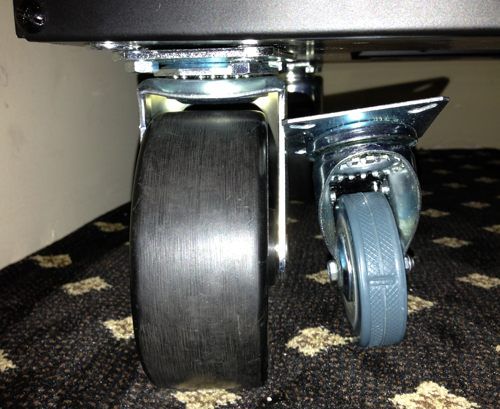

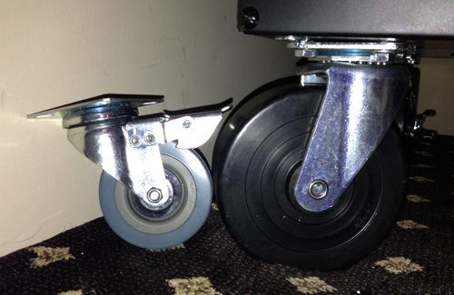

Funny story about the SnapAV Strong 37U rack. Just after we had put the finishing touches on all the equipment and wiring for the rack (thinking, "Yeah! We're all done!) we went to push the rack back into the closet and... one of the casters EXPLODED! OK, maybe it didn't explode, but it did fail pretty catastrophically. Now we had a leaning rack and no way to move it back into the closet. Luckily I had kept a really heavy duty set of casters that came with a garage refrigerator I had purchased several years ago. We jacked up the rack and drilled some new holes in the bottom to line up with the mounting pattern on the new casters. I ran to the hardware store to get the proper nuts and bolts to attach the new casters. We were back up and rolling in under an hour. Times like this make me glad I'm a bit of a hoarder when it comes to spare parts.
Here's some pics of one of the original casters next to a replacement caster:
I think it's pretty clear who wins.

A great project from start to finish. Well done indeed! I hope you are deep into the enjoyment phase.
As you appear to be very detail oriented, I'll just make a minor editorial comment about the Panamax:
It is a line conditioner, but does not provide voltage regulation, at least not based on the specs I found here.
Just a question. You have the Stewart Cinemasonic Processors installed. Were these needed because the Audyssey EQ was not able to automatically compensate for the screen? I can see how they might have been needed w/o Audyssey.

I LOVE the way you did the recessing storage doors on the cabinets below the LCD... what size is the LCD?
The LCD is a 52" Samsung LNT-5271. That TV was put in in early 2008 when we finished the rest of our basement (with the exception of the home theater area which was set aside until now).
