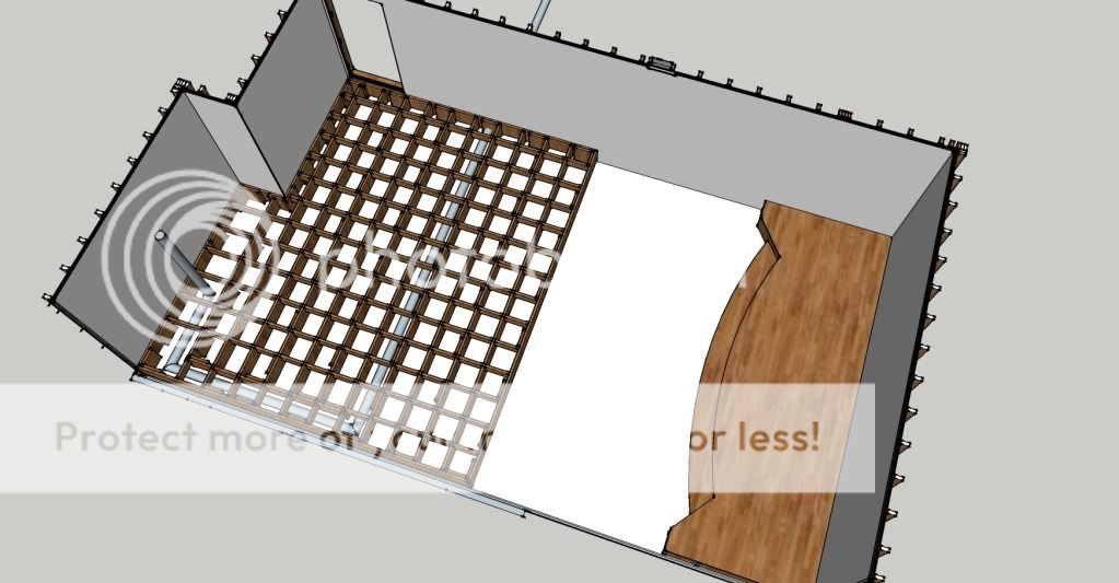

I've been thinking about how to get my HVAC supplies and returns into and out of the theater, and it occurred to me that I could possibly run my return under my riser. My theater has an odd corner in the back that I will probably put a false wall over with fabric panels to hide. I'd planned to put bass traps back there, and possibly another sub, but that would also give me a place to run my return ductwork down, and under my riser. Does anyone see any issues with this? The way I have it shown would run the duct along the perimeter of the riser, and then under the area where my seats/bar will be located. The riser is 15" high, and will be filled with insulation. I'm considering leaving openings along the sides to help with bass trapping as well, but that's a topic for another thread. Any thoughts or opinions?

I was thinking about doing the same thing. The only thing I've thought of that gives me pause is not being sure if I want the return near the floor or the ceiling. You probably have a better feel for that than I do.
Assuming double or triple subfloor and insulation in the cavities, I don't see a drawback.
Also, nice job with the render - either everyone knows shortcuts that I don't, or you all have tremendous skill and patience with that software.
post #3 of 15
Run it from the back to the front in the middle of the riser, shorter path. Seal that area well from the rest of the riser for sound containment purposes. That leaves that back corner vacant for your riser as bass trap concept. Be sure you are using the correct size duct for the volume of air you need.

For what ever it is worth I have a client who is passing the return duct for an adjacent basement room through his riser. Comes in the back of the far joist space and exits out the middle on the side.

It is fine unless you decide to get rid of the riser or repurpse the room.
post #10 of 15
If you re-purpose the room just put a low wall return where the duct enters the room to the left of the door.
