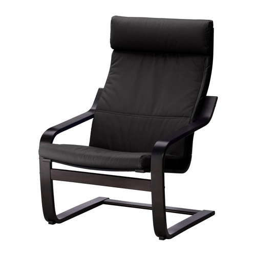

Alternatively, I can use these non-reclining (they recline only slightly) at the back :-
This will also allow 4' distance between back seats and front seats. 4' is very tight, but my main regular seats will be at the front. For back I am just trying to find a good option that I can use if more people (more than just my kids and I) are watching. My brothers often visit and we watch movies together.
