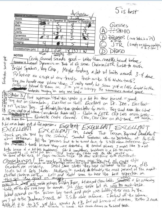

To my ears --- for my specific clips and for my time in the sweetspot chair - Speaker C was absolutely unique in that when I heard it at +10 on the DeadMau5 track, I didn't rush for the volume control. I looked at carp and was like YEAH!!! --- now we are talking! It was super clean and sounded Awesome! I started edging up the volume and it just stayed clean. I kept inching the volume up and got to +16.5 dB over reference and it still sounded absolutely Awesome! At that point even I quit moving the volume up because it was beyond extreme and still AWESOME -- there is no way I could need more spl even if the speakers still possessed the capability of more. It was everything you could hope that track to sound like. Joel Thomas Zimmerman himself would have been grinning ear to ear on this track. I don't know how Speaker C could have played this track any better, and the submersive HPs were taking it all in stride and sounded fantastic as well. A+ A+ A+ A+ A+. I immediately thought these speakers had to be the JTR because what else could possibly generate that much SPL and stay clean? I exclaimed to those sitting next to me that for my part we could stop the Speaker C audition right there for this set of speakers and that would be sufficient. I knew which speakers I most liked because these seemed to have so much more ridiculous headroom and sounded nearly as good as anything else we'd heard in the other categories to this point --- but I'm glad we didn't stop the audition, because there was more to learn about these speakers. This was early in the audition as my clips were second. Alas, as the other attendees clips went on I realized Speaker C wasn't as clearly superior to Speaker B (which I thought at the time was the DR-250) on all things. Turns out by the end of Speaker C's audition I could have flipped a coin and been happy with B or C. I felt like B was more refined and lacked some of the harshness I detected at times on Speaker C, but Speaker C dynamics sure were impressive to the ninth degree! Midbass was crazy. Gunfire during the movie scenes was just beyond fantastic. At the end of that session I was thinking that the Speaker C was definately JTR. Though I was a bit frustrated because Speaker C didn't cleanly sweep Speaker B. After the full Audition I actually found myself thinking Speaker B was probably the more realistic pick for me because of some of that harshness I heard in some of the later music on Speaker C, but man I loved the headroom on the Deadmau5 track - LOVED IT! And the gunfire on Speaker C was the stuff home theater dreams are made of.
Individual Speaker Impressions -
Speaker A -
Bright Speakers - Very Crisp
Maybe finding limits at around 3-4 over reference on DeadMau5 track -- more volume than I actually need, but I don't like finding limits on equipment -- and I know I'm just happier with a product if I don't know limits exist or at least can't find them)
Harsh on the classical music clips that Grant selected (but I don't like those tracks anyway. tongue.gif )
Fantastic imaging in just a single seat. No imaging anywhere else --- very much left channel dominant if on left side, or right channel dominant if on right side as I moved around the room during the music, but the sweetspot was very good! I scored it a 4 on imaging, but if you were only talking about the center main seat it would be a 5
Center Channel sounds very good, better than most center channels I've ever heard.
Great Dynamics on the Book of Eli scene
The chain falling down the well in the LOTR is a bit too harsh/intense/sounds like a mesh of sizzle rather than chain links clinking
Goosebumps? 1 time on the Michael Jackson - This Is It demo track -- very brief - like one second in the dynamic horn blast. Not as much emotion created from these speakers as I would hope for.
Overall I liked them for movies, but didn't like them as much for music. The treble bias was too strong for my tastes.
I figured these were the CHT SHO10's
I was wrong - these were the ED Cinema 12s.
Does it make sense? I was surprised with this because I always like the Cinema 12's in carps house, but on a recent loan of carp's ED cinema 12 front soundstage I did think the treble was too strong in my untreated tile floor room. In hind sight this makes sense because the center channel is especially strong on these speakers, and I thought the movies were great. I didn't much like the music on the cinema 12's in my room, and I think this was recreated in the blind testing, but I failed to identify them correctly as the ED Cinema 12s.
Speaker B -
First Impressions is that this speaker is a bit less treble biases which is good!
I thought it was excellent on my song selections, excellent on my acapella track - excellent on guitar rifts, excellent on rap, excellent on 80's music.
I definitely liked these speakers more than Speaker A for music.
I stll had to turn down the Deadmau5 tack to +3.5 dB over reference or so --- cause like the first speaker audition this one sounded bad at +10 on that track IMO.
I thought these speakers were a bit closer to what I'm used to at home -- though still perhaps a bit brighter than I prefer.
The Chain on LOTR falling in the well actually sounded like a chain. Much better than speaker A as there was no harshness on speaker B
Fantastic center channel experience! Just no strain at all. Very Good!
Clear Clear Clear on the Michael Jackson Track. I loved it, but I felt I'd heard better on this track when I demoed the ED's at my place a few weeks back.
I felt the imaging on these was the worst of the group, as I didn't hear a center channel presence at all when I was in the sweetspot. YET oddly enough when you were off axis the sound was more enjoyable to me. Sitting on the left or right side of the room didn't mean you only heard the left or right channel as strongly as speaker A I felt.
Good for Movies too!
Goosebumps? yes 2x's. Once in one of Carp's rock songs on a guitar solo of all places??!???!? That never happens to me on that kind of music. I don't even like that music? But guitar rifts sounded great on this speaker. Then a second time and for a longer period on the Michael Jackson track.
Overall I liked these quite a bit better than Speaker A. They sounded pretty similar for movies with the slight edge going to speaker B, but for Music I really liked Speaker B quite a bit more. Speaker B seemed to be a very refined speaker.
I figured these were the DR250's if only because I couldn't place their sound. They felt warm, and refined.
I was wrong - these were the JTR Triple Eights.
Does it make sense? This is a resounding NO. I've heard the JTR speakers before and felt they had a brighter treble bias than what I heard in the blind testing of Speaker B. Also while I really liked these speakers at reference level, I did not like them at +10dB. I would have figured the JTR should have made mincemeat out of the +10dB DeadMau5 track. I recently heard the Triple Eights at bluesprings1's house at +16 and they rocked! So I can't understand this one. Yet overall these or Speaker C was my favorite speaker of the meet. They traded punches. I'd be happy with either. My purchase of one or the other probably would have depended on the room I was going to use them in. If I was going to have a live room I would buy Speaker B because it was less harsh, and a bit more refined. If I was going to have a treated room or large room I would buy Speaker C to enjoy the dynamics and just enjoy the crazy SPL without the fear of the extra brightness overwhelming. I think I may have liked Speaker C a tiny bit better overall, but it was close and I do believe Speaker B would be a better match for my room because of my lack or room treatments and tile floor. Treble bias just hurts with too much reflectively in your room. Even though Speaker B was the least treble heavy speaker - it still was just a tiny bit more than I prefer when compared to my accustomed Wharfedale sound. I would be glad to own these speakers!
Speaker C -
First Impression through Michael's track list is that these are a bit brighter than B, but not as bright as A. Okay so far. Then we get to my tracks. Sounds good!
Then we get to the point where I start turning my tracks up. +3.5dB on Dr Dre sounds great, +10 on Tarazan boy sounds the best so far. I get my finger ready on the volume control for the inevitable turn down when DeadMau5 comes onboard, and WOW! I didn't have to turn it down! It sounded fabulous. At this point look a few paragraphs up for my notes on "To My Ears" Suffice to say these are my new favorite speakers of the meet so far and by no small margin. They reproduced the loud volumes I asked of them with nothing short of excellence. Think about this. The first two times we played this clip I reduced the volume from +10dB over reference to +3.5dB over reference because the other speakers didn't sound up to the task for this song. On Speaker C I'm now cranking the tune out at +16.5dB and it SOUNDS FREAKING AMAZING! Take a look at my score sheet and see just how darn enthusiastic I was about the speaker at this point. For the love of all things holy these speakers can rock it out when called upon! If I'm not making it clear - I was BLOWN AWAY BY THESE SPEAKERS on the DeadMau5 track!!!! Like blown away to the point of --- stop the audition -- which speakers are these? Pull out my wallet and buy them right now regardless of cost. Anyone there will attest I was really loving that moment. Stereo imaging was the best so far on these speakers in the sweet spot to boot. I would swear up and down the center channel was on and the vocals were coming directly from the center of the room. I gave it the only five on imaging. As I retired from the sweetspot and listened to the remaining 18 minutes or so of music from other positions a little of the enthusiasm wore off. There was some harshness caused by too much treble. The classical music Grant had didn't sound good again. Some of carp's rock was too treble heavy. Not as harsh as Speaker A, but definitely a bit more harsh than speaker B. But wait!!!! At the end of the rock selection carp put together I had a solid like minute and a half of chills on three different rock clips. One starting with a female rock artist, then into the same guitar solo that gave me a chill on Speaker B, and then into the following rock chorus track. It was intense! Like 1.5 minutes of intense, exciting chills/goosebumps. OH YEA! This is fantastic once again!!! --Wait...I don't even like hard rock. What am I saying? ...Whatever! - I love this! For the first time I didn't get chills on the Michael Jackson clip ---- BUT it was still fantastic. Now onto the movie clips. Gunshots are pure insanity. Best so far by no small margin. Midbass on gunshots is just pure bliss. A shotgun blast on open range is everything it should be! The book of Eli scene sounded like real gun blasts. I look at desertdome and tell him these things have to be running hot don't they? He says no - the speakers are calibrated to the same level. Now carp had been messing with the sub settings on all of these clips during his music section so who knows what was up --- BUT REGARDLESS of that - these things went to +16.5 on the Deadmau5 track and still sounded AMAZING --- BEFORE carp got his mitts on the remote. That has nothing to do with the subs when the other three speakers all sounded harsh (to me) and had to be turned down on this particular track (when tested at the admittedly silly volume of +10dB) Left and right separation for movies seems to be the best of the night. I hear distinct channels in movies - which I like! The worst of the treble issues in Speaker A are not present, but there are still some treble issues compared to speaker B. --- None the less - the chains on the LOTR scene zings in for a close second best of the night so far.
Goosebumps? yes for like 1.5 minutes straight -- read the paragraph above. no goosebumps on the MJ clip though like the first two speakers. And while I didn't have goosebumps during my particular song selection I did have incredible emotional attachment to that clean and crazy SPL ceiling --- it was outrageous and provocative and made me hoop and hollar!!!
Overall - When this speaker shines it REALLY shines! Not as refined as speaker B - but it is off the hook on loud and clean in my book for music. I felt the dialogue clarity was a bit less than the previous two speakers which was unfortunate since that's really important for movie watching at reference levels. I felt the highs were a bit harsher than Speaker B. This audition made me go back and adjust a couple scores from previous auditions up or down accordingly and start using half scores. Overall these speakers scored the highest for me, and with the right room (treated, carpeted and somewhat non reflective - they would likely be my recommendation). All was not roses however, and as the attendees will attest - as pumped up as I was about the SPL levels they cleanly played, I had some reservations about the sound when compared to Speaker B after the full length of their demo session.
I figured these were absolutely the JTR
I was wrong - these were the CHT SHO 10 (what the heck?)
Does it make sense? This is a no as well. I've heard the Sho 10's at HuskerOmaha's meet and I recall specifically liking the sound of his speakers and telling him and others such, however these were the smallest, least expensive, and least formidable looking speaker of the meet, and it seems they just edged out to either be neck and neck or in the lead for my personal favorite of the day. Those of you who followed the KC Blind Sub meet earlier in 2012 realize there is a bit of bad blood between Craig Chase and I. I'll leave it at that - - so I personally wouldn't buy these speakers because of that interaction. But I will call a spade a spade and say plainly these CHT SHO 10's to my ear represent a fantastic value and I was very impressed by their capability.

Here is a link to page 2, post 30 - where all the unaltered score sheets from each of the blind voters are scanned and uploaded.
http://www.avsforum.com/t/1422525/speaker-shootout-ed-cinema-12s-jtr-triple-8s-cht-sho-10s-bill-fitzmaurice-dr-250s/20_20#post_22278542
Here are my original unaltered scoresheets with notes taken during each audition, and my guesses in the top right corner of my scorecard.

Here are the revealed identities of each speaker
Speaker A - Elemental Designs Cinema12
Speaker B - JTR Speakers Triple 8
Speaker C - Chase Home Theater SHO-10
Speaker D - Bill Fitzmaurice DR250
SCORE SHEETS!
I've made an album in photobucket to hold the scoresheets from this blind meet.
Here are the other's score sheets.
Two notes: I deleted a line from carp's scoresheet at his request before publicly posting his sheet. Kwarny didn't score because he was helping Desert Dome setup and so was not blinded.
All other attendees were 100% blind and in talking to each of them --- none of us had any clue what was what during each audition, and what's more the ones we thought we SURELY KNEW --- several of us found out were wrong (myself included)
Archaea's Score Sheet
