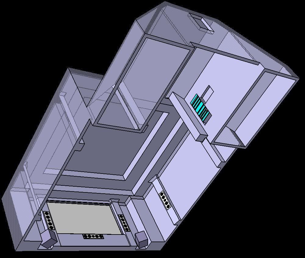

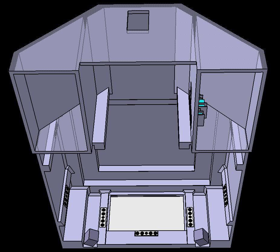

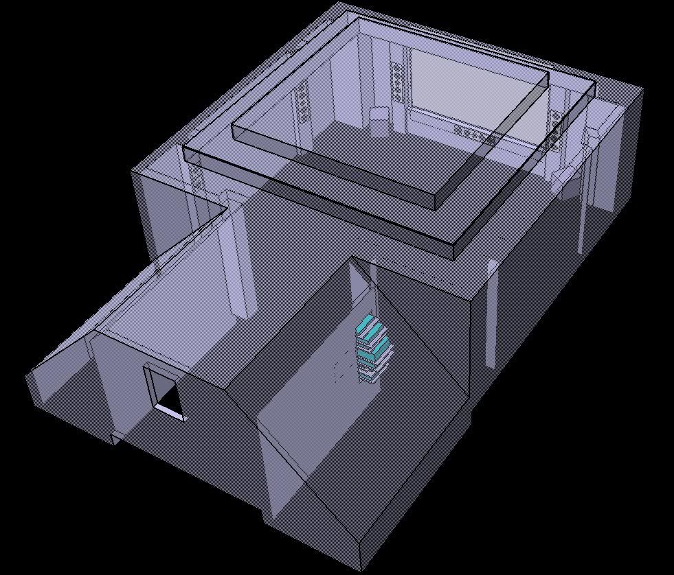

So, onto the bass factor. My original plan was to use the existing sub that I have left from my old living room theater (BIC H-100) and just buy another one to supplement it, but that was when I was on a bit tighter budget. I also don’t think that dual H-100’s will do my new space justice. The new theater is much bigger than my old living room. The subject room is basically a 20’x20’ main area with a double tray ceiling stepping from 8’ to 9’ to 10’, then there is an additional open space behind it that is 10’ x 10’ with an 8’ ceiling. I plan on turning this back space into a bar area. Total volume of everything is 4400 cubic feet if you count the back area. Here are a couple renderings I have done to give you a better idea of the layout:
The areas on either side of the bar will be closets/ storage areas. I will make the right side into my equipment closet.
