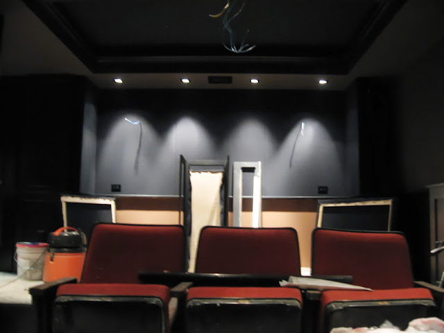

Making some progress; started fabric!
Also got the doors hung:
Used ball bearing hinges on the entrance door (plain hinges on the closets):
The gasketed Zero thresholds also arrived:
And the pièce de résistance:
The fabric has begun! I have all of the frames made for the black fabric. That big one you see sitting on the floor is a binary diffuser (one of three). It will sit in front of the Safe'n'Sound which is spaced 1" off the back wall. I cleared out a room in the basement to work and have everything set up. I just need to steal a few minutes here and there to crank out the rest of the frames. Sure wish I had a nice new set of fabric scissors. I have some nice scissors, but apparently not nice enough.
I've had to ration my spare time between the theater and the rest of the house. With warm weather finally here there's the usual yard work.. and I decided to paint the upstairs where it has endured years of the kids' abuse.
Tim

I've been progressing, mostly doing fabric. Here's a shot of the back wall:
Here's a full column:
Half column:

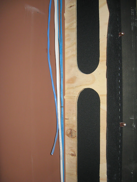

Inside one of the columns:
I wrapped 3/8" plywood with fabric, then those panels are held in with panel retainer clips. That way if something gets ruined I can replace the panel pretty easily.
