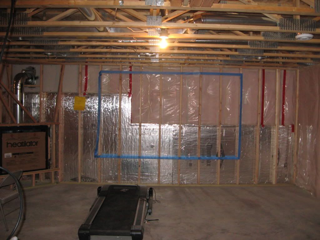

IMAG0553.jpg 1300k .jpg file
IMAG0735.jpg 805k .jpg file
Thanks for all your help.. It would be hard enough trying to figure this out in the UK, but having to do this in a new country makes it even harder given that I am also on a time line as the buidler start on the 22nd :-(

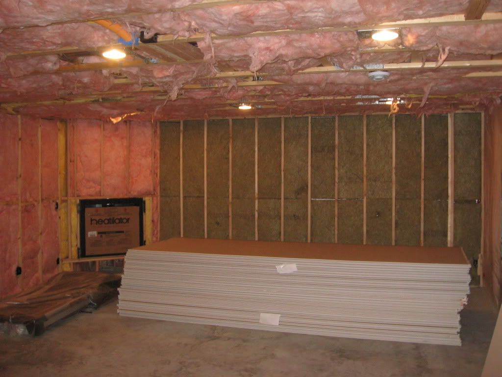

Your other option is to build another interior wall within your room for your outside walls. Meaning you build a seperate interior wall that you would place your speakers in and use something like Roxul Safe And Sound for those interior walls since it will not create moisture:
http://www.roxul.com/residential/products/roxul+safe%27n%27sound%E2%84%A2
I was in a similar situation and here is my main speaker wall. Note the outside wall that is already insulated with vapor barrier. Then note the interior wall I build where the screen and speakers were housed:
The here is the wall with Roxul Safe and Sound before the speakers are installed:
And here are the installed speakers in the wall:

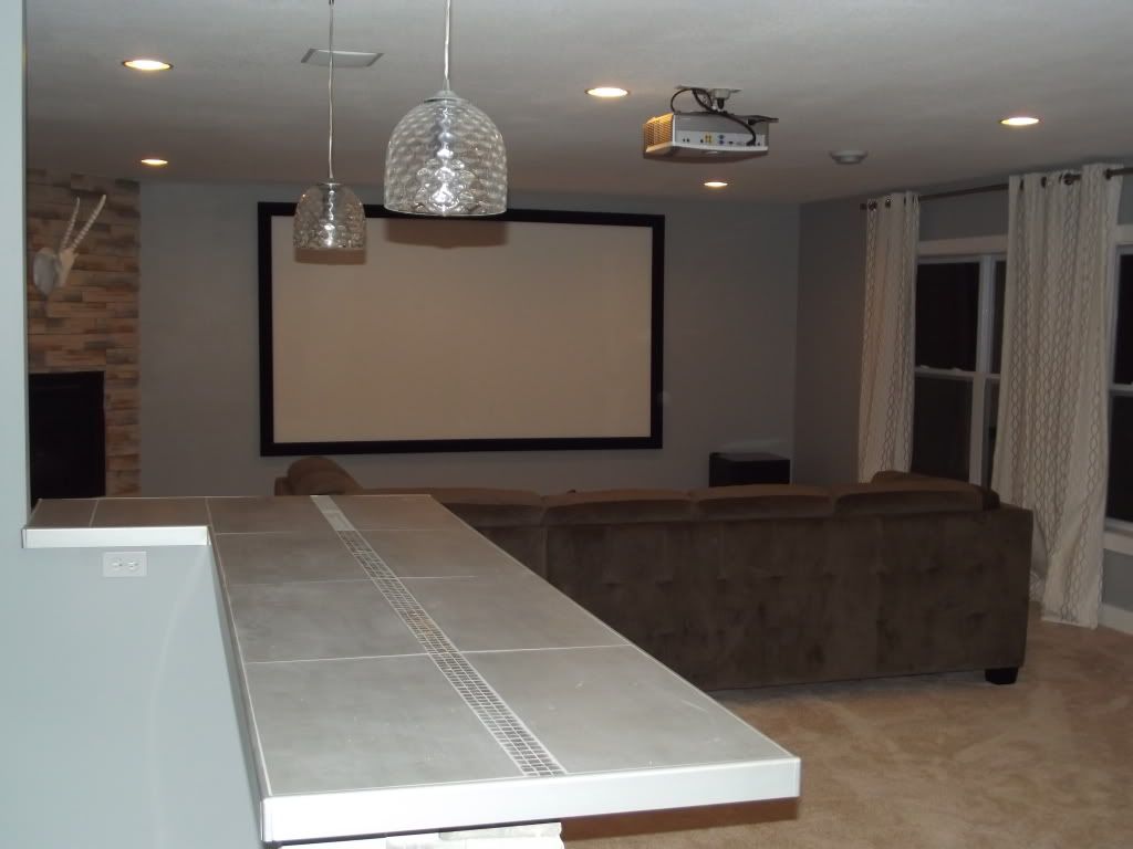

For the back and front exterior walls, I did not build interior walls. For all the exterior walls, there was insulation in place. For the side walls of the house (this is in the basement) I built the interior wall on the speaker/screen side and I also liked the idea of the additional Roxul insulation on the wall that had the fireplace since Roxul is a fire retarder and would buy my family more time to get out of the house in case of a fire.
My media/family room in the basement is large. Roughly 19' wide and 32' long and I do have a bar area and will be adding an airhockey area. I had to go with in-ceiling surrounds and I went with on-wall rears for 7.2 audio. Even if you decide to just go with 5.1 now, I would recommend wiring for 7.2. It is cheap to wire before the room is built vs after smile.gif
I am glad I went with 7 speakers since I watch a lot of Blu-Ray movies and more and more movies seem to have 7.1 tracks. Blu-Ray stats shows roughly 339 movies with 7.1 tracks. It adds some additional ambience and surround sounds, and IMHO is worth the upgrade if your room allows. That said, I would focus my speaker budget on the front three speakers and your subwoofer. This is where the majority of your critical sound will come from. You can always wire for 7.1, do 5.1 now, and add the rear channels as the budget allows.

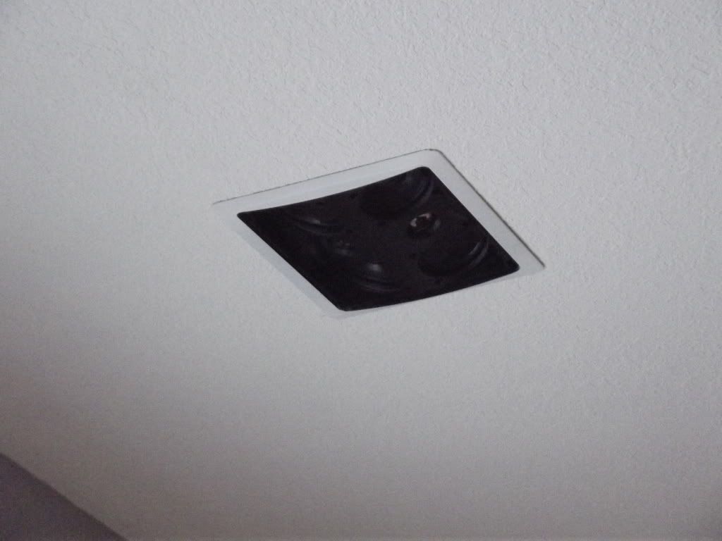

Here are some more pics of my front wall and room to give you an idea. Is this room in your basement?
In this shot you can see the side surround in the ceiling:
And a pic of the Deftech UIW RLS III in-ceiling surround speaker:
