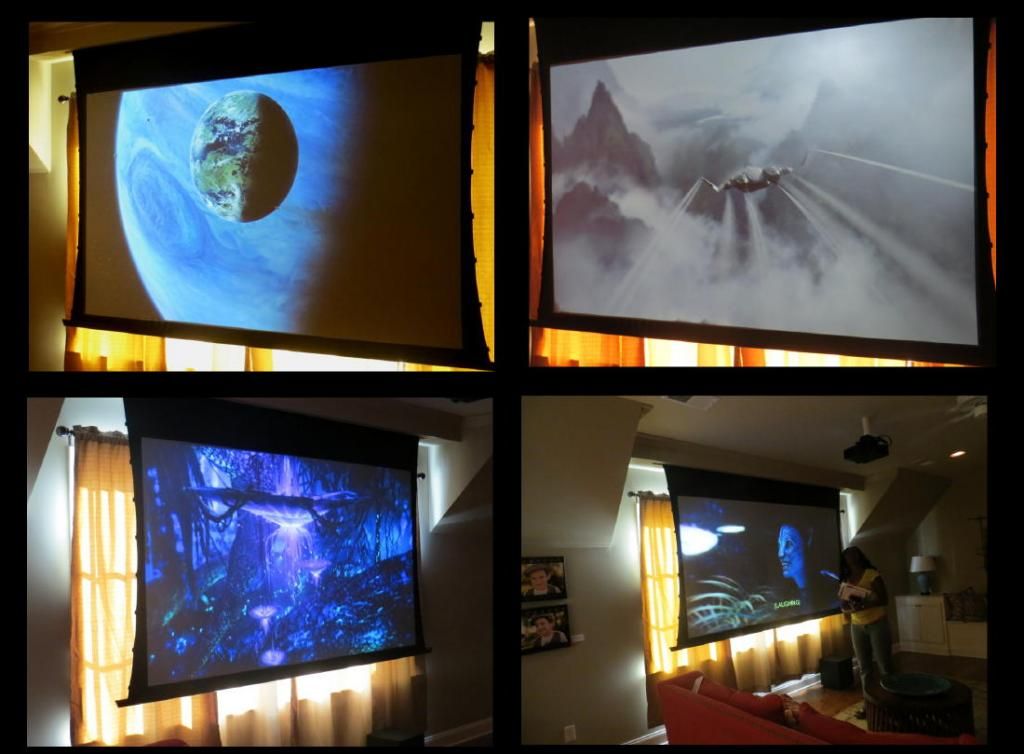

OK....for now, this post will be the last that shows Screen shots showing the performance potential of a re-surfaced Retractable Screen
Mostly, I have chosen examples that show how well Black levels are enhanced...and/or maintained at reasonable levels under ADVERSE lighting conditions.
This first collage shows scenes that incorporate both very light and dark elements, and ambient light primarily coming fom the Window's edges as well as reflections from the left side of the Dormer and the Hardwood Flooring. ( late AM *11:00* with indirect Sun )

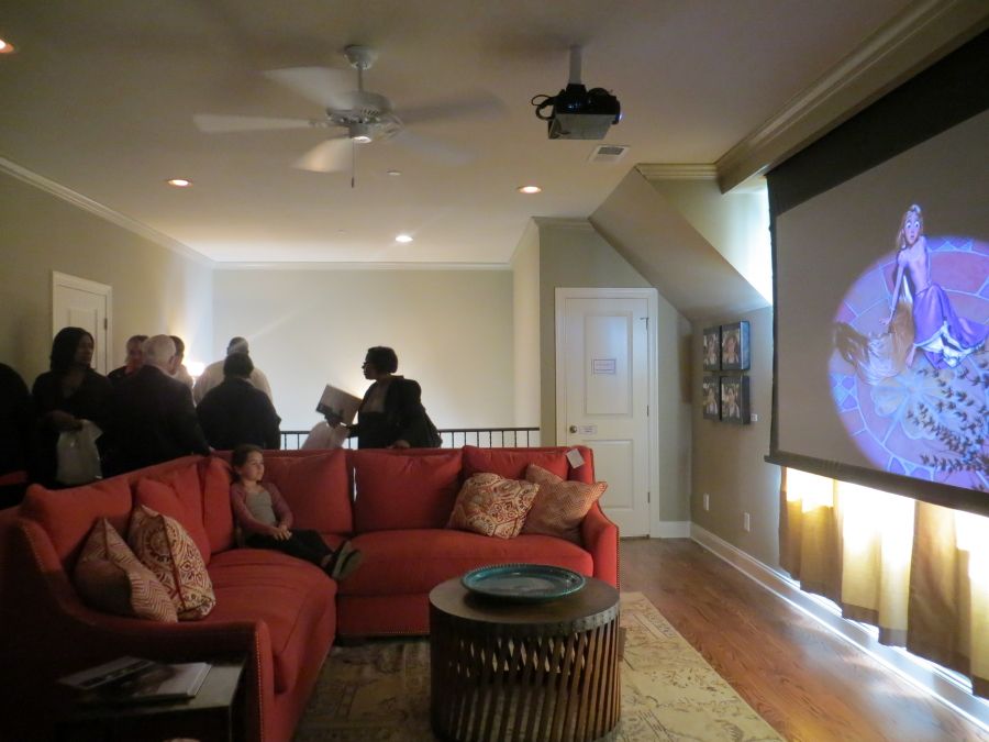

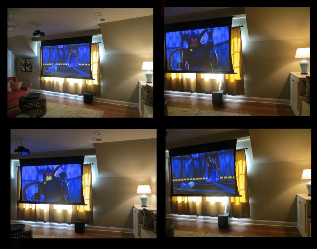

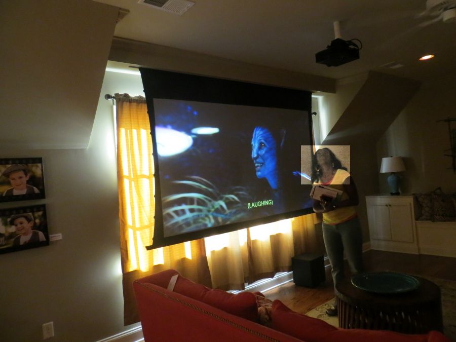

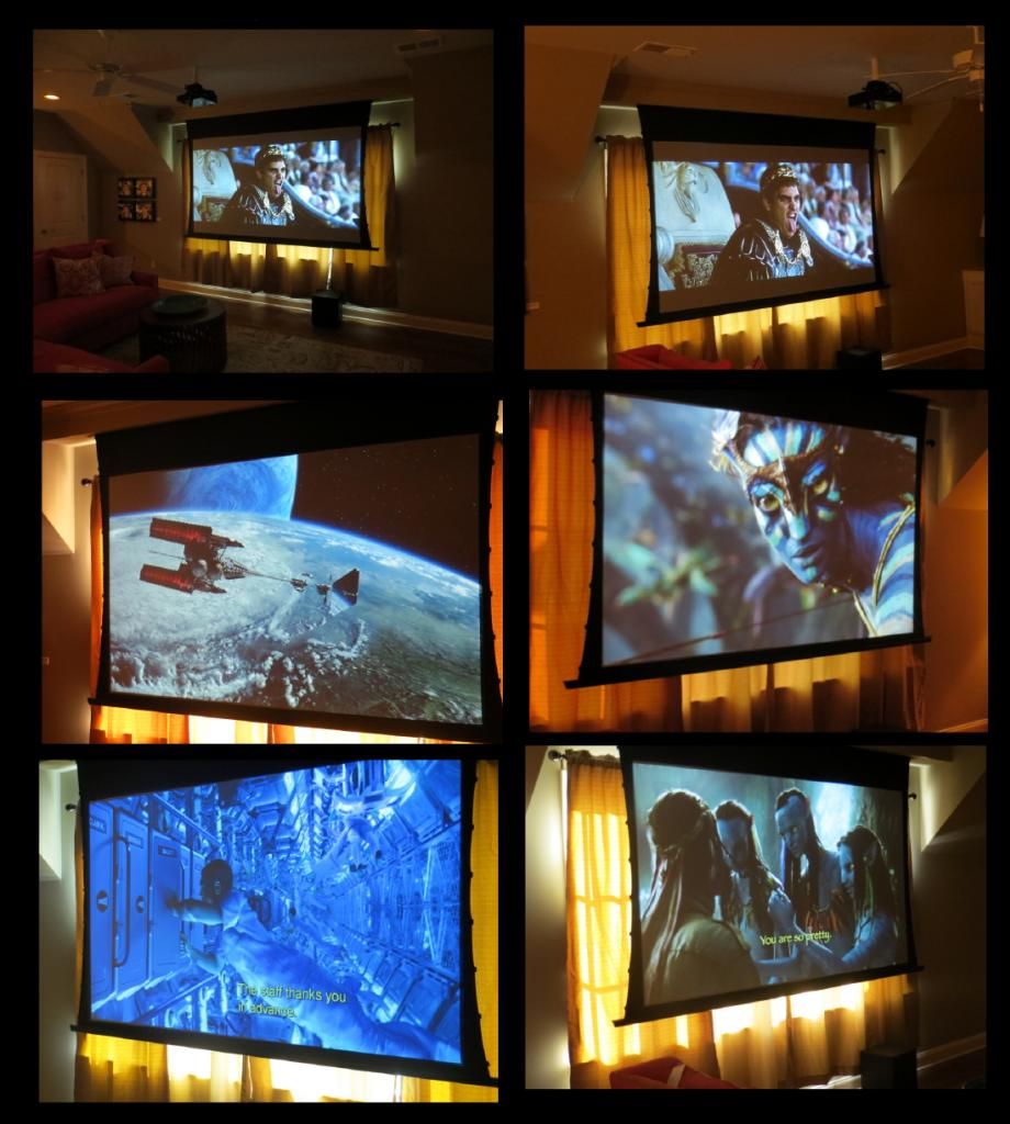

Next up are two collages that show pretty much the most intense amount of ambient light ( direct Sunlight behind Screen ) that is experienced.
The collage directly above is intended to show how adversely a reflective floor / carpet can be. In particular, note the washout along the bottom of the screen, with the areas affected being directly above the bright reflective patterns the Sunlight casts on the polished wood flooring. Wlie not making excuses, such situations are extreme and not to be considered workable for almost any screen application. Yet the results shown are pretty livable with, and if a Throw was placed along the baseboard....? No issues at all. cool.gif

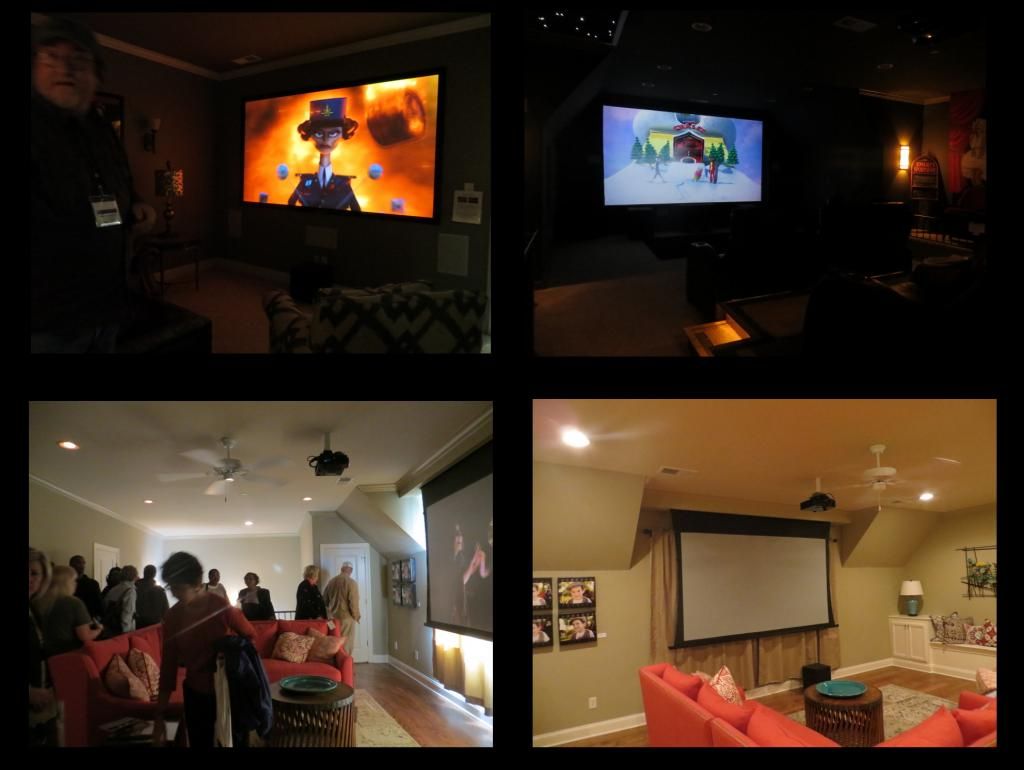

The next collage of shots are intended to show the conditions my erstwhile Peers at the same Show opted to (ie; ...had to...) exhibit their Screens / PJ in.
First up...at top right a 120" diagonal Stewart ST130 set a full 6' back into a recessed hole, hit with a SIMS2 Crystal PJ, and at top left a 92" DaLite w/Panny ae7000u in a totally darkened room (3D was showing) where only light coming from the door (when allowed open) was present.
The bottom shots in the same grouping....on the left, an example of the lighting present in my room 95% of the time. No problems with people tripping over themselves or others. biggrin.gif On the left...another shot of the room under full lighting that shows the decidedly "Non-Dedicated" nature of the room.
Next.....a shot that sums up the wonder and approval of almost every Show goer. I gotta tell ya all sumpthin'.....the "Disappearing Screen" act is hugely popular with all types of people....and especially Wives who to that point had / would never consider a Big Screen in a Family Room, but upon seeing a Window be covered, yet be reclaimable upon demand, would say, "Honey, now that's something I could live with!" But even more so, the number of common, everyday individuals who could innately grasp that they were seeing "The Big Picture" in a non-"Tomb-like" environment, and make comment about such...loudly, made my time spent quite gratifying.
Lastly.....a final shot of the crowd...with a very absorbed show goer. The one downside to showing CGI Movies? Hearing the wails of the children when the parents say "Get up now....we have to go."
