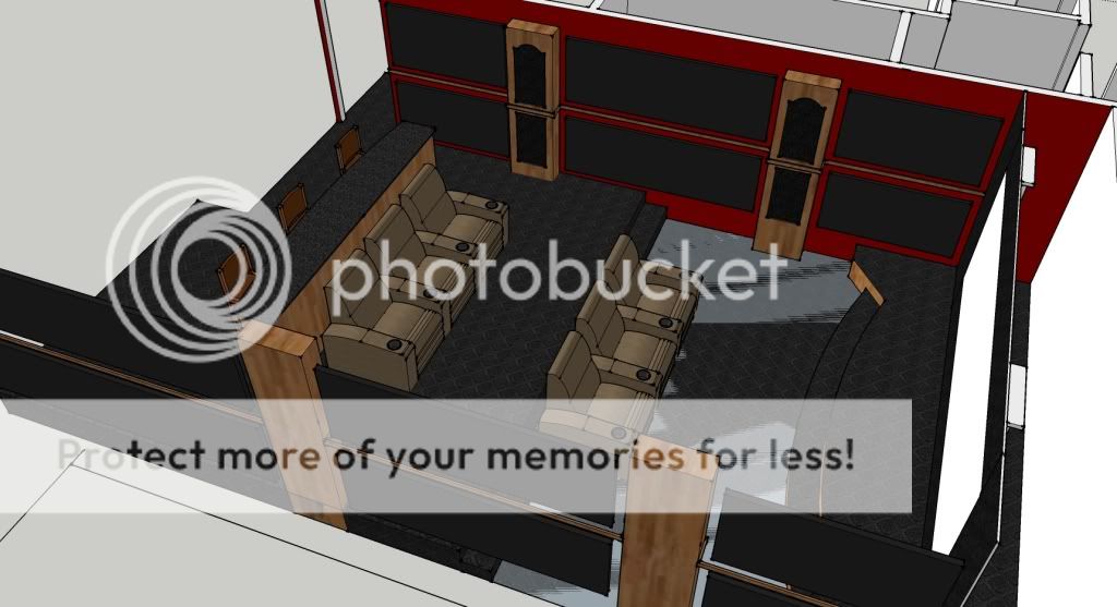

I need to run my conduit and power feed for PJ before I start drywalling, and it occurred to me that I'm not 100% sure where it should go. I'm in the "don't buy the equipment until the end," camp, so I don't have a PJ to test out the throw etc. How do I know where to run my conduit for my HDMI, catX, etc., and where to locate my power outlet for my PJ? I don't want to my mount to cover the power outlet, but I'd like for it all to be near enough that it's fairly hidden. I may add a hushbox down the road, but I'm not planning on it right out of the gate.
For now I'm considering either the Panny AE8000 or the Epson 6010, and I'm planning for a 138" x 64" screen (trying to maximize both 2.35 and 1.78). The top of my 2.35 screen will be at just over 7'-1" (from the floor). I've played with the online calculators, and I think I could put the PJ at 20' from the screen and it would work for both aspect ratios. However, that puts it directly above the bar at the back of the room. I'm not sure if I should try to move it forward or not. With a 15-1/2" riser,I think the PJ will be hanging down pretty low. Should I try to move it forward enough that it falls between the back row of seats and the bar?
Here's a model to give you an idea of my room layout for those of you not familiar with my build.
