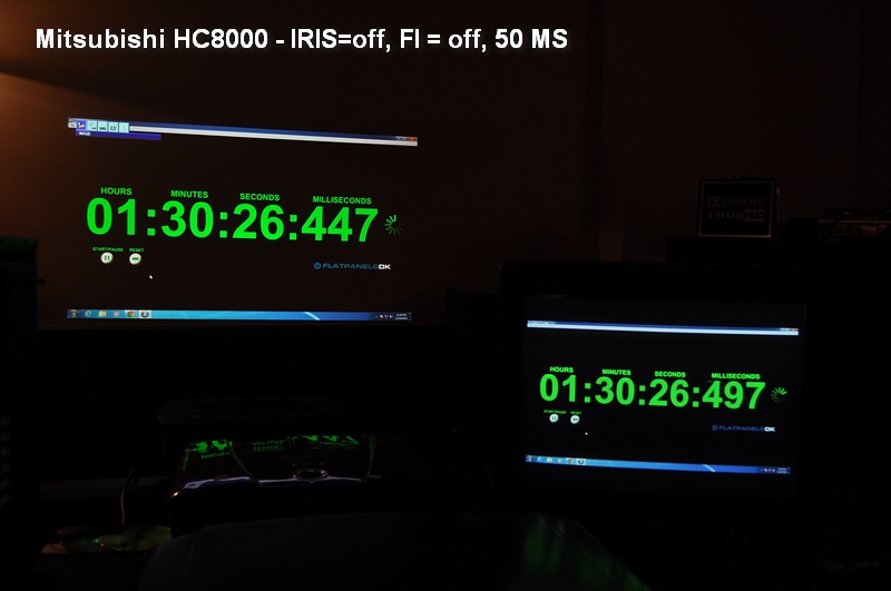

Mitsubishi HC8000 - Game Mode, IRIS = off, FI = off, 50 MS - similar to the W7000.
HC8000-2.jpg[img]

Thanks for the tests, Zombie! The picture of HC8000 got me excited already!
no problem. I really want to test the 3D but still waiting on Mitsubishi to send the transmitter and the 'high speed' shutter glasses.
The 2nd iris has a 'high contrast' setting, it doesn't look adjustable (at least not in the main menu). The light output drops noticeably when this iris in engaged.
