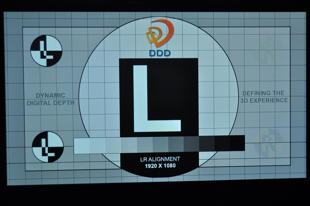

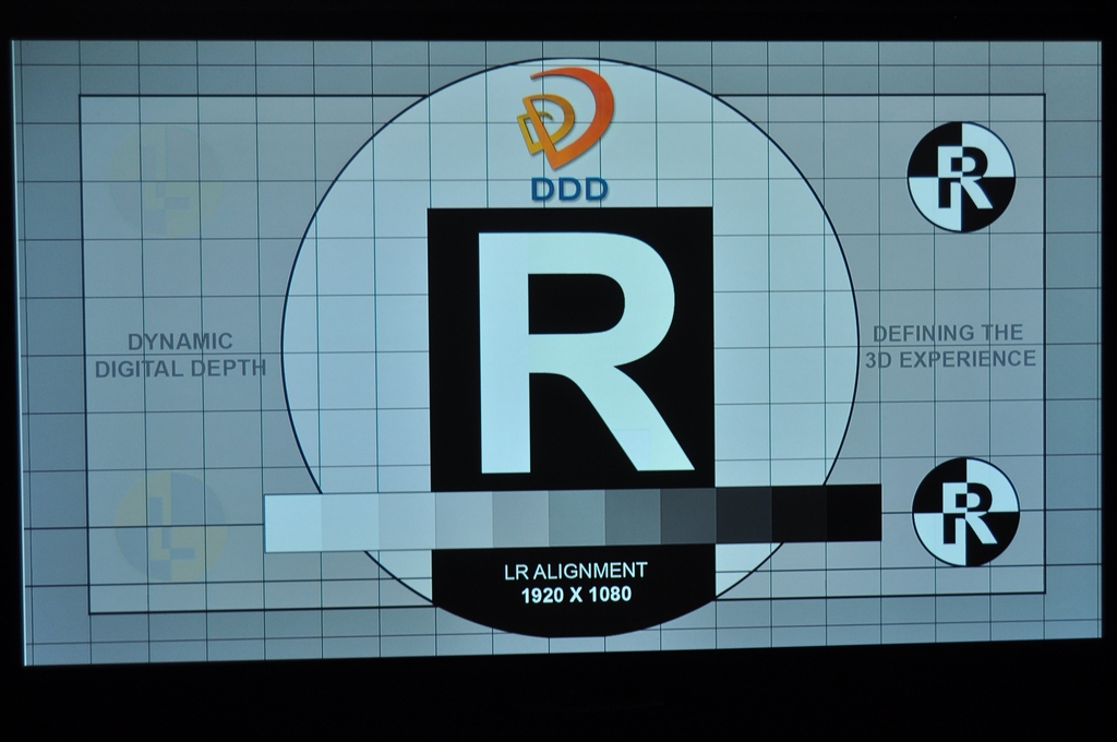

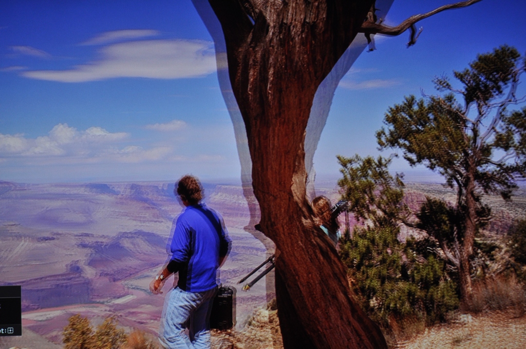

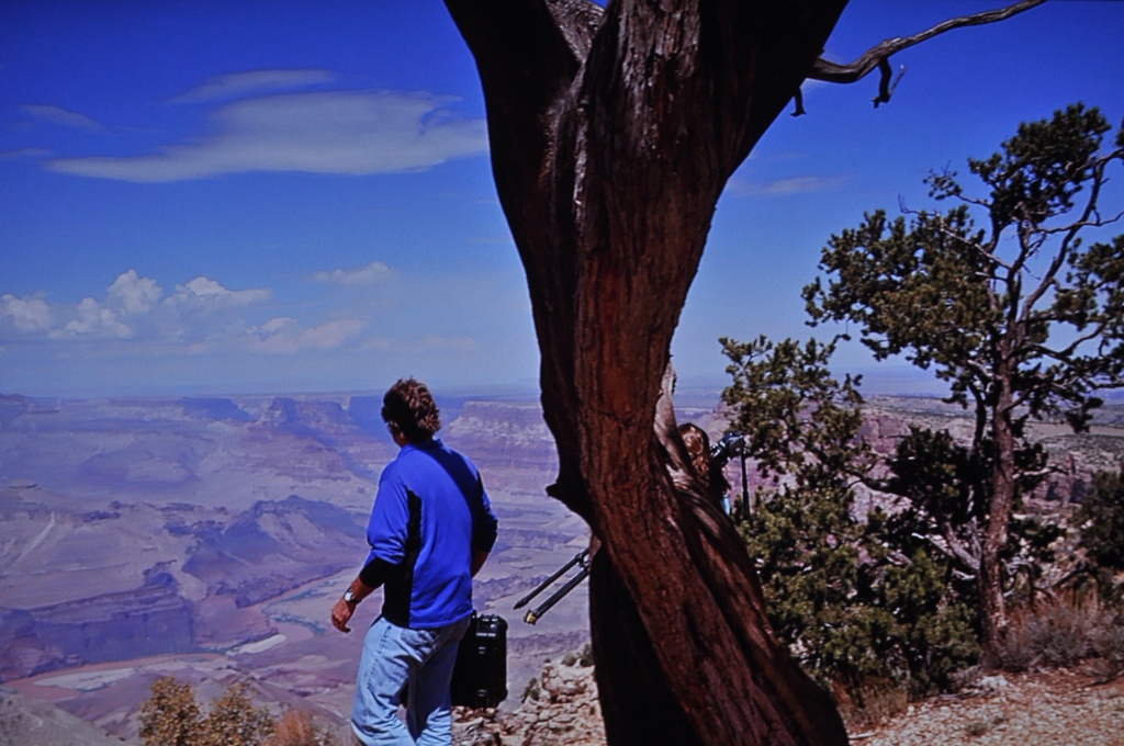

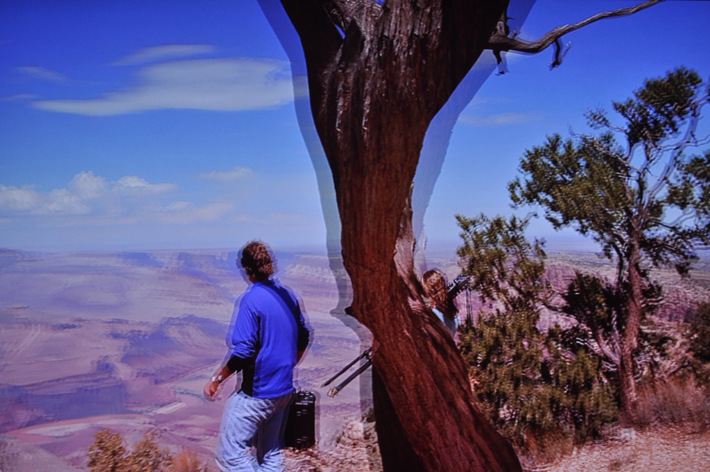

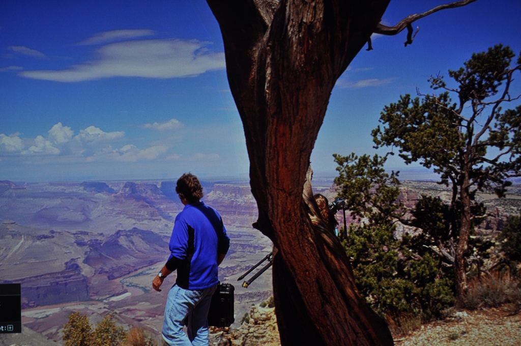

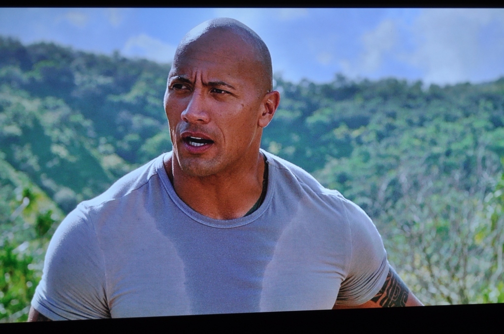

These are some quick A/B between the HW50 and W7000. I lowered the resolution to 30 (factory is 50) and turned on the MPEG noise supression to 'LOW'. Any higher than this resulted in an image that was a bit too soft. Ignore the color differences, the Sony needs a calibration through the glasses which I'll work on later this week.

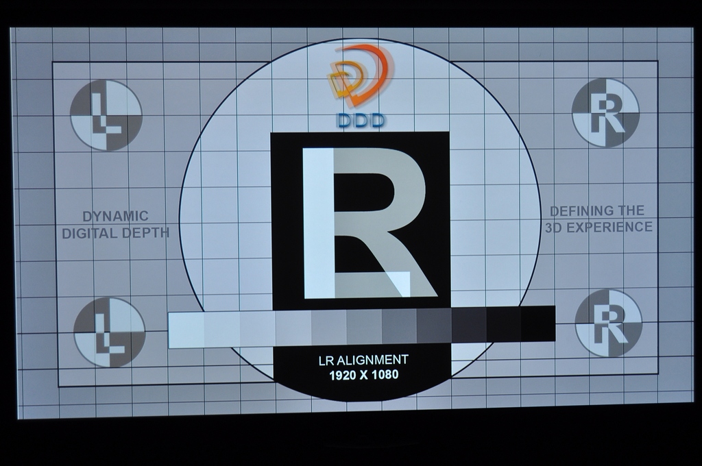

A quick topic to discuss is flicker in 3D mode.. It's well known that DLP refresh is much higher than the LCOS/LCD/SXRD panels and it helps create a solid image that is as easy to watch in 2D as it is in 3D.
The 2 video are from HW50 and W7000. The flicker on the HW50 looks worse in the video than it really issue, but I can definitely detect this with the glasses off and on. In contrast, the W7000 is rock solid. It looks like a 2D image and it's no different when you turn the glasses on. It's very easy on the eyes and 4+ hour 3D sprints is easy on the eyes.
Folks may not be entirely perceive the flicker, but I believe the eyes / brain are subconsciously seeing this refresh and can cause some fatigue when viewing 3D.
Sony HW50, no glasses - L &R 3D pattern - Youtube video link, 9 seconds
BenQ W7000 - no glasses, L&R 3D pattern - Youtube video link, 9 seconds
When going back and forth in these scenes, we can catch some of the flicker in the bright sky. It's more obvious if your moving your eyes around the screen. Most people aren't going to see this, especially if they don't have a frame of reference to compare it to.
BenQ W7000
Sony HW50
HW50 - L &R Patterns with the glasses brightness set to 3
BenQ W7000 - L&R Patterns

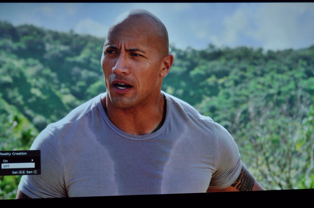

Sony HW50, No glasses
Sony HW50, Factory glasses, brightness = 3
BenQ W7000 - Optoma ZD201
Color noise test

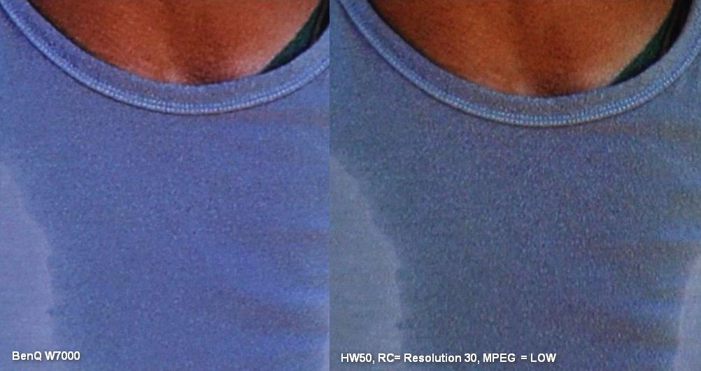

Sony HW50, RC = OFF
Sony HW50, RC = OFF - Lowered resolution to 30 and MPEG noise -> Low. The factory setting @ 50 with MPEG = Off is noticeable sharper, but at the expense of exaggerating some of the noise in the scene.
BenQ W7000
BenQ W7000
Thank you for this comparison. It clearly show DLP's advantage in sharpness over Sony because even without any fancy sharpening algorithms it looks as sharp as Sony HW50 with RC on.

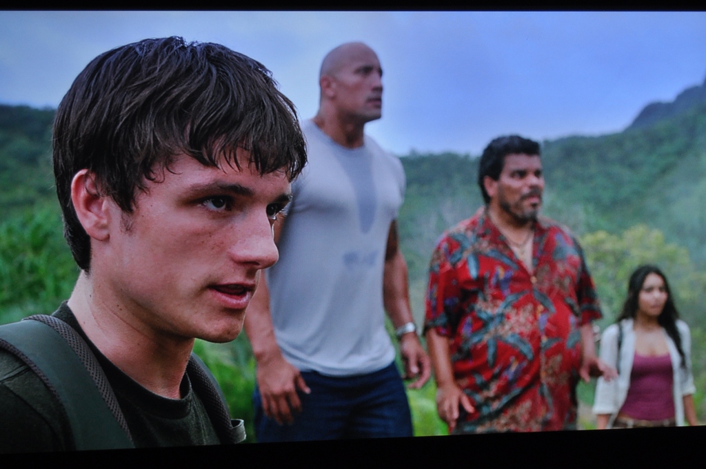

Also in the "Journey" shots... are these from behind the glasses? if so i am noticing the RC menu looks a bit out of focus. Would it be possible in the futre to show a static menu in each fram to give a focus reference for both images. The glasses themselves may not be perfectly aligned in each shot either.

I am holding the glasses straight as I have a small 18-55 lens I use that allows me to center it with relative ease. (the Journey shots are through the glasses). This is a good 3D disk to use since the overall video quality is excellent.

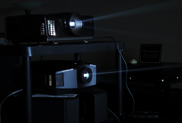

The stack setup is working great, I'm using the dual output of the Denon 4311. (even 3D sync works perfect) I have a small box I am using that is lined with black velvet and works great for blocking each lens during the A/B comparisons.
