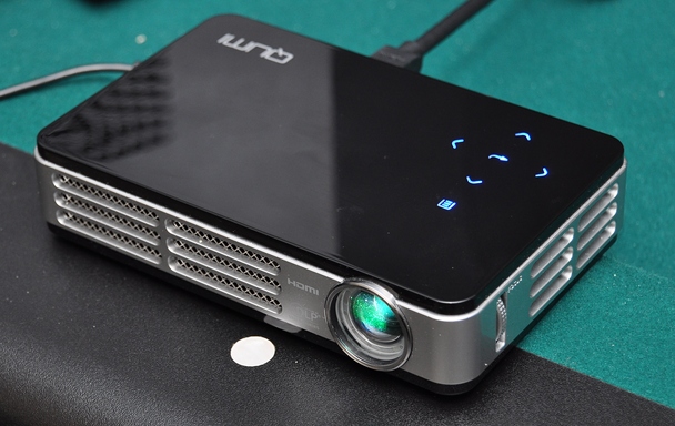

I still use my little LED DLP for watching a quick HDTV show. Centered on the HP, it's watchable for TV. One time I left it on all night.. oh well.. smile.gif
I been debating on another LED projector, but I just can't pull the trigger on one for a 3rd, everyday projector. After having one, I don't think its worth it. I just might grab one of the Acers or Benq with the extra long eco bulb that is 6000-7000hrs, they are much brighter, 1080p, and a much better picture. With a 2nd lamp, it should last me 10hrs, if I don't get rid of it. I figure I will only use it 5 days a week for an average of 3-5 hours a day.
