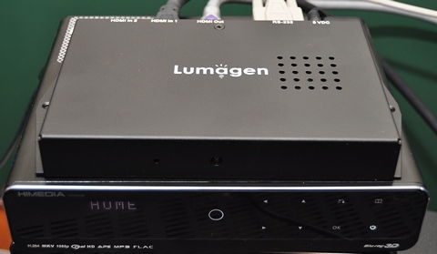

I was using FreeNAS but I recently switched over to a dedicated hardware RAID setup. I'm at ~70% of the 17TB capacity.
The Hi-Media900B is still around. It's an identical version of the Mica 950, they can exchange firmware. I have players from both companies.
There is also the MED1000X3D which is gaining popularity. This the next one I am going to check out. Though they couldn't have picked a stranger shape for a media device..
These players aren't perfect, but they serve the exact function I am looking for. Instant, random access playback of my 2D and 3D BD library. My bluray players feel archaic in comparison. cool.gif
