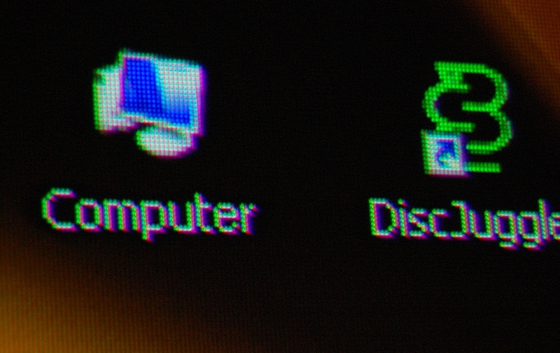

Yah, I noticed on both a Sanyo z4000 and an Epson 8700ub and an Epson 5010 that when I see a closeup of a face in certain angles, the image appears slightly less flat than the JVC and even than most DLP's. The problem is on distant shots the effect works backwards (LCD looks worse on scenery and distant shots IMO in general). The higher pixel fill does occasionally make the image almost seem to sparkle and come off the screen a bit more (but it also does look more digital and less film-like). I am not saying the worse pixel fill is an advantage, overall I'd say it's a slight disadvantage, but it does at times have a small net effect to POP. I think this is why some people like the 8700ub or 5010 over the JVC even for 2D, I can respect that, but I don't know it depends what you are watching. Pixel fill makes almost no difference in dark scenes, it is too hard to see, it's only in brighter scenes it really matters.
The Epson 5010 is pretty darn good in 2D, but the only thing I don't like about it is still the crazy convergence randomness (and the inconsistency of POP from POPPY to FLAT and back and forth). It is much better than the 8500ub's game of russian roulette convergence, but the 5010 still has too many units slipping through the cracks with bad convergence.

Convergence is the alignment of the Red / Green / Blue panels within a 3 panel projector (Sony, Epson, JVC, etc). As an example - when the convergence is good, the computer text in this image should appear white.
This is my old Mitsubishi HC5500 which had some convergence issues. This projector was not adjustable, so there's not much that can be done about it. The 5020 allows 'zone' based convergence correction which allows the end user to make adjustments across the entire screen in the attempt to correct any misalignment from the factory. Ideally, all the projectors would be have very close convergence from the factory, but we've seen side variances from copy to copy.
post #540 of 4154
Thanks for that. That's why dlps look so sharp. No 3 panels to align. Just didn't know the term.
