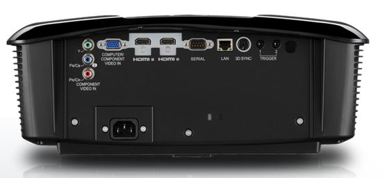

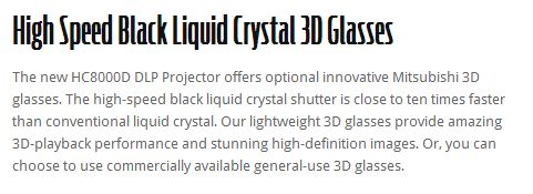

I spent a few hours today doing a full calibration of the HW50 in 2D and 3D. it's looks great overall and is a nice improvement vs. the previous HW30.
I'm curious to see the 3D glasses that are designed for the HC8000. It also looks like it has the 3D port for hooking up external transmitters. I'll check and see if the MV3D's work with it.
