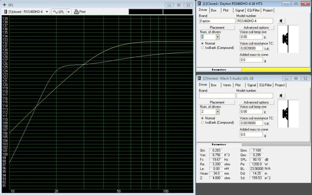

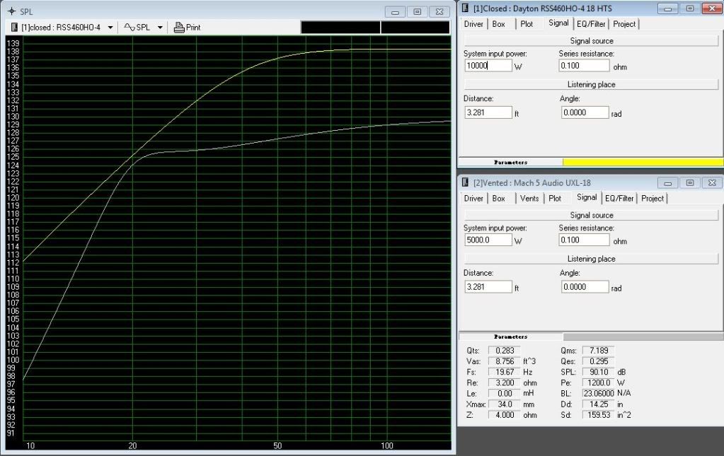

Here is my best guess as to how (2) Dual opposed Dayton cabinets will perform compared to the Caps.
Comparison of (4) dayton drivers in 14 cubes vs. 2 UXL-18's, ported, in 16 total cubes tuned to 19hz. Both being fed 5000 watts. It takes >30hz for the Daytons to really take over. Man, that port really adds a lot of efficiency around 20hz!
NOW - moving to eight drivers and 10,000 watts, and assuming co-location...it's a total domination in favor of the Daytons below and above 20hz....BUT we're also talking 28 cubic feet of enclosures, and TWICE the power lol. If I subtract out 6 DB or so from not being co-located, I don't think I'm going to be gaining a whole lot >20hz. frown.gif I know my original goal was to pick up some <20hz content, but not if it means it will come at the expense of midbass slam.
Am I going to have to remove a wall and go to 16 drivers?? LOL!

gorilla, your model looks to be right and i've been noodling it around because something in my intuition wasn't jiving with the numbers on the screen. that driver has a pe rating of 1200 watts. if you are going to dump 5000 watts into a driver that is 0.5% efficient, you will need to figure out what to do with the 4975 watts that are being turned into heat around the tuning frequency. at the tuning frequency, driver motion is very low too in a ported design, so very limited air cooling. room heaters are 1500 watts or so, so the amount of heat building up in the coil at 4975 watts would be like three room heaters with no fans on them. that's going to cook the coils in relatively short order.
the b&c21 with a 6" coil and is designed for maximum cooling in a pro audio setting doesn't even have a 5kw rating. it is rated at 4w. i forget if the uxl has a 4" coil or smaller, but even at 4", that would translate to something more like 2600 watts if it had the same kind of cooling tech in the b&c, which it does not.

Ltd - the Uxl model above depicts 2 drivers which would be 2500 per which is still well over thier rated capacity. I was just trying to predict (by best guess) how the ported caps would model in a similar scenario with typical driver characteristics. I know I'm still a bit off, but it was just more of me thinking out loud. Bah.

It sure looks that way, but I'm pretty sure your graph assumes the port doesn't compress or change behavior all the way on up to 124dB @ 1m. I'll go out on a limb and suggest that's a bit optimistic. wink.gif
One of the big trade offs which is always tricky to decide on is the efficiency of the larger box and port vs. dynamic linearity of the sealed system which doesn't compress or change response shape as dramatically until you get a good bit past Xmax. With the port, you can pretty well expect that compression starts to be observed to some degree with air velocities above ~10m/s, with very obvious compression at the point your ideal model hits about 30m/s. Along with airflow and excursion issues, the benefit of less power/current per voice coil is another benefit to multiple sealed drivers. Both approaches have their applications, but once you set some upper limit on box volume but are willing/able to add power or drivers, the sealed option can look more and more attractive. Obviously a sealed design will also be more straight forward in construction and build for a custom project, while also having higher confidence in the end result.
Below 25-30Hz you can almost certainly count on effective coupling between drivers in the room, ie double the drivers producing equal level = +6dB.

"Ltd - the Uxl model above depicts 2 drivers which would be 2500 per which is still well over thier rated capacity. I was just trying to predict (by best guess) how the ported caps would model in a similar scenario with typical driver characteristics. I know I'm still a bit off, but it was just more of me thinking out loud. Bah."
ah, not sure how i missed that. still seems a little rich, but obviously no where near as bad 5kw through 1 driver that i thought you were talking about.
post #204 of 994
There's always something to consider that's not always obvious in the models and you've shed some light on the compression aspects which I'd overlooked. Great input once again Mark, thank you.
"Ltd - the Uxl model above depicts 2 drivers which would be 2500 per which is still well over their rated capacity. I was just trying to predict (by best guess) how the ported caps would model in a similar scenario with typical driver characteristics. I know I'm still a bit off, but it was just more of me thinking out loud. Bah."
Agreed, they're still overloaded. The Caps are rated to 4k watts RMS so I figured modeling these guys with 2500 or so should be somewhat 'close' to what I had graphed - although I knew I was overlooking something like not considering compression as Mark pointed out above. biggrin.gif
