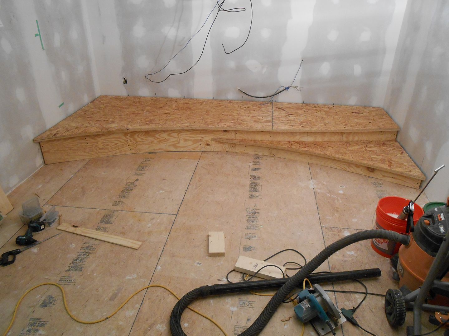

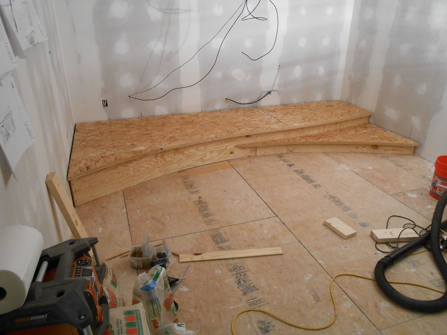

Finished framing the stage and riser, sand delivered , picked up the OSB, developed a wiring strategy, Started filling the stage with sand. Did I mention we had sliders from White Castle for lunch. It's probably been a decade since I savored that Delicacy.
Vikgrao and I tweaked the stage design and returned it closer to the inspiration photo roots.
Here is the result
I should point out that every board was a different length and needed to be cut at a different angle.
Vikgrao passed the AVS Theater Builder Official Rite of Passage by carrying over a ton of sand into the theater
Some shots of the finished riser steps
Edited by BIGmouthinDC - 11/5/12 at 7:36pm

You've already missed an opportunity to carry the sand, how about helping paint the ceiling black? We welcome volunteer labor.
post #39 of 983
Cool! Both the stage and riser have an artistic difference to them that really sets them apart.
post #40 of 983
Did Dennis supply the measurements in the drawing, or was that something you had to work out on site?
post #41 of 983
The curve was changed significantly from Dennis's sketch. but lengths and angles need to be determined on-site irregardless.

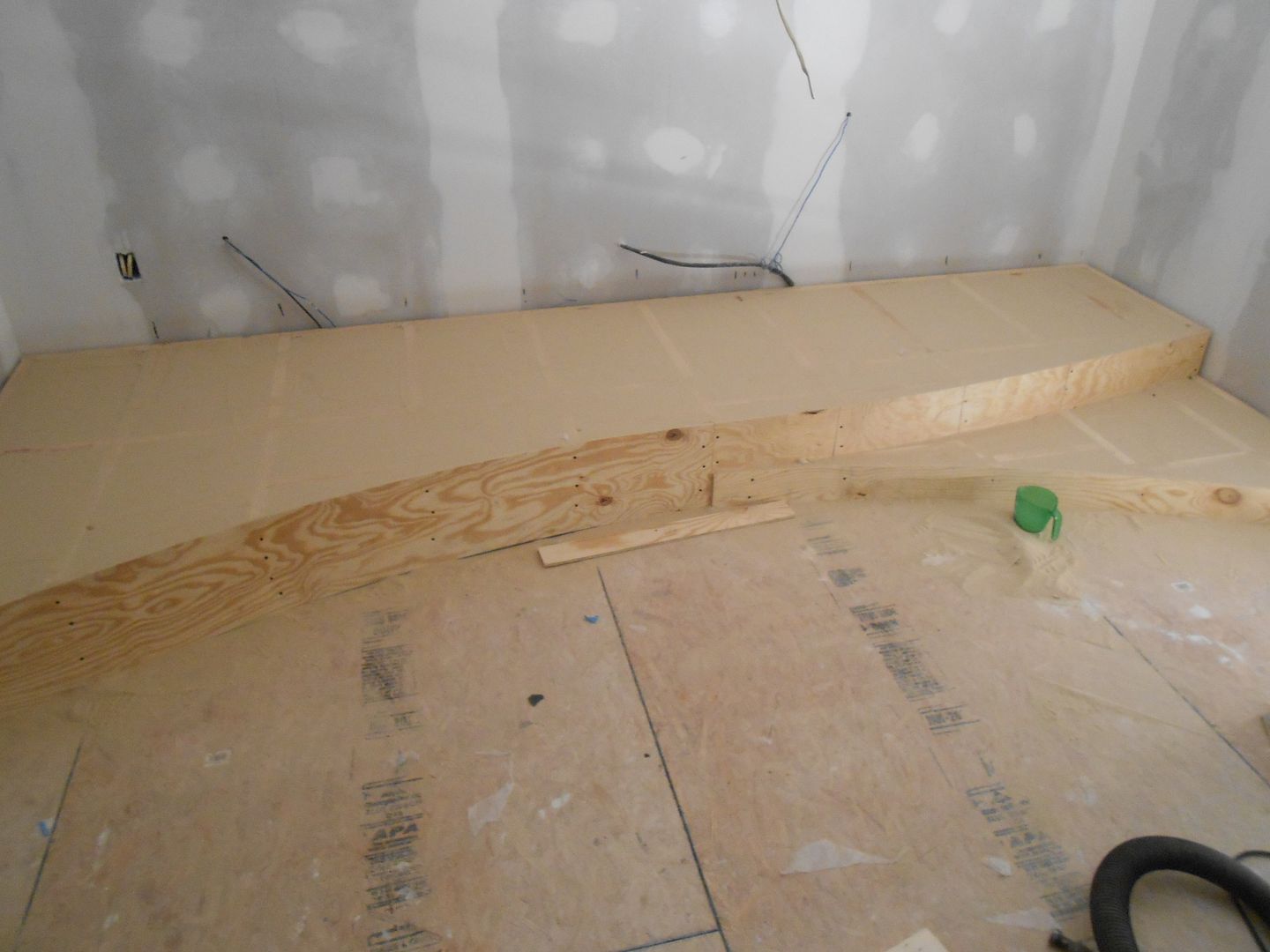

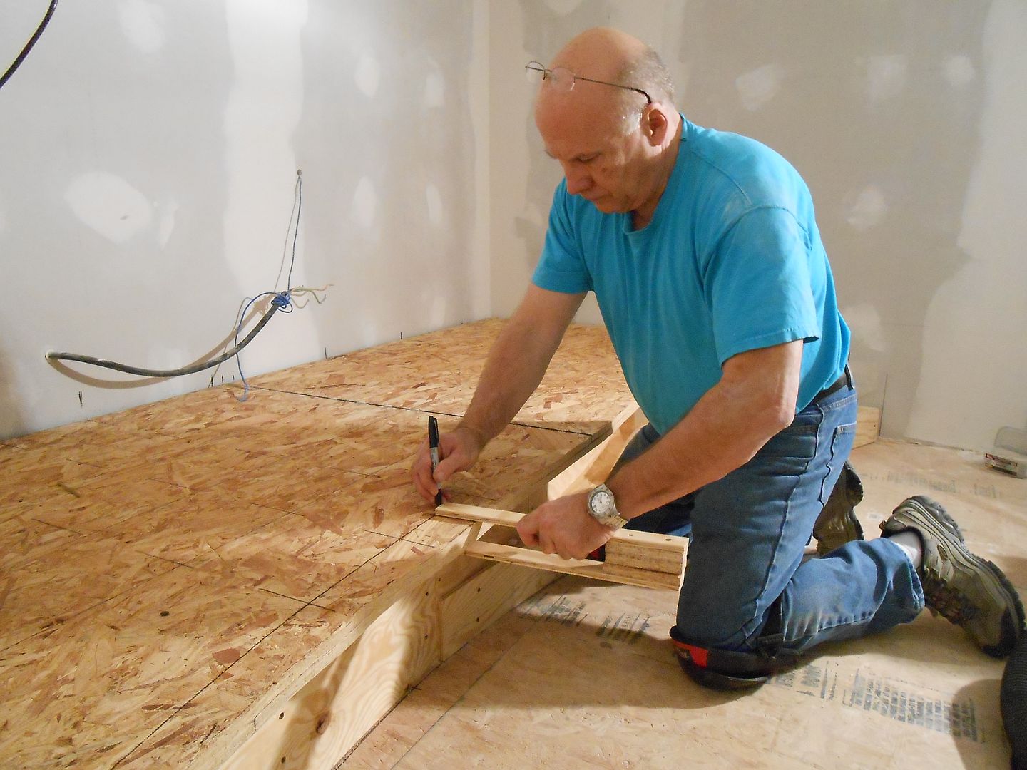

Worked continued today but I swear with all the curves and special tweaks we are incorporating into the project it seams like everything is taking three times longer. This morning we finished filling 100% of the stage with sand, not just the big areas, but every nook and cranny got lined with plastic and filled with dry play sand
Then the decking went on. Three layers of 5/8 OSB with green glue between layers.
Then the curves needed to be cut after drawing the overhang with my special edge drawing tool.
Vikgrao wanted a special edge treatment to hide the rope lights that will remain a secret until it is proven. But it required that the first layer be cut at a different overhang than the others, did I mention three times longer?
We finally buttoned up the asymmetrical two level stage.
All for tonight, I think Vikgrao has some pictures on his camera.

Do you endeavor to keep GG away from the edge to avoid getting it on your blade, or is that a non-issue?
post #44 of 983
Wow, the way Big worked today and everyday since he came made me realize what sets him apart from other home theater builders who i encountered previously at my friends builds. Big does not just build home theaters because he is getting paid to do it. He does it out of pure passion and literally treats every build like he is building his own theater. His Obsession for detail and the wealth of knowledge he displays when describing the scientific principle behind every little thing he is doing is amazing! The best part is he is like a one man army with amazing cardio! Just to keep up with the pace at which he works all day is not easy. I am really glad i got the opportunity to have Big build my theater!!
post #45 of 983
You try your best to keep it away from the edges. But even if you fail the blades seam to be self cleaning when GG is in a liquid state, hands not so much. I have a pair of shoes with waffle treads that got so gummed up from sloppy guest workers (puddles everywhere) that I save for hanging drywall day.

Forgot to post this!...Big disappearing under the heavy OSB earlier this week for tracing the curves of the stage. smile.gif
post #60 of 983
Looks like napping on the job to me - ha!
