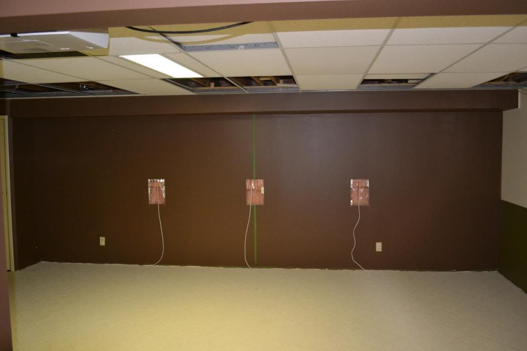

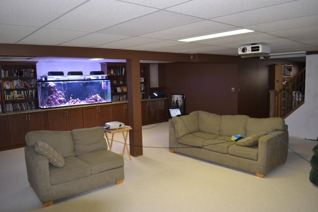

The first thing I did was rotate the room 90 degrees, it always felt weird to have our backs to the staircase.

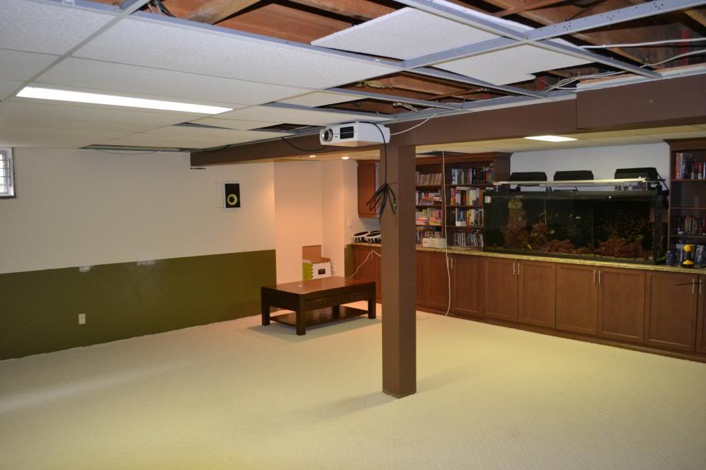

Rehung the projector:
Cut holes in the walls, and run speaker wire, here's how bad the basement is constructed, the vapor barrier is not sealed at the top of that bulk head so I'm not sure why they even bothered to put it in there. so running
the wires in that wall was actually pretty easy, ran my tape up the wall and it popped out over my head.

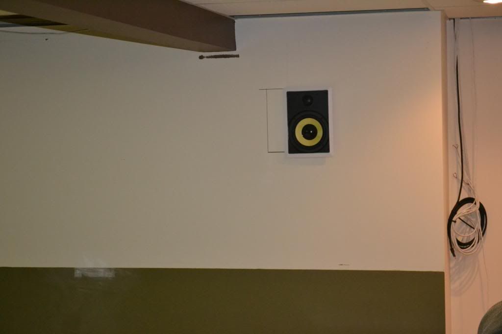

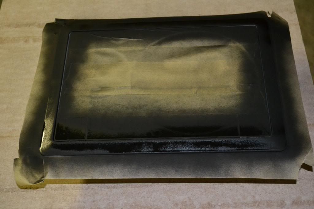

Painted the LCR frames and covers. I have to redo one of the covers, I'm not sure what was on it to have it turn out like that.

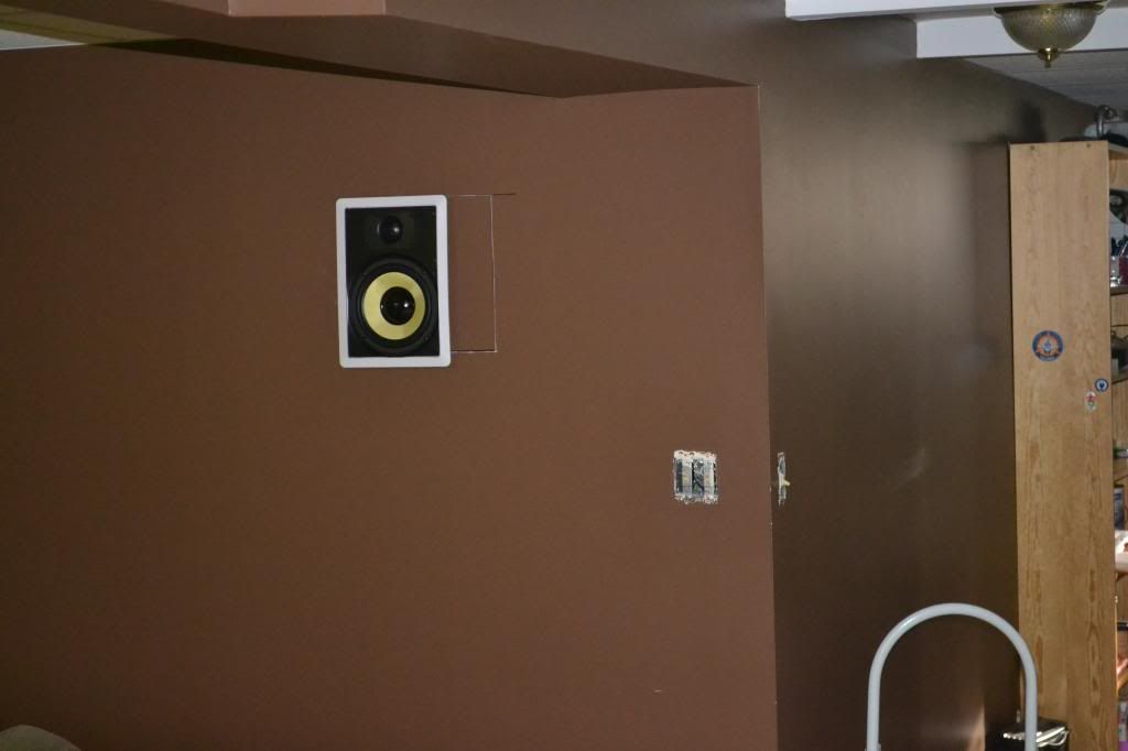

Installed the side surrounds ( temporarily, they aren't tightened down, they need to come out to refinish the wall.

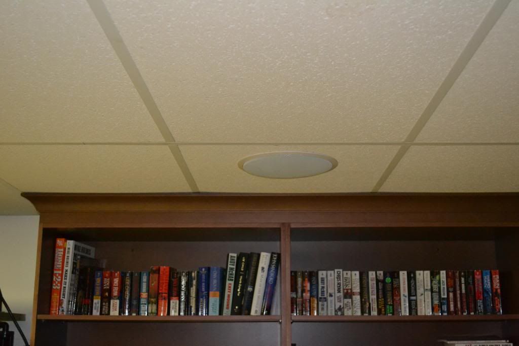

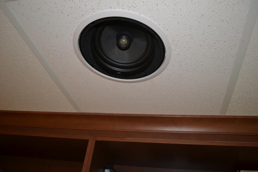

Installed and wired the rear surrounds:

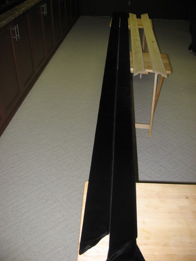

Built a frame for the AT material:
Mounted the material with Binder Clips, it works very well:
