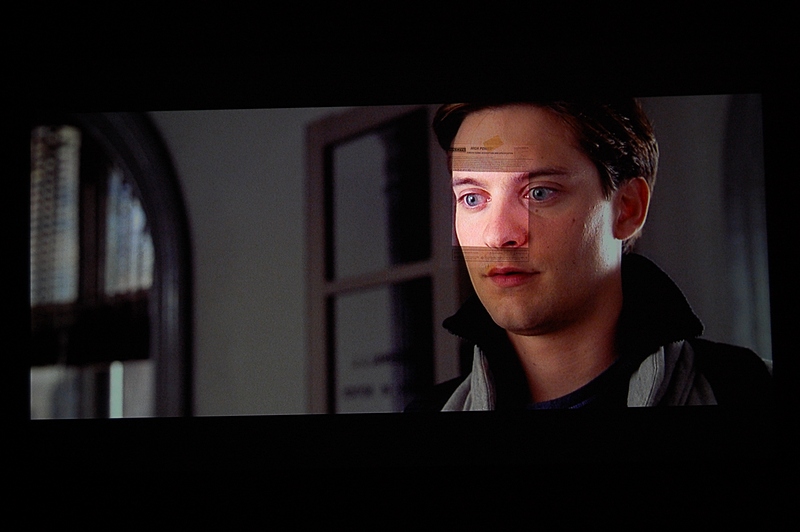

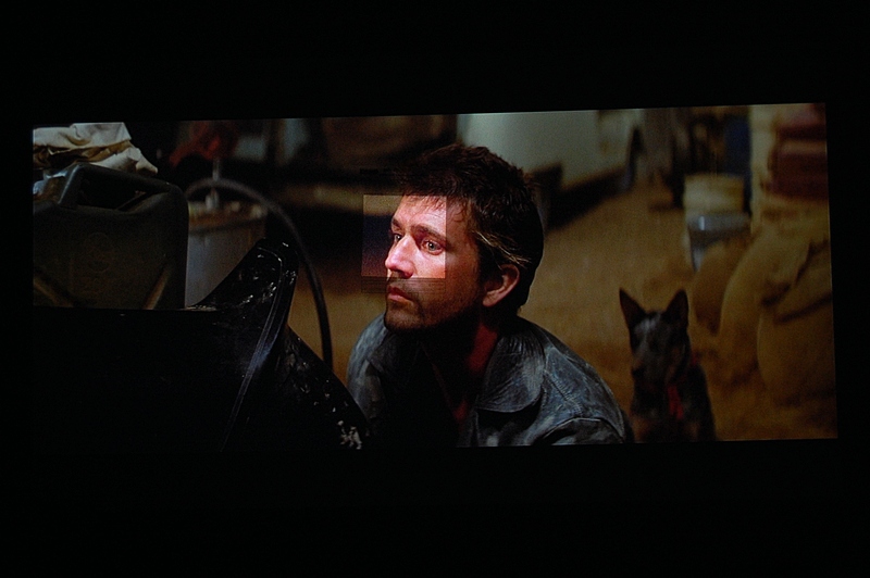

This is a sample of the HP material (the older 2.8 vs. current 2.4) on a 1.0 gain screen. If you search the HP thread in the screen forum, you'll find it's one of the preferred screens for 3D. Mine is the 2.8HP @ 142" 16:9 and 3D looks excellent with ~ 1000 lumens in 3D.
Sorry got a little confusded. These images you have with a small (brighter)square in the middle: is it showing difference in between HP 2.8 vs HP 2.4 or HP vs non HP?
