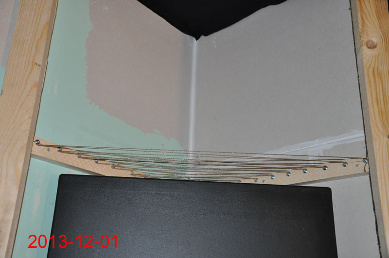

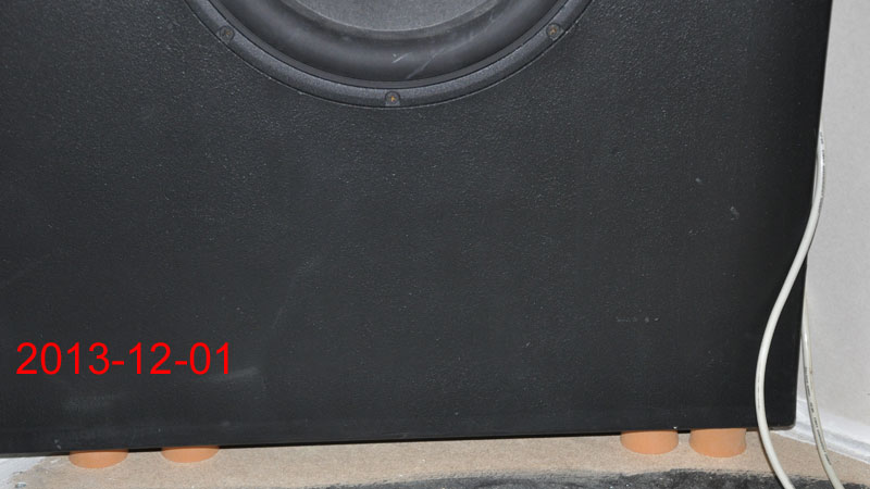

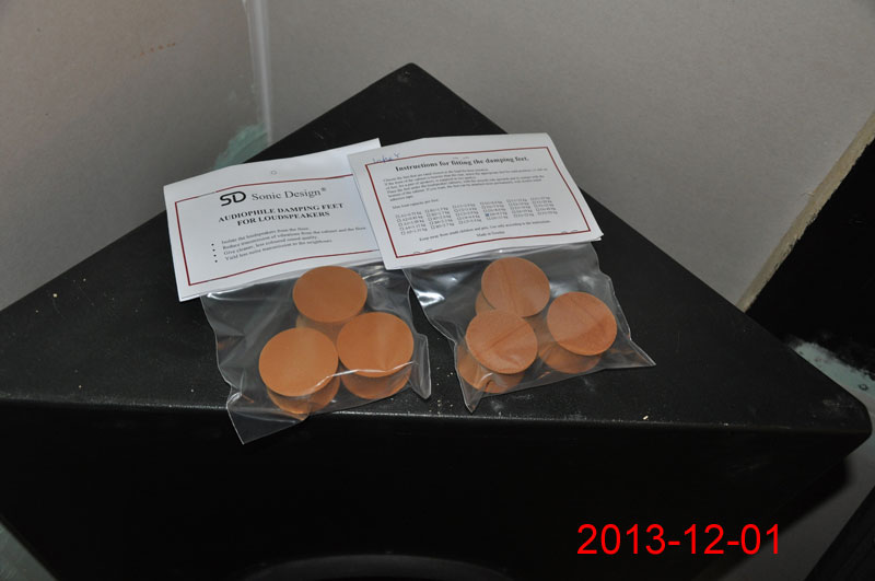

A couple of packages of weight-matched soft feet. Two packs as the subwoofers will be stacked.

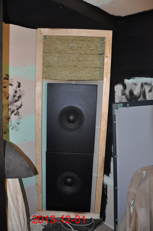

This is where they end up, of course
One string shelf made
And insulation going on top
And if it isn't obvious, there's about half and inch of clearance between subs and walls so they can theoretically move freely on the feet even if they don't (above 3-4 Hz or so).

post #320 of 380
Does anything go between the two speakers to stop vibrations or the top one from walking?
post #321 of 380
No. Had one introduced something elastic there, then the whole systems resonance frequency would have changed for the worse. I'm never had (or heard anyone else having) an issue of walking subs in this weight category so I will claim that friction is more than enough to prevent that.
