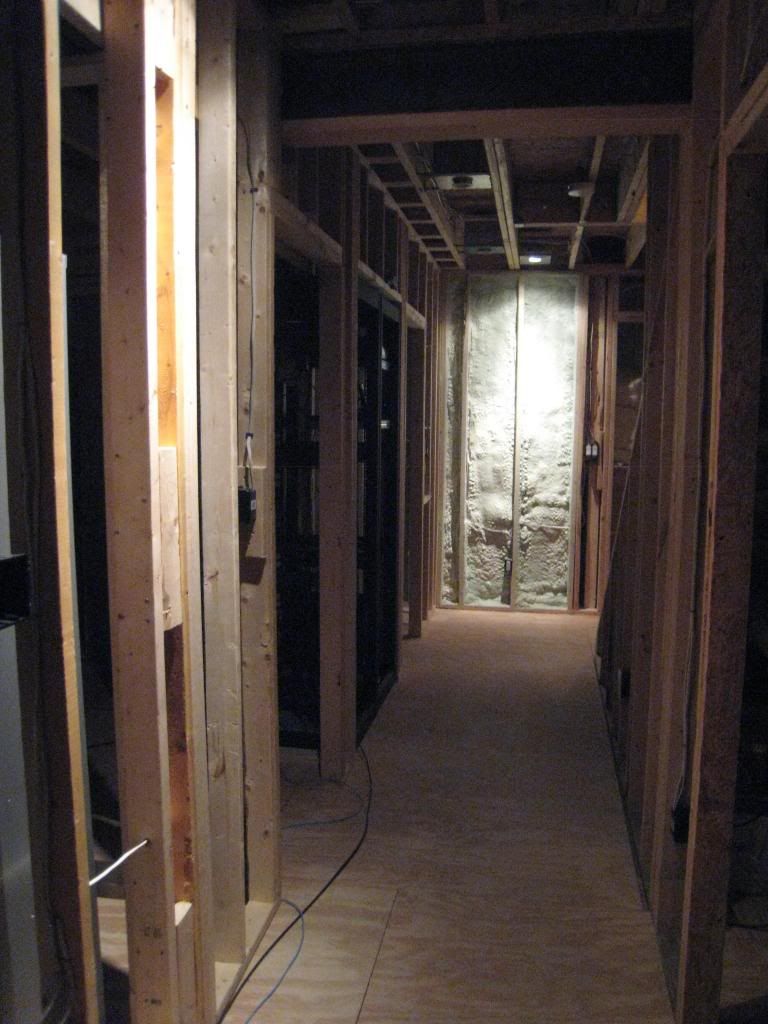

A bit overdue for an update, but here it is. I've been busy working on everything in the basement BUT the Stonewater Cinema. It's been a lot of work and I have a bit more to go, but I am finally seeing the light at the end of the tunnel and quickly reaching the point where I can focus 100% of my construction efforts on the theater. Unfortunately things will not be finished by Thanksgiving because the drywallers I contracted pushed me to a different date in early December because of scheduling conflicts. They normally do drywall for big builders and were fitting me in where they could as per our arrangement. I would've been upset with this except for the fact I got a call two weeks ago that our carpet selection is on backorder until mid-December. We looked at other selections, but in the end stuck with our original choice. New date to finish everything in the basement is by the end of the year. I can't wait to get it done and off my "to-do" list so 100% of my focus can be put back on the theater.
I simply have too many pictures to post, so I will parse things out the best I can over the next week.
First, we have light (and receptacles)!!!
Wiring for the poster light box and marquee, which shipped yesterday from California and will be here next week.
Carving out all of the 2 lb. spray foam to run electrical wire has been a b*tch and slowed the wiring process significantly, but I kept at it. This was the most difficult area by the back door. Because of all the structure and other "no drill hole" zones, I had to follow a unique path to get the wires to this spot. Unfortunately I had to run quite a bit of power to this area for all the various switches.

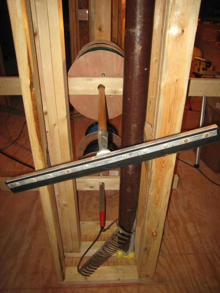

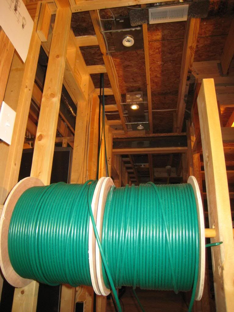

Here is a pic of my ghetto wire spool setup for my whole-home wiring. I made a simple "T" out of 2x10 and 2x6 for one side, attached a couple of boards to my column on the other side, drilled 1.5" holes in the appropriate spots and then loaded up the wire. Works great!
This is the main pathway up to the attic that I had to route through our home. It's a 3.25" hole all the way through and believe me when I say that it will be packed nearly full just for the second floor and attic wiring before I am done.
The handles for my dirt rake and squeegee worked fantastically for the wire spools. biggrin.gif All my other wood poles could only handle one wire spool.
