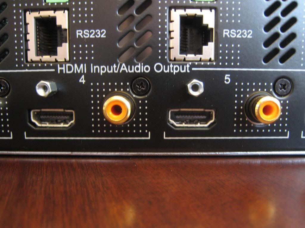

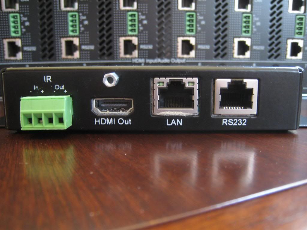

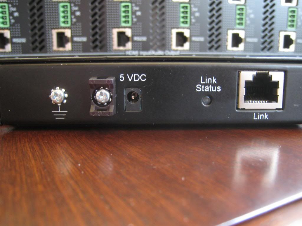

Small update. Over the summer I picked up on a deal for a Binary B-300 8x8 HDMI Matrix switch so I could distribute HDMI throughout my home from a common distribution point in my equipment rack. But I was able to pick up on Savant Systems' new 8x8 HDMI Matrix Switch, the SLN-88BT.
With this switch, there is one pretty significant downgrade and a couple of nice upgrades. The big downgrade is that both the category wire outputs and HDMI outputs for a given output are not active at the same time, so you have to pick either one or the other and you can't have an easy duplicate of the output signal. The Binary product had both outputs active. The advantages are that this switch will more easily integrate with the Savant Automation system (as you might have expected!), that the switching is the fastest in the industry, it uses broadcast quality components and uses HDBaseT technology to send the signals to remote locations. HDBaseT is a single-wire technology that can not only ship the full HDMI signal, but also network data, IR in/out, RS-232 and Audio Return channel for up to 1000 feet over a single wire at full 1080p/60fps with zero loss in signal quality. In other words, it's the cat's meow when it comes to HDMI signal transfer technologies. I also like that there is a coax digital output for each zone right beside the HDMI input, making it easy to loop the digital audio signal directly into a local receiver. And one last thing...the HDMI Matrix switch powers all of these devices directly via PoE, so no secondary power adapter at the display location is needed.
Front:
Rear:
Close-up of rear:
HDMI input with coax digital loop-through output:
The HDBaseT receiver:
