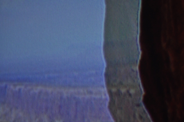

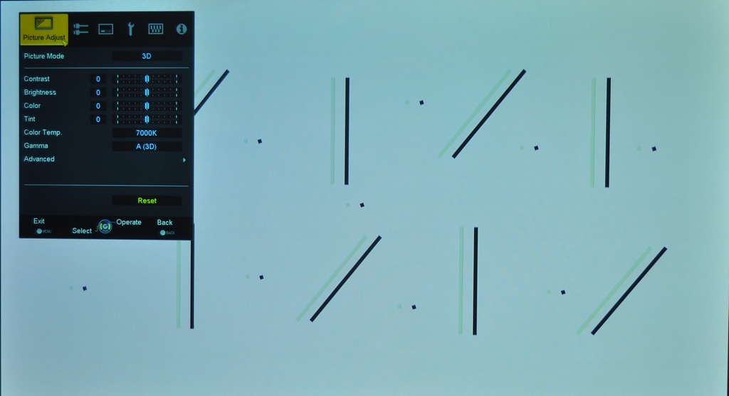

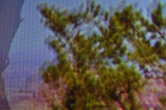

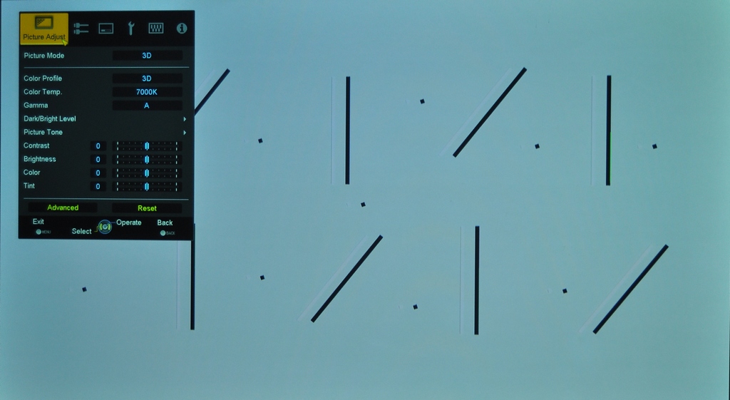

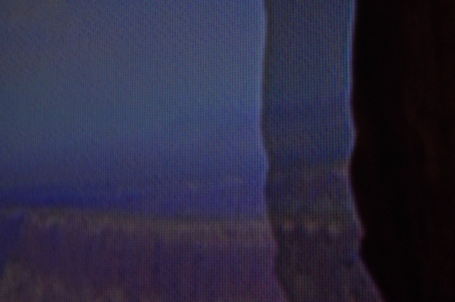

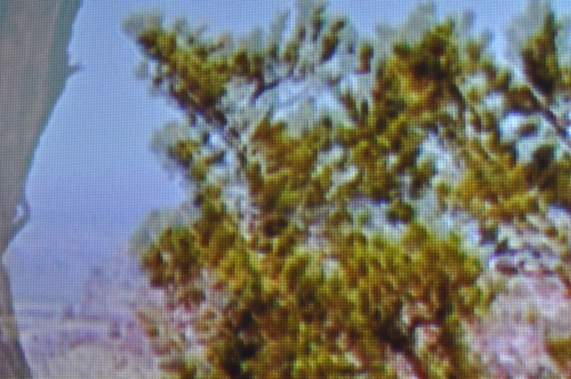

The trade off between the original firmware and post is a noticeable reduction in ghostings for reduced light output. Before the update, the 3D PQ is identical to the previous generations, where light on dark ghosting is obvious.. no need to freeze frame the image on tough scenes. It's been well discussed for the last 2 years.
The RS46 before the update was over 900 lumens in 3D. The RS4810 shipping firmware is ~600 lumens in 3D, same throw, all other settings the same.
The dark on light ghosting on the 2 previous generations manifests itself as the color tint you see in the first shot. This can become very distracting in 3D content - again, not just in still shots. The change in the firmware reduces this color shading by quite a bit as can be seen in ther 2nd screen shot. This change also caused a reduction in light output.
RS46 - prefirmware & identical to the RS40, RS45 as well
RS4810 - shipping firmware
The crosstalk has been reduced as well as light output and a bit of detail/sharpness in the background. The MPC settings in 3D mode on the 4810 can help restore some of the sharpness.
