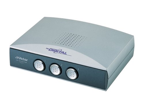

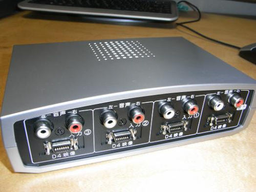

I was even trying to go lower tech than that. One of those non-powered ones with push buttons on the front.
Im in Japan and have just found some 2nd hand ones on yahoo auctions. Just trying to work how set up an account and bid.
They are 1/2 the price of amazon japan.
http://g-ec2.images-amazon.com/images/G/09/ciu/a0/e0/c15a31e29fa0c516e8235110.L.jpg
http://ec2.images-amazon.com/images/I/413AM488VJL.jpg
