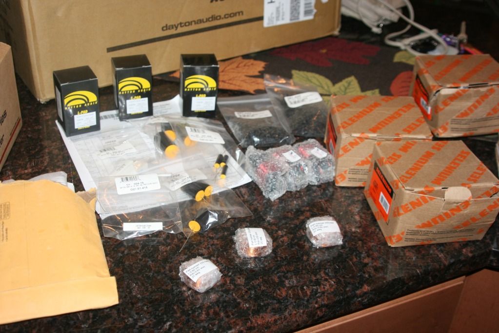

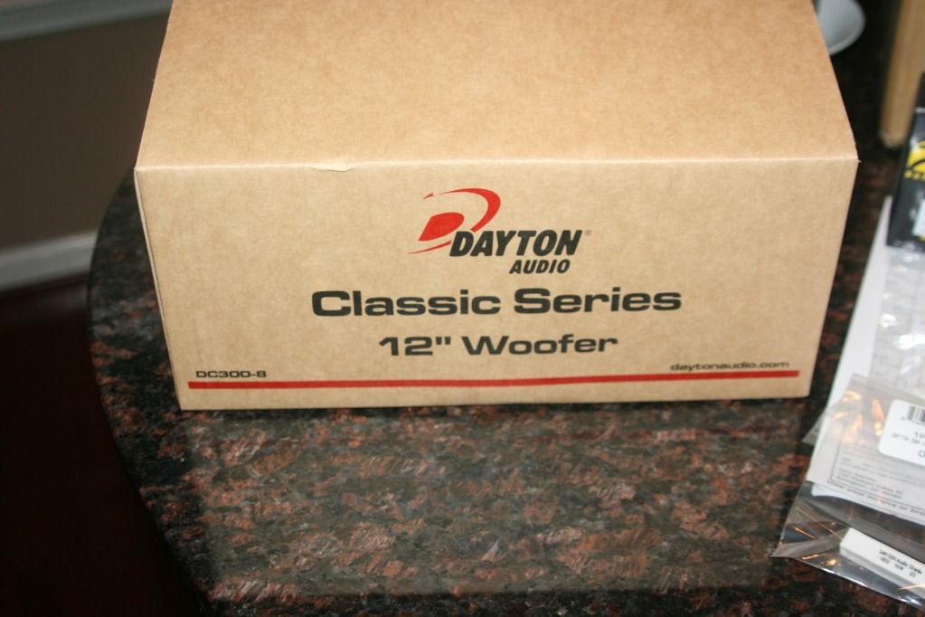

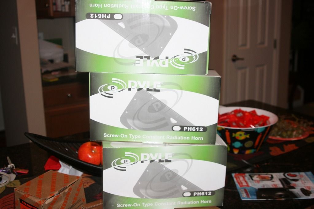

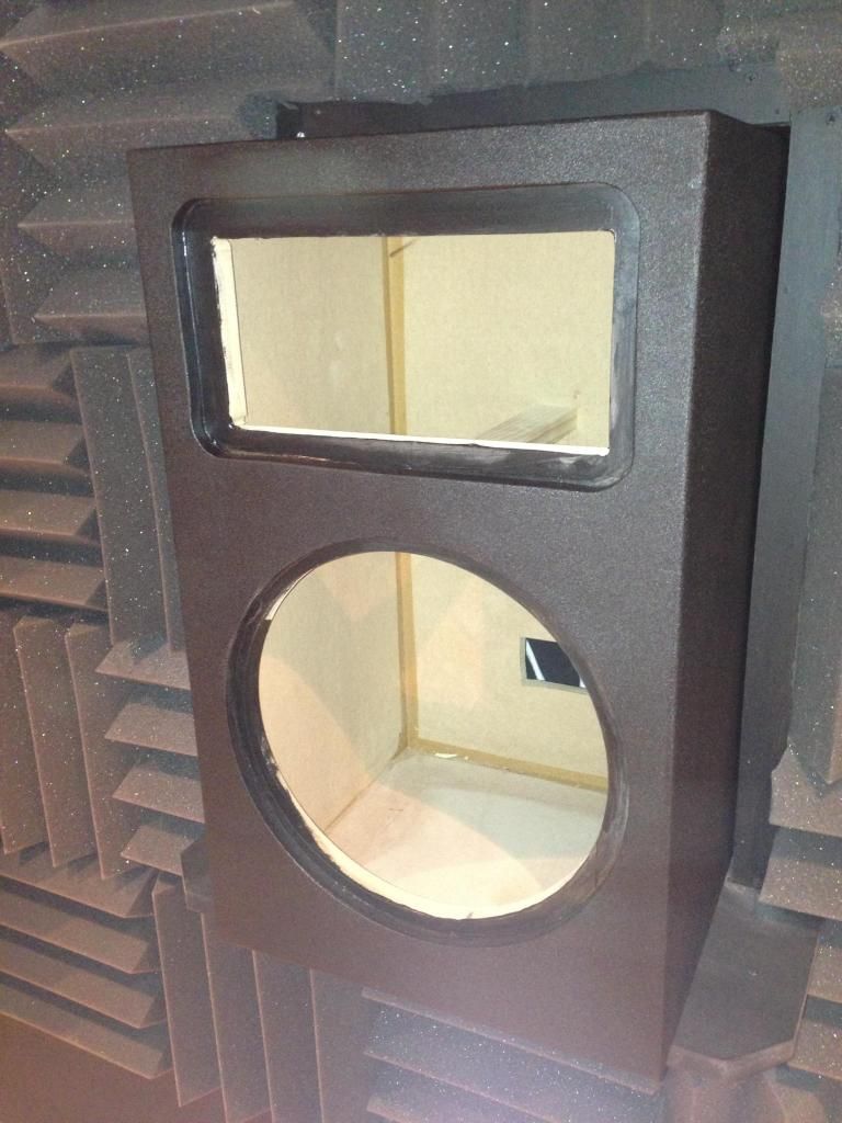

i decided to give these shot and with building a home theater they fit the budget.
they where build from MDF
i wanted them to have a nice recessed looked so the i used 3/4 mdf and also 1/2 mdf for the fronts
then all the parts for from parts express
i ordered duratex speaker box paint ... very happy with this product very easy to apply i used a foam roller to get a smoother finish instead of the rough finish you get with a nap roller
and the end result is very nice sounding speaker

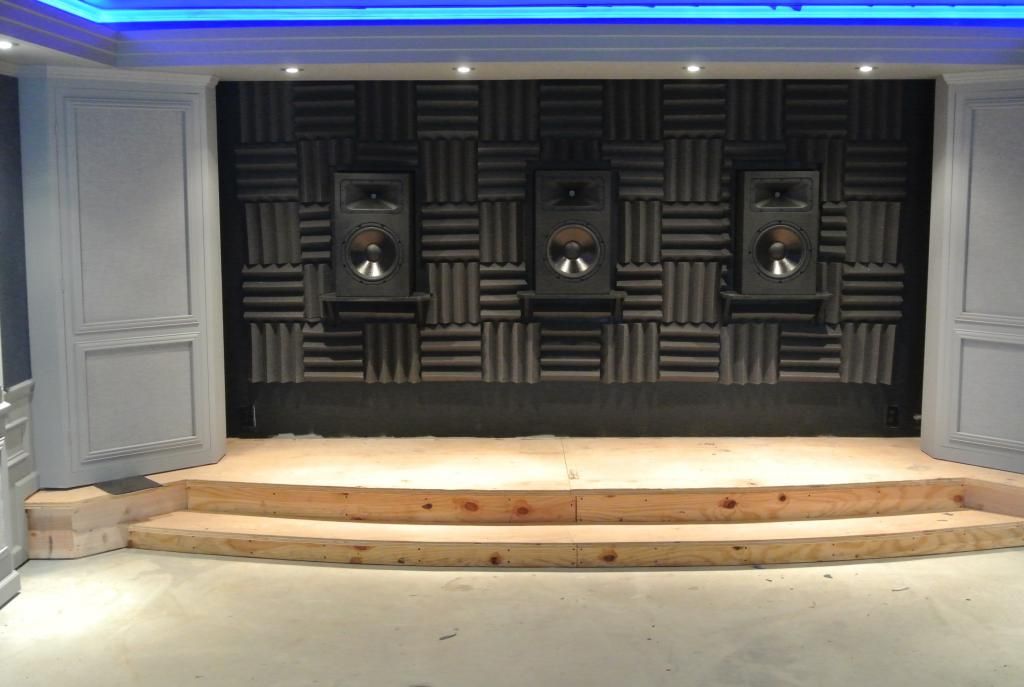

I don't know how wide your screen is but I would suggest moving the left and right speakers as far to the sides screen as you could then toe them in some. Benefits include a wider sweet spot and more even coverage across all the seating positions.
This article should provide some useful insight: http://libinst.com/PublicArticles/Setup%20of%20WG%20Speakers.pdf

Great looking home theater! Any plans for some subs in your room?
Also. agree with mtg90, you might get better imaging with a wider speaker layout across the front

120" screen will be about 2 inches past the speakers .... 120" i think is the max i go with front row of seats being 11.5 feet back

it is wired for two subs each will go in the corners cabinets on the stage ..... i will start with one sub first thou

Do you have dimensions for the speaker box that you made?
post #7 of 12
sure
h=22.4 x W=14.5 x D=13.0
