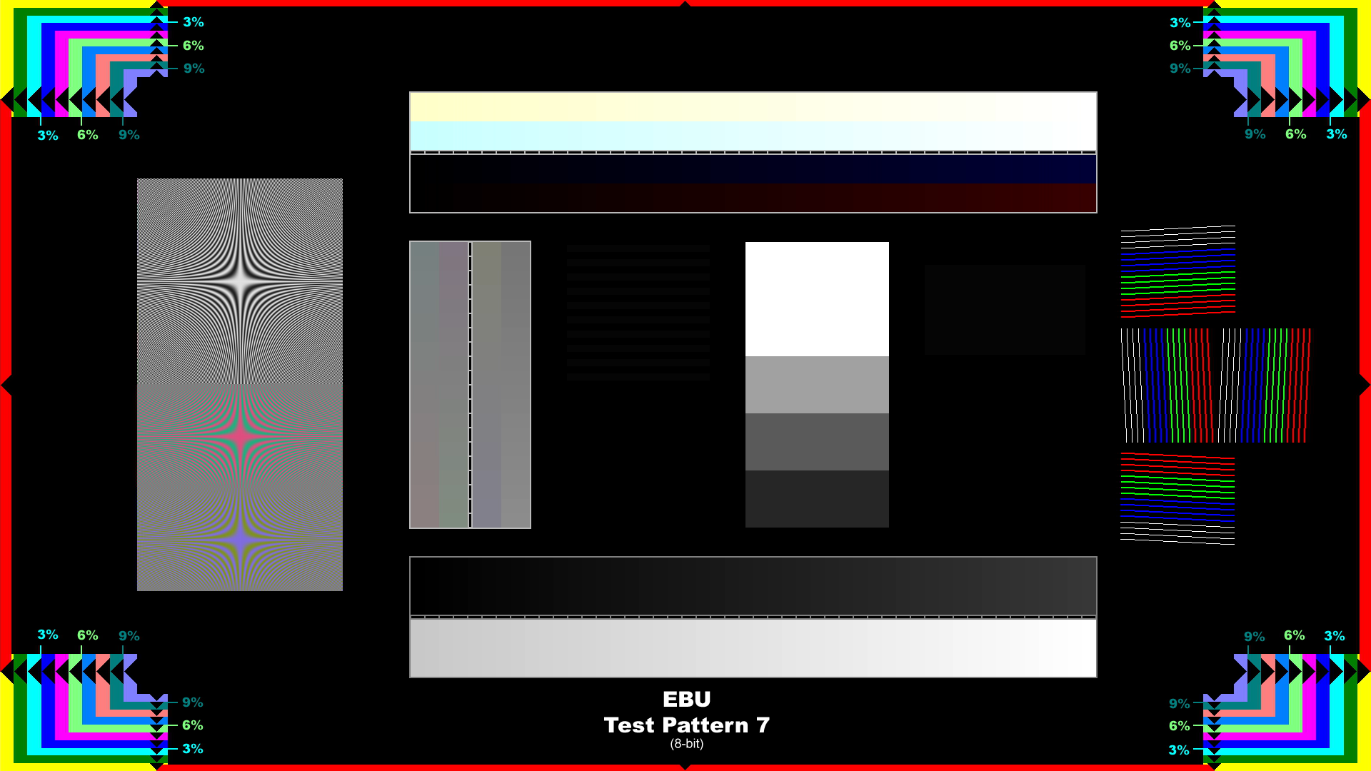

Here's a utility to convert yuv10 files to 8-bit bmp or tga files.
http://www.w6rz.net/yuv10torgb.zip
Code:
usage: yuv10torgb <-bv6> <horz> <vert> <infile> <outfile>
Defaults are tga file, 0 to 255 RGB and BT.709 matrix.
-b for bmp files
-v for video levels
-6 for BT.601 matrix
For example:
Ron

For others reading the thread, the patterns can be downloaded from:
http://tech.ebu.ch/docs/tech/tech3325_testpatterns.zip
The only interesting pattern is EBU_3325_1080_7.yuv10
The file format is interleaved 4:2:2 YUV (UYVY) with 10-bit samples in big-endian 16 bit words. This format could handle up to 16-bit YUV, and it's pretty much a waste of space for 10-bit YUV.
Ron

The pattern has below black and above white, so it's more interesting in video level RGB.
Ron
post #19 of 20
