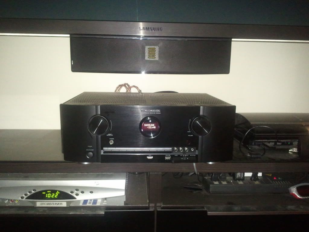

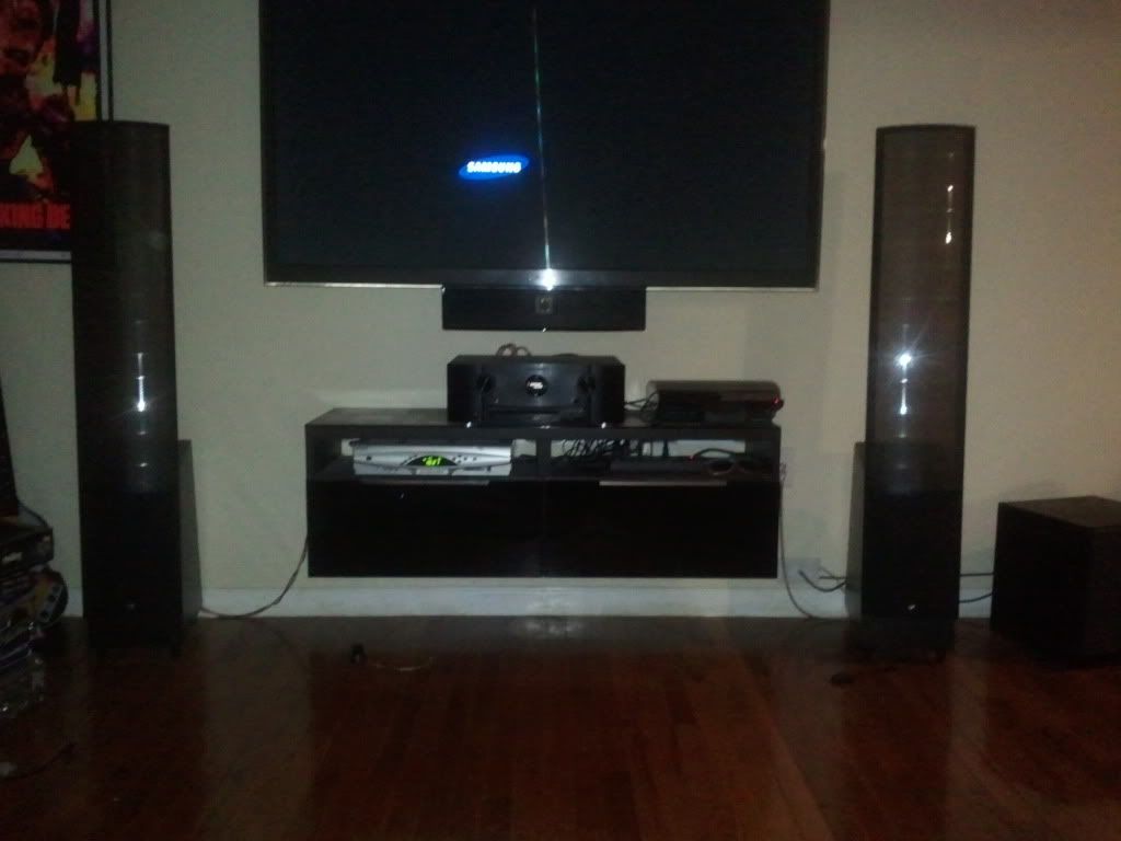

I have a Marantz SR6006 and for some reason it keeps over heating. It is not in an enclosed cabinet and is very well ventilated. I have the whole system wired with monster XPHP-CI In Wall Cable. I have 6 in ceiling Speakercraft AIM Wide Three's, 2 MartinLogan ElectroMotion ESL Hybrid Electrostatic Loudspeaker, 1 MartinLogan Motion 8 Center Channel Speaker, and a MartinLogan DYN500D Dynamo 500 Subwoofer. I had the system professionally installed so I know it was nothing I did wrong during the installation. The problem happens when I put the system loud while playing music, not even very loud +1db will make it overheat and turn off. It is embarrassing when having a party and everyone is dancing and than the system cuts off. If anyone can give me a suggestion on fixing this problem I would greatly appreciate it. Thank's in advance.
P.S. I included a picture so you guys can see it's not enclosed at all.

I fixed the pictures

Martin Logan's are very power hungry speakers. Sounds like you need an amp for them. To put it in perspective for you I have very power efficient klipsch speakers and I've never had to turn it any receiver above -15db to achieve volumes where I even questioned if I needed to listen it to it that loud lol
Sent from my iPad using Tapatalk HD
post #4 of 34
I asked specifically when I bought it, and also to the installer and they said the marantz could handle all my speakers in stride, but maybe i'll look into amp.
post #5 of 34
Yeah the speakercrafts are 91db rated for efficiency and the MLs electrostats I'd be shocked if they were over like 86 o.O they are generally super power hungry in my experience but so worth it if ya drive em right.
post #6 of 34
Hum 91db actually shocking. But I do know they've been know to drop close to 1ohm so again. Sounds like not enough power. Try disconnecting all the other speakers and just driving them in stereo and see what happens.
