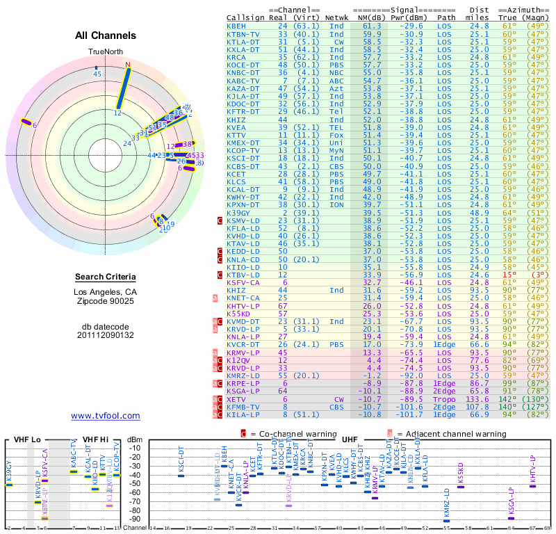

Mom lives in zip 90025 just west of Century City, watches broadcast TV including PBS, has west and south facing windows, and needs as adjustment-free of an antenna (omnidirectional?) as possible. I personally haven't had OTA TV for a long time, so I'm really out of touch.
What should I get for her?
Many thanks,
George
post #8449 of 9085
Originally Posted by keoki1 View Post
Mom lives in zip 90025 just west of Century City, watches broadcast TV including PBS, has west and south facing windows, and needs as adjustment-free of an antenna (omnidirectional?) as possible. I personally haven't had OTA TV for a long time, so I'm really out of touch...
George:
I see that no one has responded yet, so I will give you my 2 cents:
I just had installed a Channel Master CM-2016 HDTV (VHF-HI/UHF) antenna (Fry's - $34.95) on our house in the foothills of Sherman Oaks aimed directly towards Mt. Wilson (Just slightly north of west) and it does a beautiful job of picking up all of the OTA channels for Los Angeles.
http://www.frys.com/product/6345291?...H:MAIN_RSLT_PG
However the West and South facing windows are of little or no value. From just West of Century City, you will need a similar or better antenna aimed toward Mt. Wilson, which will be just slightly west of northwest. Check out TVFOOL.com with her address (this is the TVFOOL response for generic 90025):
http://www.tvfool.com/index.php?opti...id=13&Itemid=1

Great answer - thanks. Mostly I was concerned about the south and west windows, and you've confirmed that. Nobody mentioned it, but any straight shot in that direction also has the CC buildings right in the way. I've got to rethink this.
Again, thanks.
George
Originally Posted by MichaelLAX View Post
George:
...However the West and South facing windows are of little or no value. From just West of Century City, you will need a similar or better antenna aimed toward Mt. Wilson, which will be just slightly west of northwest. Check out TVFOOL.com with her address (this is the TVFOOL response for generic 90025):

keoki1, the TVFool report shows all the broadcasts coming from the northeast. An indoor antenna should work OK if she's not on the wrong side of an apartment building. The most often recommended model is the Terk HDTVi, but a simple loop-and-bunny ears antenna may be all that's needed.
post #8456 of 9085
