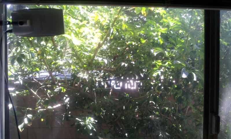

Yes, I'm back with this attempt again in the new 90631/La Habra Heights' house but I have good news? I pretty much gave up, but my father/dad/pa was willing to try another antenna. So he agreed to try that huge and heavy ChannelMaster/CM 4228HD from the local Fry's Electronics store. I didn't help to set up and test this time though since I was too BUSY with computer job/work, other things, and didn't care anymore since my folks refused to put the frakkin' antenna on the roof.
Amazingly, it worked very well! The portable HDTV found about 111 channels including analog and radio ones (12-0, 21-0, 27-0, 30-100 (Airbox), 30-101 (Starz), 30-200 (NFL), 30-209 (GoITV), 30-300 (Telefor), 30-301 (CineMax), 30-302 (Pasions), and 57-0. Weird! Also, this was on a wooden paint canvas as a temporary holder in the house's kitchen facing the small mountain/giant hills blocking Mount/Mt. Wilson's transmitters views! However, KCBS2 was still iffy/not perfect again.
Oh he also had to buy a cheap Winegard Flatwave antenna. Ugh!!! Obviously, it didn't work well. :P I am just more surprised that CM 4228HD worked well.
However, I am still suspicious. That RCA antenna worked well at work first too even in the attic. Then, it went to crap until I tried it in the kitchen and outside in the front of the house. I really wished they would put one of them on the roof already! No way they would leave that huge thing in the kitchen facing the patio window to the north. LOL!
If it wasn't done, you should be aiming the CM4228 at the top of the small mountain/giant hill, not horizontally but tilted back, for best reception.
The 30-100, -101, -200,-209, -300, -301, -302 etc are meant for paid subscribers, not for us OTA people.
Oops, I missed your reply!
The painting canvas holder was already tilted (10? degrees tilted back) at an angular facing back a little as if it was holding a painting. wink.gif How far back should it be tilted? 45 degrees?
http://zimage.com/~ant/MiCasa2/FrontOfHouseGarageFacingNW333degreesOnCompass1.JPG and http://zimage.com/~ant/MiCasa2/FrontOfHouseGarageFacingNW333degreesOnCompass2.JPG of what the front looks like on ground level outside facing Mt. Wilson's direction according to the compass and tests with antennae. Speaking of photographs/photos., I added a few more into http://zimage.com/~ant/MiCasa2/ with illustrations.
Edited by phildaant - 6/22/12 at 11:54pm
post #8845 of 9442
45 degrees is way too much. Start with 10 degrees then, while watching the TVs signal quality, try different tilt backs for best signal quality. Also experiment with different azimuth angles to see if that makes any difference.

OK and thanks. We might try again tomorrow. So any other tips to try, then please let me know by then.
FYI, the portable ATSC DTV doesn't have a signal measurement for the OTA feed. It is either viewable, no signal, or unstable feed. Zeinth converter box has a real-time signal feed (updated every few seconds) with the small CRT TV, however it is not that portable due its size, weight, and requires a power outlet.

OK, I am back again. Today's early afternoon hours were rough and somewhat disappointing. frown.gif I think today's soft winds were messing up my OTA feeds there. I can't imagine was hard winds would do! I also don't remember any winds on Wednesday night.
With that new CM 4228HD antenna outside on the non-slope patio in front of the kitchen window instead of the slope grass I did with RCA ANT751 antenna almost a couple months ago, I got scanned channels from over 80 to 104 channels in the same area. I tried tilting a little back/front, changing angles a little, etc. Also, this was about 5' (CM 4228HD's center where the coax cable connector is) above the ground like my height. Note that the garage's left wall, AC unit, cement patio, low wall, and low metal gate door were still around it even far. I wanted to try it on the slope grass area, but the wooden easel (finally figured out what those art painting canvas holders were called) would be unable to hold the heavy and big CM 4228HD antenna (I had a hard time lifting both items separately due to my disabilities and height!). From what I saw, I had some issues with KCBS2, KTLA5, KCAL9, etc. Nuts. Just for kicks, I went to the grass slope front lawn to try RCA ANT751 antenna over my head (5') again and noticed less channels. What the frak? frown.gif
Also, my father/dad/pa was willing to put an antenna outside in front of the kitchen outside mounted under the roof. Ugh! NO! This will not work well because I tested this already by myself with RCA ANT751 antenna near the walls, AC unit, wall, etc.! The best spot is in the open area like above the tiled brick roof! We got into a verbal fight too. He said it is too dangerous up there. Well, get someone who can then even though I could search for someone! Argh!! I gave up and let him try it in the wall corner adjacent to the garage and kitchen's sink window sides. It didn't get all the channels we wanted, and some were unstable. Well, DUH! I knew that already from my previous tests! It looks like he will get a very long coax cable (25'?), from a local Radio Shack store, to connect from the attic with previous owners' coax cable setups with his Dish service, to the front to this mounted antenna (most likely RCA ANT751). frown.gif
Also, I finally took my old 2005's DB2 bowtie antenna. Amazingly, it didn't too bad. It got many channels we wanted, but some were not receivable and stable (e.g., KCET28). I'd rank this one under RCA 751 antenna. This was in the outside corner spot and in the kitchen as well.
Oh another bad day was he dropped the portable DTV. It still mostly works, but the channel+ button (next channel) is busted (mostly doesn't respond OR thinks it wants to rescan for channels which is the right button). Also, he got a big leg cut on the short ladder from the shrubs when fiddling with an antenna on the corner near AC unit, garage, and kitchen sink's window. He also said he is going to return that huge CM antenna to Fry's Electronics (hope they don't ban him like Best Buy did to that one guy a few months ago) too. Um, he was the one who wanted to try it even though I was surprised by its feed results! [sighs] frown.gif

Not sure where you are; don't see an image posted, but in any event here is MY experience. You said LOS Mt. Wilson, but not the distance...
Rented out guest house in Sherman Oaks 1 mile southwest of intersection of Van Nuys Blvd and Ventura Blvd. Put up a Winegard digital HDTV antenna ($35 Frys) which is both UHF and VHF on the side of the 2nd story of the guest house aimed directly to Mt. Wilson (used to be line of sight until a neighbor rebuild two stories).
Now Tenant gets all of the applicable Mt. Wilson channels, including ABC. Tenant has DirecTV with AM-21 OTA tuner connected (not the hottest front end compared to connecting an antenna directly to ATSC HDTV's).
Your mileage may differ...
Line of Sight, 27-28 miles both TV Fool, Antenna Web and FCC.
Now I was experimenting with this location. When I turn it side ways, I pick up 7.1 which is the strongest Hi-VHF signal. I also get 9.1 (KCAL) however the signal is weak and I can't even get partial audio. Still no 11 or 13...
So the problem used to not be location, but now it is. Turning it sideways is not practical since I need to close my blinds... Also turning it sideways didn't get 11 and 13 as I mentioned and is weak on 9.1 while pulling 7.1, 7.2 and 7.3 solidly in that position.
Putting it outside is not practical either, here's why. We have DirecTV HD and that's KA band, I would need a b-band converter because myself and my father are the only ones connected too it, so no multi-switch required.
Converter cost $150, (2) Diplexers are $16 each.... No budget for that.
My conclusion is that this directional antenna and the one I ordered (but have to cancel in the morning) from Monoprice is the same type, "highly directional" won't solve the problem.
I need an Omni-directional design. I may experiment with one the $30 RCA 1450R usually found around town (Best Buy, Fry's, Walmart, Target, Home Depot, Lowe's, Sears,....) Mounting it high and near the windows may get all the channels I need. I still think a the Winegard or Mahu Leaf will get the job done as well, window mounted but still omni-directional to get the channels off -axis from the directional antenna.

The Leaf will tend to receive VHF edge-on rather than broadside. You definitely DON'T want an omni antenna, they're simply an invitation to more trouble. Trying to put a square peg in a round hole doesn't work very well. Use the right antenna and it's like putting the square peg in the square hole and the round peg in the round hole.
For the VHF reception, try a simple set of rabbit ears extended to 28-34 inches placed so the dipoles are horizontal and broadside to the direction towards Mt Wilson. Once you find a suitable location, use a UVSJ to combine it with the Leaf which will be used for UHF only.
Be advised that for Directv systems with a 5-LNB dish, you generally CANNOT diplex an antenna signal onto those cables.
None of the Monoprice antennas are particularly well matched to the Los Angeles market. You'd do best with a small 7-51 antenna whether indoors or outdoors.
Edited by ProjectSHO89 - 6/25/12 at 5:36am
